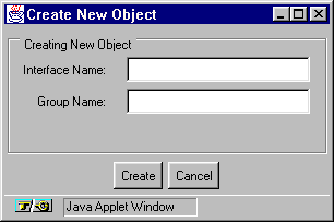

Adding New Administrative Objects
To create any new administrative object, use the following general procedure:
1.
2.
Figure 3‑3 Quick Menu on a Device
Figure 3‑4 Quick Menu on a CORBA Interfaces Class Object
The Create New Object window is displayed as shown in Figure 3‑5, prompting you for the identifying attributes needed to establish a new device object, or as shown in Figure 3‑6, prompting you to establish a CORBA interface class object.
Figure 3‑5 Create New Object Window for a Device
Figure 3‑6 Create New Object Window for the CORBA Interfaces Class Object
3.
The new object appears in the tree contained under the folder you selected originally. (Or, at the same level as whatever non-folder object you selected originally.) The new object automatically includes empty folders of the appropriate subclasses in which you can create new member objects if needed.
Table 3‑2 lists topics that give detailed information on how to fill in the fields on the Create New Object window for a specific type of object.

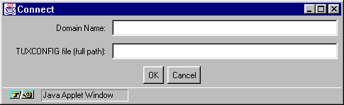

Connecting to and Disconnecting from a Domain
There are a number of operations that you can perform only when you are connected to a domain. These include:
How to Connect to a Domain
You have two options for connecting to an existing domain.
To connect to a domain listed on the menu bar Domain list, select Domain—>Domain Name.
To open a domain not on the list:
1.
The Connect window is displayed as shown in Figure 3‑8.
Figure 3‑8 Connect Window
2.
3.
If the connection is successful, the Tree View displays the domain icon and name, and the Configuration Tool tab pages display information about the domain.

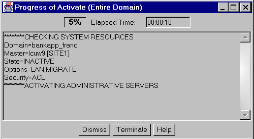

How to Monitor the Progress of Activate
As objects are activated, the Progress of Activate window is displayed (as shown in Figure 3‑11). The Progress of Activate window tracks the status of the activation process as it occurs. You can:
If you do not want to view the Progress of Activate window during the activation process, click Dismiss to close the window. The activation process continues in the background.
Figure 3‑11 Progress of Activate Window

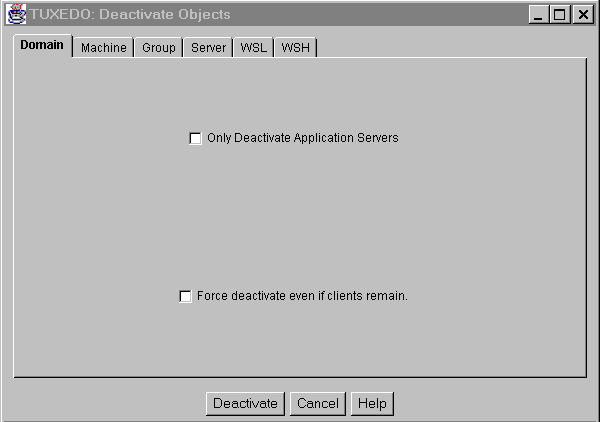

How to Deactivate a Domain
To deactivate a domain:
1.
The Oracle Tuxedo Administration Console displays the Deactivate Objects window. Click the Domain tab to display the Domain information as shown in Figure 3‑12.
Figure 3‑12 Deactivate Domain Tab Page
The Domain tab page contains the following options:
To select either of these options, click the check boxes. (A check mark indicates the associated action will be performed as a part of the deactivation).
2.
The Oracle Tuxedo Administration Console displays the Progress of Deactivate window. For more information about this window, see How to Monitor the Progress of Deactivate.

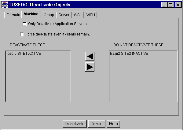

How to Deactivate Class Objects
To deactivate class objects:
1.
The Oracle Tuxedo Administration Console displays the Deactivate Objects window containing a set of class-specific tab pages (see Figure 3‑13). Click a tab to display the page for the type of object you want to deactivate.
The Deactivate Objects window contains six tab pages as shown in the following table.
2.
As shown in Figure 3‑13, all Deactivate class objects tab pages include the following list boxes:
All objects shown indicate their current state next to the object name.
Figure 3‑13 Deactivate Objects Window
Move the object(s) you want to deactivate into the DEACTIVATE THESE list and all other objects into the DO NOT DEACTIVATE THESE list. (To move an object from one list (or column) to another, highlight the object name and click one of the arrow buttons between the two columns as shown in Table 3‑5.)
The Machine tab page also contains options to:
3.
To start the deactivate process for the objects on a particular tab, click Deactivate.

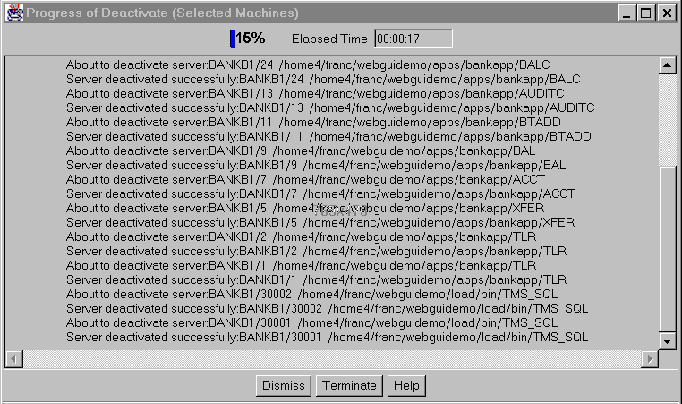

As objects are deactivated, the Progress of Deactivate window is displayed (as shown in Figure 3‑14). The Progress of Deactivate window tracks the status of the deactivation process as it occurs. You can:
If you do not want to view the Progress of Deactivate window during the deactivation process, click Dismiss to close the window. The deactivation process continues in the background.
Figure 3‑14 Progress of Deactivate Window

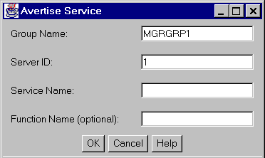

Advertise a Service
To advertise a service (either from an existing service or from a service default object), complete the following steps:
1.
2.
The Advertise Service window is displayed as shown in Figure 3‑15.
Figure 3‑15 Advertise Service Window
3.
4.
5.
A confirmation message is displayed indicating whether the Advertise operation was successful or not.

Creating ACL Groups
To create new ACL Groups, display the Create New Object form and enter values for the fields:
1.
The Create New Object window is displayed.
2.
3.
(Or click Cancel to close the window without creating a new group.)

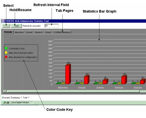

Displaying the Statistics Tool Window
The Statistics Tool window provides statistics for domains, machines, servers, services, and clients. To display the Statistics Tool window, select Tools —>Stats from the menu bar or click the Stats toolbar button. The Oracle Tuxedo Administration Console displays the Statistics Tool window as shown in Figure 3‑16.
The Statistics Tool displays the domain tab pages by default. You can click a tab to view the statistics for any of the other listed administrative class objects. The domain tab displays statistics for the following administrative classes in a domain:
Figure 3‑16 Statistics Tool window
Table 3‑11 lists the parts of the Statistics Tool window.

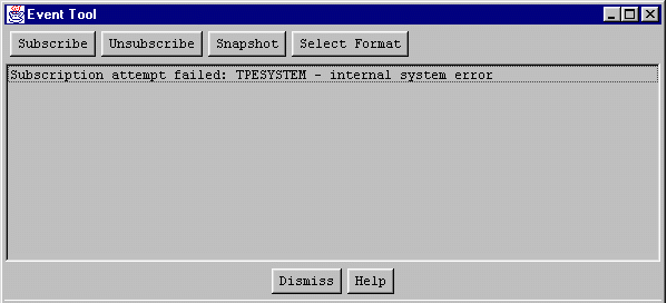

Viewing System Events
If the system event broker server (TMSYSEVT) is configured, you can use the Oracle Tuxedo Administration Console to monitor system-generated events.
To view system events via the Event Tool:
1.
Figure 3‑17 Sample Initial Event Tool Window
The menu bar across the top of this window offers four options as shown in Table 3‑12.
Table 3‑12 Options
2.
Figure 3‑18 Event Tool Format Options Window
3.
4.

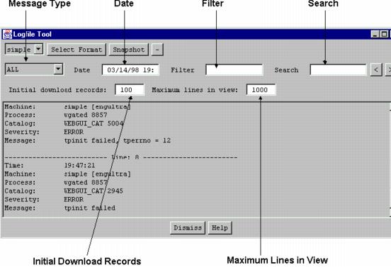

Viewing a ULOG File
Using the Oracle Tuxedo Administration Console, you can view the ULOG file from a selected machine in the active domain. You use the Logfile Tool window to display a ULOG file.

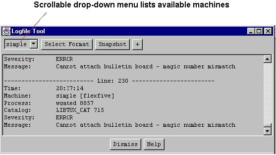

Displaying the Logfile Tool Window
To display the Logfile Tool window, select Tools —>Logfile from the menu bar or click the Logfile toolbar button. The Logfile button displays the ULOG file from a particular machine in the active domain.
The Logfile Tool window is shown in Figure 3‑19. The Logfile Tool initially displays a blank viewing area, a drop-down list box and several buttons. The following table describes the Logfile Tool window components.
Selecting a Machine to View its ULOG File
To view a ULOG file for a specific object, select a machine from the drop-down menu in the top left corner of the window. (To display the menu, press and hold the left mouse button on the down arrow. To select a menu item, drag the cursor to highlight a menu item and release the the mouse button.) As shown in Figure 3‑19, the Logfile Tool displays the ULOG file for the selected machine.
Figure 3‑19 Sample ULOG File in Logfile Tool Window
Taking a Snapshot of the ULOG File
To save a record of the displayed ULOG file, click Snapshot on the Logfile Tool window.
Setting the Format for the ULOG file
To modify the format of the ULOG display:
1.
The Logfile Format window is displayed, as shown in Figure 3‑20.
Figure 3‑20 Logfile Format OptionsWindow
2.
3.
Customizing the Logfile Tool Options
As shown in Figure 3‑21, the Logfile Tool provides additional options. When you first invoke the Logfile Tool only a single row of buttons appears in the upper left corner of the Logfile Tool window. To display the additional Logfile Tool options, click the + sign button. The six fields that are then displayed allow you to select a ULOG file and specify which parts of it you want to see.
Table 3‑13 shows how to customize the logfile tool options.
Specify the date of the ULOG file you want to view. By default, the ULOG file for the current day (on the server) is displayed.
Look for a particular record (in the portion of the ULOG file that you are viewing) by matching a string that appears in that record. Enter the string to be matched in this field.
Figure 3‑21 Logfile Tool with All Options Displayed
