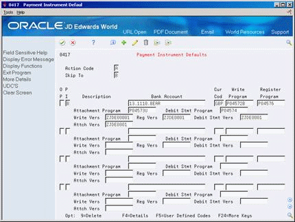

A Payment Instrument code of B is the default payment instrument for BACS payment processing. Verify the following programs and DREAM Writer versions exist in the Payment Instrument Defaults program (P0417), as they are required during the BACS payment processes:
Write Program - P04572B
Register Program - P04576T
Attachment Program - P04573U
Debit Statement Program - P04574
From Accounts Payable (G04), enter 29
From Accounts Payable Setup (G0441), choose Automatic Payment Setup
From Automatic Payment Setup (G04411) choose Payment Instrument Defaults
Figure 34-2 Payment Instrument Defaults screen

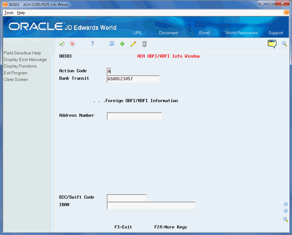

To set up IAT, you attach ACH ODFI/RDFI bank information to the bank account using the ACH ODFI/RDFI Info Window (P0030).

Alternatively, you can access Bank Account Address (P00302) from the Bank Accounts by Address program (P0030) by choosing Exit to Bank Transit Number (F8).
On Bank Account Information, choose Exit to Bank Account Addresses (F8).
On Bank Account Address, choose ODFI/RDFI Bank Information (F8).
On ACH ODFI/RDFI Info Window, complete the following fields and click Add:
Address Number
BIC/Swift Code
IBAN
Figure 34-4 ACH ODFI/RDFI Information WIndow
Continue clicking Exit to access the menu.
| Field | Explanation |
| BIC/Swift Code | The Society for Worldwide Interbank Financial Telecommunications (SWIFT) code, also known as BIC, is an international banking identification code used to identify the origin and destination of electronic (or wire) financial transfers. This is the BIC code of the beneficiary's bank. This code is similar to the Routing Number in the United States.
BIC can be 8 characters or 11 characters and consists of the following elements: 4 characters for the bank code 2 characters for the country code 2 characters for the location code 3 characters for the branch code (optional) |
| IBAN | The International Bank Account Number or IBAN as it is commonly called, is a series of alphanumeric characters that uniquely identifies a customer's account held at a bank anywhere in the world. The IBAN has a maximum of 34 alphanumeric characters:
The first two alphabetic characters identify the country in which the account is held. The next two digits are the check digits. They validate the complete IBAN. The final part of the IBAN is the domestic account number, which in most cases consists of the account number itself, the number that identifies the bank and the branch, and one or more check digits. For some countries an extra bank identifier is included. |
