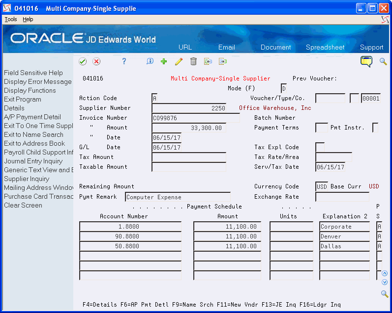

To enter a voucher for multiple companies
On Multi Company-Single Supplier
Figure 23-3 Multi Company-Single Supplier screen
The steps are the same as entering a standard voucher, except there is no company number field on the form.
