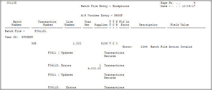

86.2 Verifying Batch Voucher Information
When the system cannot process a batch voucher, it lists the voucher on an exceptions report. Use this report to detect the errors and verify batch voucher information.
The system produces this report in proof mode, prior to final processing.
Figure 86-1 Batch File Entry - Exceptions report
Description of Figure 86-1 follows
Description of "Figure 86-1 Batch File Entry - Exceptions report"
In the example above, the invalid batch action shows that the transaction code has been changed to C. This code should always be A.
