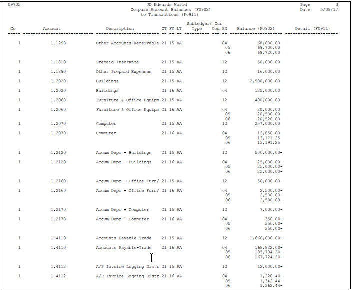

To assist you in locating damaged data that causes an out-of-balance condition in your system, you can run the Account Balance to Transaction Integrity Report (P09705).
This report:
  • Compares Account Balance (F0902) transactions to supporting Account Ledger (F0911) transactions and identifies those amounts that do not have supporting Account Ledger detail.
  • Prints out-of-balance conditions only and does not perform any updates.
It is similar to the report only version of the Repost Account Ledger program, but instead of comparing Account Ledger (F0911) transactions to the Account Balance (F0902) file it starts with the Account Balance (F0902) and compares this to the posted transactions in the Account Ledger (F0911) file.

Figure 15-2 Compare Account Balances (F0902) to Transactions (F0911) report
Description of Figure 15-2 follows
Description of "Figure 15-2 Compare Account Balances (F0902) to Transactions (F0911) report"
