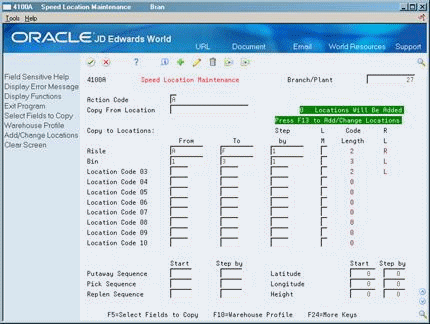

Example 2: Speed Location Maintenance Using Upper Limit Method
Assume the following values on Speed Location Maintenance:
From aisle A, bin 1
To aisle B, bin 3
Step by 1
Limit of 1
Figure 40-2 Speed Location Maintenance screen (upper limit)
The system creates the following new locations:
A1
A2
A3
B1
B2
B3

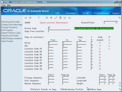

Example 4: Speed Location Maintenance Using No Limit Method
From aisle B, bin 6
To aisle D, bin 8
Step by 1
Limit of 3
Figure 40-4 Speed Location Maintenance screen (no limit)
B6 through B9
C1 through C9
D1 through D8
