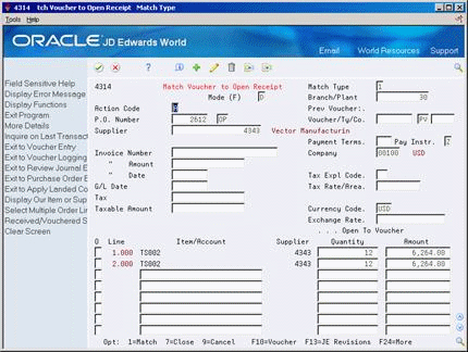

To choose receipt records to match to an invoice
On Match Voucher to Open Receipt (P4314)
Figure 19-1 Match Voucher to Open Receipt screen
Complete the following fields:
Match Type
Branch/Plant
To locate receipt records or purchase order detail lines for a specific purchase order, complete the P.O. Number field and press Enter.
To locate receipt records or purchase order detail lines for a specific supplier, complete the Supplier field and press Enter.
To enter invoice information, complete the following fields:
Invoice Number
Invoice Amount
Date
G/L Date
Tax
Taxable Amount
Do not press Enter.
You can have the system enter the amount, tax, and taxable amount based on the receipt records you choose to match to the invoice.
To increase or decrease quantities or amounts, modify the following fields:
Open to Voucher Quantity
Open to Voucher Amount
If you are working with receipt records, you cannot increase the quantity to reflect an invoice. You must first receive the additional quantity from the Enter Receipts program. If you increase the amount for a receipt record, the system creates journal entries to account for the variance.
To choose the lines you want to match, complete the following field and press Enter:
(O) Option
Press F9 to repopulate the video with the prior transaction.
Press F10 to access Voucher Entry (P04105) to review the resulting voucher.
