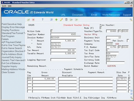

In Standard Voucher Entry (P04105)
Figure 24-1 Standard Voucher Entry screen
Complete the following fields with the same information that was on the original voucher:
Voucher number (DOC)
Voucher Document Type (DCTV)
Voucher Document Company (CO)
Supplier Number (AN8)
Invoice number (VINV)
G/L Date (DGJ)
Company number (CO)
Tax Explanation Code (EXR2)
Tax Rate/Area (TXA2)
Taxable amount (ATXA)
Gross Amount (AG)
You must enter at least one pay item on the voucher with a gross amount equal to the original invoice amount.
Press Enter to re-create the voucher.
The A/P Journal Entries video (P03101) will display, prompting you to add back the journal entries. You only need add back one journal entry that corresponds to the gross amount on the invoice.
