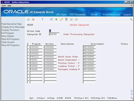

To define the subsystem
On Define Subsystem (P40105)
Figure 72-1 Define Subsystem screen
Description of Figure 72-1 follows
Description of "Figure 72-1 Define Subsystem screen"
For each program you want to run through the subsystem, complete the following fields:
  • Version
  • Environment
Field Explanation
Version The version of the DREAM Writer the system uses to process information through the corresponding program.
Environment The name associated with a specific list of libraries. The J98INITA initial program uses these library list names to control environments that a user can sign on to. These configurations of library lists are maintained in the Library List Master table (F0094).
72.2.1 What You Should Know About
Topic Description
Displaying specific subsystems The Define Subsystem form displays subsystem information about the subsystem you specified in the processing options. If you did not specify a subsystem, or if you want to display a different subsystem, enter the subsystem name in the Subsystem ID field.

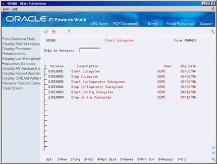

To start jobs in the subsystem
On Start Subsystem (P90300)
Figure 72-2 Start Subsystem screen
Description of Figure 72-2 follows
Description of "Figure 72-2 Start Subsystem screen"
For each job you want to start, enter 1 in the following field:
  • Option
The status field displays *ACTIVE for each program you start.
72.3.1 What You Should Know About
Topic Description
Starting all jobs in the subsystem You can start all jobs in the subsystem by:
  • Pressing F6 from Define Subsystem (P40105)
  • Running the Start Subsystem program (P40420) accessible from the menu.
