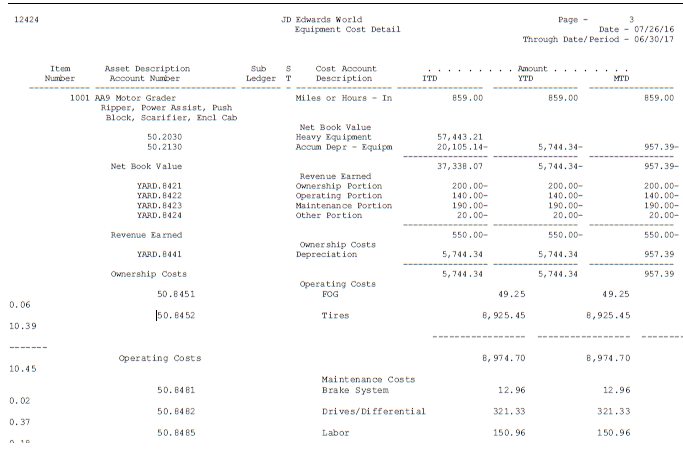

Print the Equipment Cost Analysis report to review a printed version of the Cost Summary by Cost Account screen. The report shows all the costs and expenses for a piece of equipment, such as acquisition costs, depreciation amounts, revenue and expense amounts, and so on. You can review equipment costs on an inception-to-date, year-to-date, and month-to-date basis.
Use the Units Selection processing option to indicate whether to print units such as hours, miles, or fuel. You determine the units for each piece of equipment when you enter meter information. You can review the total units accumulated for a piece of equipment as well as the per unit cost for each account. The system calculates per unit costs by dividing account balances by total accumulated units. You can review these costs on an inception-to-date, year-to-date, and month-to-date basis.

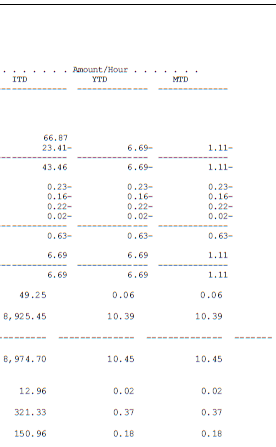

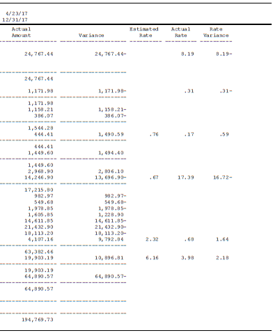

Figure 28-1 Equipment Cost Detail report, part 1
Figure 28-2 Equipment Cost Detail report, part 2

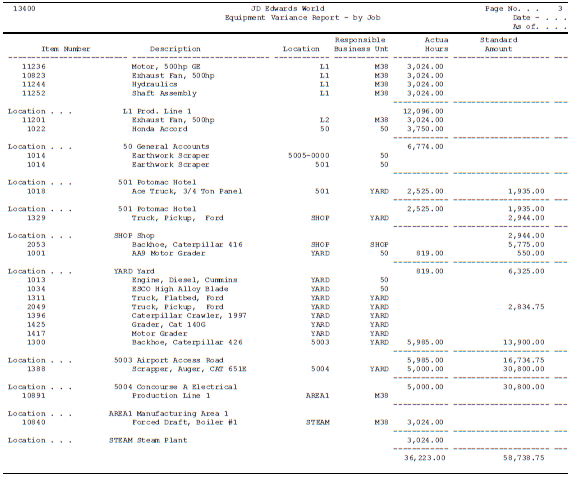

Figure 28-3 Equipment Variance Report by Job
Figure 28-4 Equipment Variance Report by Job, right side

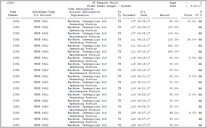

Figure 28-5 Fixed Asset Ledger - Posted report
