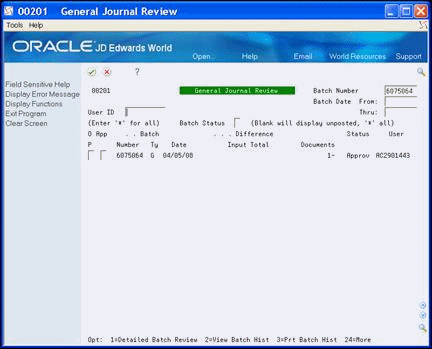

49.1.6 Review and Approve the Journal Entry
After you run Provision for Final Cost, you need to review and approve the journal entry. You can review the debit and credits and add additional detail lines to the journal entry if necessary using the Journal Entry program.
Navigation
From Homebuilder Management (G44H), choose Closing/Revenue Processing
From Homebuilder Accounting Entries (G44H16), choose General Journal Review
To review and approve the journal entry
  1. On General Journal Review, complete one of the following fields and click Enter.
    • Batch Number
    • User ID
    Figure 49-3 General Journal Review (Review and Approve) screen
    Description of Figure 49-3 follows
    Description of "Figure 49-3 General Journal Review (Review and Approve) screen"
  2. Enter A in the Approved (App) field and click Enter.
    Approved displays in the Status field for the batch and indicates the batch is ready to be posted.
    Note the batch number to use when you post the batch.
  3. To review the details of the batch, enter 1 in the Option field and click Enter.

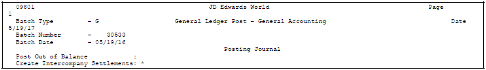

49.1.7 Post the Batch
When you run the Post Voucher to G/L program, the system produces a report, which you should review to ensure the batch posted successfully and determine if there are errors that you need to correct.

49.1.9 General Ledger Post
Figure 49-4 General Ledger Post report (1 of 2)

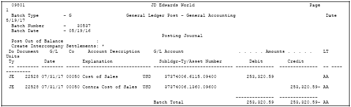

49.2 Working with Cost of Sales Journal Entry
You use the Cost of Sales program to create the cost of sales journal entry. This program matches the expenses with revenue. It credits the work in progress account and debits the expense account. After you run this program, note the journal entry number for the lot in the header of the report or in the Cost Doc# field on the Lot Proceed Inquiry screen.

49.2.8 General Ledger Post
Figure 49-7 General Ledger Post report
Description of Figure 49-7 follows
Description of "Figure 49-7 General Ledger Post report"
