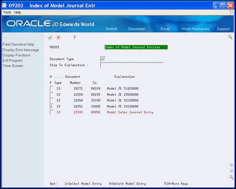

On Index of Model Journal Entries, enter SJ in the Document Type field and click Enter.
Figure 47-1 Index of Model Journal Entries screen
A list of model sales journal entries displays.
Enter 1 in the Option field to select a model sales journal entry and click Enter.

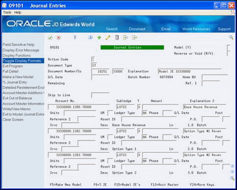

The Journal Entry screen displays with the model journal entries.

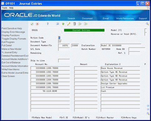

Choose More Details (F4) to access the detail area.
Figure 47-3 Journal Entries (Detail) screen

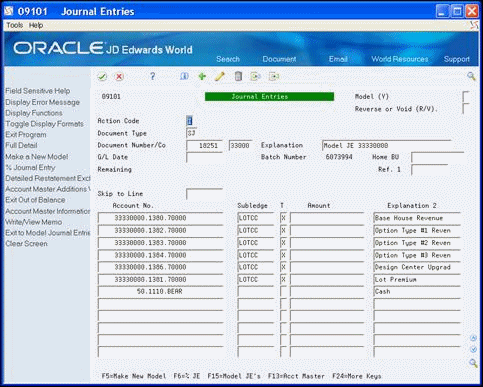

Choose Toggle Display Formats (F2).
Figure 47-4 Journal Entries (Display Formats) screen

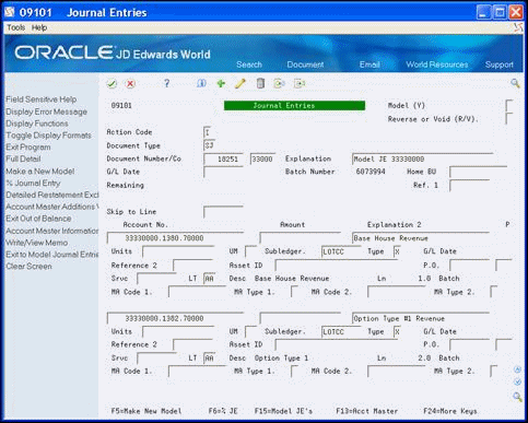

Choose More Details (F4).
Figure 47-5 journal Entries (Display Formats, Detail) screen
Add or change the detail lines to suit your needs.
