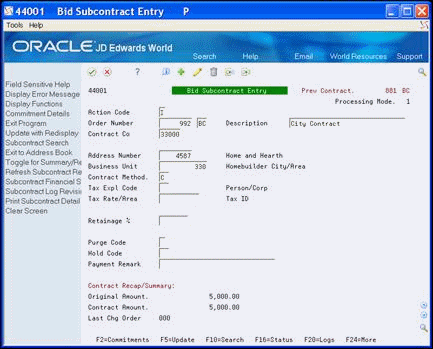

On Bid Subcontract Entry, enter C in the Contract Method field.
Figure 14-1 Bid Subcontract Entry (City or Company) screen
Add the subcontract.

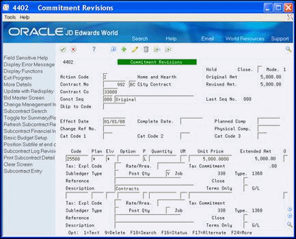

Choose Commitment Details (F2) to access the Commitment Revisions screen.
Enter the city- or company-level detail information in the detail lines.
Figure 14-2 Commitment Revisions (City or Company) screen
