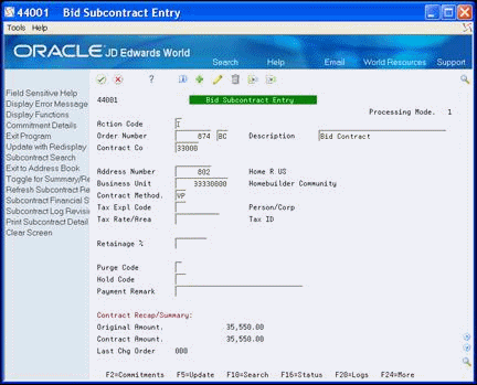

You use the Bid Subcontract Entry screen to create the header information for a bid subcontract. The header information includes the contract number, your homebuilding company code, the subdivision, the contract methodology, and tax information.
The contract methodology field allows you to specify whether the Lot Proceed Proof/Post program automatically assigns a primary supplier or you assign a supplier using the Bid Supplier Assignment screen. If you have more than one supplier you should complete this field. You do not complete the Contract Methodology field if you have only one supplier.
When a subcontract is bid, you use the Tax Explanation field to determine how to calculate sales tax needs for the base house cost.
From Homebuilder Management (G44H), choose Options/Bid Subcontracts
From Options & Bid Subcontract Setup (G44H11), choose Bid Subcontract Entry
Set the following processing options for the Bid Subcontract Entry program:
Set the Display Number of Jobs processing option to 2 for bids, allowing one job per contract. This processing option controls whether you can process multiple jobs per subcontract. Depending on how you set this processing option, the screen displays the Project field, the Job Number field, or neither. If the Project or Job Number field displays and you do not specify a project or job number you must specify a contract company.
Set the Format Selection processing option to 1 to display the Homebuilder format for subcontract entry.
Set the Processing Mode Selection processing option to 1 to specify Homebuilder processing mode.
Set the Processing Sequence Selection processing option to specify whether the Commitment Revisions or Contract Log screens displays when you add a subcontract.
Depending on how the system constant is set, the effective date might control validation of available bid subcontract documents. An alternative method of validating available bid subcontract documents is sequence number. This does not display on Bid Subcontract Entry.
For a given subcontract, the processing options for Commitment Revisions must match the settings for Bid Subcontract Entry.
To enter a bid subcontract for a subdivision
On Bid Subcontract Entry, complete the following fields and click Add or Update with Redisplay (F5):
Order Number
Description
Contract Company
Business Unit
Contract Method
Tax Explanation Code
Tax Rate/Area

You use the Bid Subcontract Entry screen to change the header information for an existing bid subcontract.
To revise a bid subcontract for a subdivision
On Bid Subcontract Entry, complete the following fields and click Change or Update with Redisplay (F5):
Order Number
Contract Company
If you leave the Contract Company field blank and there are two or more subcontracts with the same contract number, the system displays the Order Selection screen for you to choose the appropriate subcontract.
The Bid Subcontract Entry screen displays with the subcontract you chose.
To revise the header information after the subcontract displays, enter new information over the current information, and click Change or Update with Redisplay (F5).

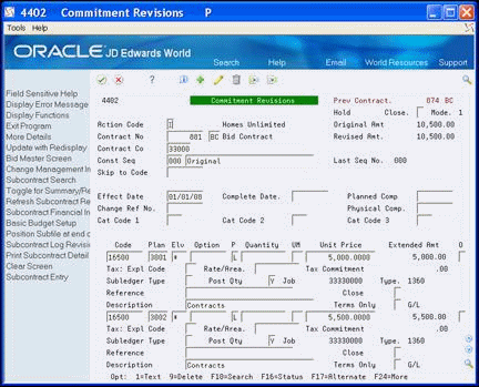

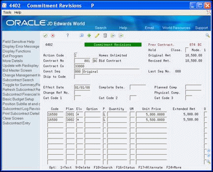

You use Commitment Revisions to enter commitments for a bid subcontract. If you access the Commitment Revisions screen from the Bid Subcontract Entry screen, the system enters most of the header information. The system always enters 000 in the Construction Sequence field for the base contract.
You enter the commitment details in the detail portion of the screen. You can enter information in the Cost Type (Code) field, or the system enters the information from the AAIs when you run the Lot Proceed Proof/Post. You can also add tax information.
After you enter the commitment information, you run the Lot Proceed Proof/Post program. This program selects one cost code, plan, and elevation combination commitment per base agreement contract. If two commitments exist with the same cost code, and one commitment specifies a plan and the other commitment includes an asterisk, the system selects the plan-specific commitment. The same selection criteria applies to elevation, that is, the system selects a specific elevation before it selects a commitment indicating all elevations. If there are two or more vendors with the same cost code, plan, and elevation combination, the system selects more than one commitment if the additional vendors have a unique option. When you run the Lot Proceed Proof/Post program, the results include:
The base house contract displays with the amount.
The subcontract with the option amount displays as an additional option line and the other base house contract displays on the Lot Proceed Proof/Post (R445098) report.
After you run the Lot Proceed Proof/Post program, the OS contract includes a change in sequence in the Construction Sequence field based on change orders that affect the plan or plan/elevation combination.

On Commitment Revisions, complete the following fields:
Contract No
Contract Co
Effective Date
Complete Date
Skip to Code (cost code)
Plan
Elevation
Option
Pricing Type (P)
Quantity
Unit of Measurement (UM)
Unit Price
The system calculates information for the Extended Amount field.
Choose More Detail (F4) to access the detail area.
Figure 13-4 Commitment Revisions (Detail) screen

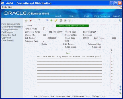

Enter 1 in the Option field to include a comment for the commitment.
Figure 13-5 Commitment Distribution screen
On the Commitment Distribution screen, enter a comment and click Enter.
Continue to choose Exit (F3) to return to the menu.

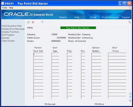

You use Pay Point Bid Master to associate a parent cost code with an option. You use Pay Point Percentage Allocation to view and accept the spread across the child accounts that the system creates based on information from Bid Master and Pay Point Bid Master.
The processing options for Pay Point Percentage Allocation allow you to accept the final contract and override the contract information.
From Options & Bid Subcontract Setup (G44H11), choose Commitment Revisions
To enter pay point bid master accounts
On the Commitment Revisions screen, choose Bid Master Screen (F6) to access Pay Point Bid Master.
The system enters values in the Company, Subdivision, and Vendor fields based on the information from Commitment Revisions.
Complete the following fields:
Choose Spread (F6) to create the spread and display Pay Point Percentage Allocation.
The system enters the values in the Parent Cost Code and Description fields.
Review the spread information in the detail area and perform one of the following.
If the information is correct, click Enter.
By clicking Enter, you accept the amount. If you entered more than one parent cost code on Pay Point Bid Master, the next parent cost code and its information displays.
Choose Update to Commitment Revisions (F6) to return to Commitment Revisions where this information displays in the detail area of the screen to create the commitment.

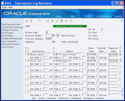

You use Subcontract Log Revisions to add subcontractor bid information, such as signed contracts, insurance certificates, IRS tax information, and so on. You access this screen from the Bid Subcontract Entry screen, and the system enters the values in the header. The detail area of this screen is available for your notes for the log entries.
| Topic | Description |
| Processing Sequence Selection Processing Option | Specifies whether the Commitment Revisions screen or Subcontract Log Revisions screen displays when you add a subcontract. |
| Detail Area Fields | The fields in the detail area of the Subcontract Log Revisions screen are user defined, and your company might choose to use different codes and descriptions than those shown in the example. |
To add Subcontract Log Revisions
On the Bid Subcontract Entry screen, choose Subcontract Log Revisions (F20).
Figure 13-7 Subcontract Log Revisions screen
In the detail area of the Subcontract Log Revisions screen, complete the following fields:

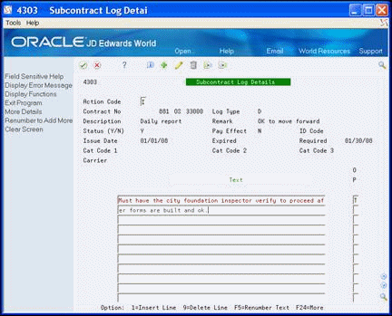

To add a comment, enter 1 in the Option field to access the Subcontract Log Details text screen.
Figure 13-8 Subcontract Log Details screen
On Subcontract Log Details, enter your comment and click Enter.
Choose Exit (F3) to return to Subcontract Log Revisions.

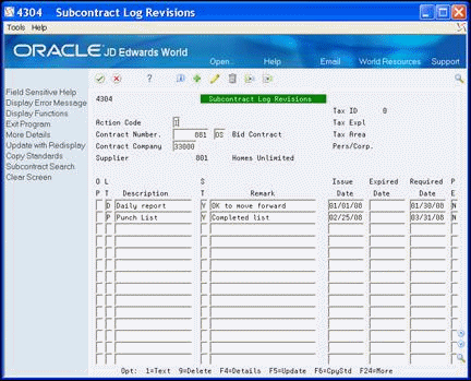

Figure 13-9 Subcontract Log Revisions screen
In the detail area of the Subcontract Log Revisions screen, enter the appropriate information in the fields set up by your company.
Choose Update with Redisplay (F5) to update the database or click Add.
Click Exit (F3) to return to the Bid Subcontract Entry screen.
