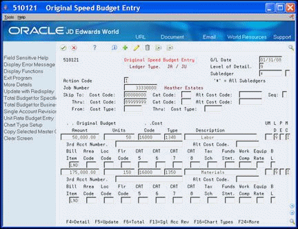

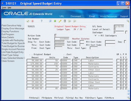

Figure 5-1 Original Speed Budget Entry screen
Select the detail line to update.
Enter the number of units in the following field.
Original Budget Units
Enter the budget amount in the following field.
Original Budget Amount
Choose More Details (F4) to access the detail area.
Figure 5-2 Original Speed Budget Entry (Detail) screen
You can add the information for Category Codes 1 through 5 if they are blank.
