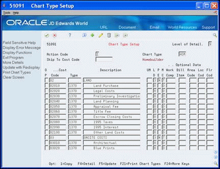

You use the Chart Type Setup screen to set up your homebuilder chart of accounts. You can use the JD Edwards World Homebuilder Management system model and modify it, or you can create your own chart of accounts.
You can enter your Bill Item, Area Code, and Location Code (Category Codes 1 through 3 respectively) information on Chart Type Setup. If you include this information, it becomes part of your master chart model. You only need to enter the information here and copy it to your subdivision and plans. Alternatively, you can also enter Category Codes 1 through 3 using the Copy Selected Master Codes screen. You use these user-defined codes (UDCs) as follows:
Bill Item is a UDC trade code that you can use for Material Handling vendor identification.
Area Code is a UDC that identifies the sequence of construction.
Location Code is a UDC that you can use for phase release.
From Homebuilder Management (G44H), choose Subdivision/Plan/Lot Setup
From Subdivision/Plan/Lot Setup (G44H1), choose Chart Type Setup
To choose a model chart of accounts
On Chart Type Setup, the Job Cost system cost codes display.
Place the cursor in the Chart Type field and choose Field Sensitive Help (F1).
The User Defined Codes Window displays the available chart types.
Figure 4-2 User Defined Codes Window screen
Highlight the type you want (for example, HOM), and click Select/Work With from the Options menu.
Chart Type Setup displays with HOM in the Chart Type field.
Click Enter.
Chart Type Setup displays with the HOM model chart of accounts.
Figure 4-3 Chart Type Setup (HOM Model) screen

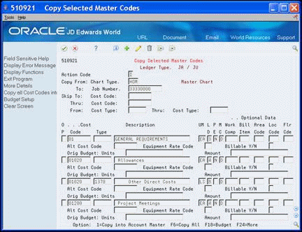

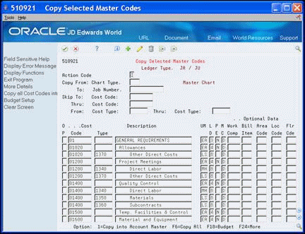

You use the Copy Selected Master Codes screen to create your subdivision chart of accounts, which is based on the model that you set up. You can add or modify the detail lines to satisfy your homebuilding company's requirements for the subdivision. You can add Homebuilder construction information for Category Codes 1, 2, 3, and 4 using the Copy Selected Master Codes screen. If you use Category Code 5, you access the Original Budget Entry screen for adding information for Category Codes 1, 2, 3, 4, and 5.
Use Account Master Category Codes 1, 2, and 5 for trade (roofing, flooring, and so on), scheduling construction sequence, and cost of sales. The system stores this information in the Account Master table (F0901). Use Category Code 3 for phase release. Category Code 4 is a UDC you use in accordance with your Company's requirements.
If you have more than one subdivision that uses the same chart of accounts information, create one chart of accounts and copy it for all your subdivisions. If your subdivisions use different chart of accounts information, create a chart of accounts for each subdivision.
If you use Material Handling (takeoffs), you set up Bill Items. See Section 23.1, "Defining Takeoff Lists" for more information.
From Subdivision/Plan/Lot Setup (G44H1), choose Copy Selected Master Codes
On Copy Selected Master Codes, the Job Cost system cost codes display.
Figure 4-4 Copy Selected Master Codes screen
Complete the following fields:
Copy From: Chart Type
To: Job Number
Choose Copy All Cost Codes into Account Master (F6).
This creates a subdivision chart of accounts based on your homebuilder model.
Click Add.
Click More Detail (F4) to view data in the detail area.
Figure 4-5 Copy Selected Master Codes (Detail) screen
Perform one of the following:
If you use only Category Codes 1 through 4, for each applicable homebuilder detail line, complete the category code fields and click Change.
Bill Item (Category Code 1) is a UDC that you can use for Material Handling vendor (trade code) identification.
Area Code (Category Code 2) is a UDC that identifies the sequence of construction.
Location Code (Category Code 3) is a UDC that you can use for phase release.
Floor Code (Category Code 4) is a UDC.

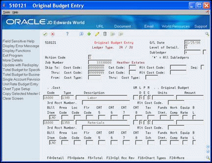

If you use Category Codes 1 through 5, you can choose Budget Setup (F18) to access the Original Budget Entry screen.
On Original Budget Entry, click More Detail (F4) to view data in the detail area.
Figure 4-7 Original Budget Entry (Detail) screen
Optionally, for each applicable detail line, complete the category (CAT) code fields.
Optionally, complete the Bill Item field if you use takeoffs.
Choose Update with Redisplay (F5) to update the database.
Click Exit (F3) to return to the Copy Selected Master Codes screen.

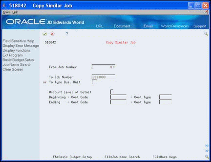

You use the Copy Similar Job screen to copy your subdivision chart of accounts to your plan (job) chart of accounts. You use the plan chart of accounts to track costs and report at the plan level. You can roll up and report these costs at the subdivision level by setting a processing option. You create a plan chart of accounts for each plan in each subdivision.
From Subdivision/Plan/Lot Setup (G44H1), choose Copy Similar Job

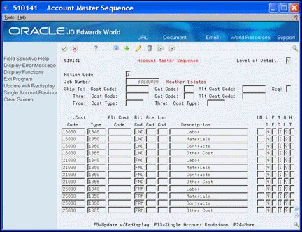

You use the Account Master Sequence screen to view your chart of accounts. You can use this screen to modify your chart of accounts and to add Master Category Codes 1 through 3.
From Subdivision/Plan/Lot Setup (G44H1), choose Account Master Sequence
To view your chart of accounts
On Account Master Sequence, enter your subdivision number in the following field and click Enter.
Job Number
The Account Master Sequence screen displays your subdivision chart of accounts.
Figure 4-9 Account Master Sequence screen
