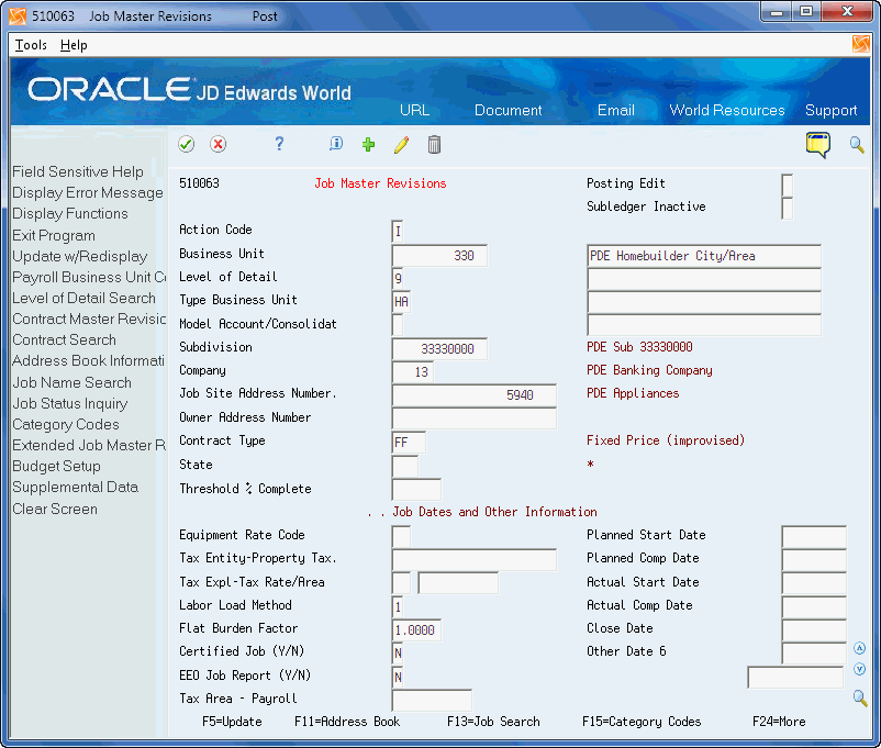

The city business unit is a base to which you associate all the suppliers within a city that are supplying items or services for your subdivisions. You associate your homebuilding company with the city where the construction is to take place. The city business unit code is a user defined three-character code for the city name. For example, the city code for Denver could be DEN. You use the Job Master Revisions screen to set up the business units. The Material Handling system uses the city business unit for takeoff contracts as well as bid subcontracts. The city is also known as the branch/plant in the Inventory system Constants table. You can set up a city business unit or a company business unit that do not link to a specific subdivision.

On Job Master Revisions, complete the following fields:
Business Unit (city)
Level of Detail
Description (city name in the second entry box on the Business Unit field)
Type Business Unit
Company
Choose Update with Redisplay (F5) to update the database.

| Field | Explanation |
| Business Unit | The compressed description contains the alpha name without spaces, slashes, dashes, commas, and other special characters. The compressed description is the field used in the Name Search. Screen-specific Information Enter the city code. |
| Level of Detail | A code that identifies the relationship of parent and subordinate business units in a hierarchy. Up to nine levels of detail are available. |
| Description | A user defined name or remark. Screen-specific Information Enter the city name. |
| Type Business Unit | This column contains a list of valid codes for a specific user defined code list. The number of characters that a code can contain appears in the column title. Screen-specific Information This is an optional field unless you globally copy options to subdivisions. Typically you enter HA for city/area, HC for Community, HP for Plan and HL for Lot. |
| Company | A code that identifies a specific organization, fund, entity, and so on. The company code must already exist in the Company Constants table (F0010) and must identify a reporting entity that has a complete balance sheet. At this level, you can have intercompany transactions. Note: You can use Company 00000 for default values, such as dates and automatic accounting instructions. You cannot use Company 00000 for transaction entries. |

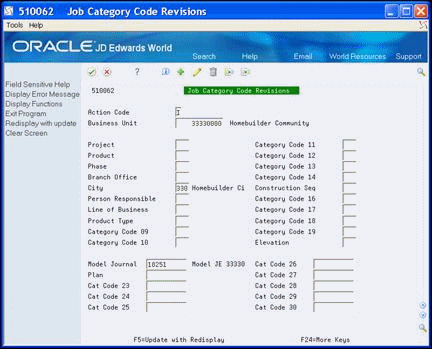

After you set up your subdivision business unit, you use the Job Category Code Revisions screen to associate the subdivision to the city where the construction takes place. The Material Handling system uses this information for takeoff contracts.
Category code fields 15, 20, and 22 on the Job Category Code Revisions screen are unique to the Homebuilder Management system. The Construction Seq (sequence) field (category code 15) is reserved for the construction sequence, which the system enters when you run the Lot Proceed/Post program. The Elevation and Plan fields (category codes 20 and 22 respectively) are reserved for the plan and elevation numbers, which the system enters when you run the Lot Proceed/Post program.
Business Unit (subdivision number)
Level of Detail
Description (subdivision name in the second entry box on the Business Unit field)
Subdivision
Company
Figure 3-2 Job Master Revisions (Subdivision) screen
Choose Category Codes (F15) to access the Job Category Code Revisions screen.
The system enters your subdivision number in the Business Unit field.
Figure 3-3 Job Category Code Revisions screen
Complete the following fields:
City
This is Category 5 and you enter your city business unit code which the system uses to associate the subdivision with the city.
Complete the following optional fields for sales reporting:
Project
Product
Phase
Branch Office
Complete the following optional field:
Model Journal
Click Add.
Click Exit (F3) to return to the Job Master Revisions screen.
