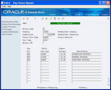

A pay point is a method of dividing an account into discrete activities or components and allocating a percentage of the payment to the activity or component level. The parent cost code is in the chart of accounts. For each parent cost code, you set up the child cost codes.
You use the Pay Point Master screen to set up parent and child cost codes. You set up the parent cost code using the chart of account cost code and cost type. You then set up the child cost codes and allocate a percentage of the whole contract amount (100 percent) to each child cost code.
From Homebuilder Management (G44H), choose Subdivision/Plan/Lot Setup
From Subdivision/Plan/Lot Setup (G44H1), choose Pay Point Master
On Pay Point Master, complete the following fields:
Company
Subdivision
Parent Cost Code
Cost Type
Option
In the detail area, complete the following fields and click Add:
Pay Pnt (Pay Point)
Child Cost Code
Payment Percent
Description
