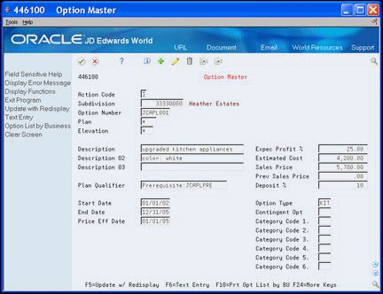

You use the Option Master screen to set up and maintain a list of the available options for a subdivision. The Option Master screen also provides the capability for you to include textual information for an option.
From Homebuilder Management (G44H), choose Options/Bid Subcontracts
From Options/Bid Subcontracts (G44H11), choose Option Master
On Option Master, complete the following fields:
Complete the following optional fields:
Estimated Cost
Sales Price
Previous Sales Price
Deposit Percentage
Option Type
Contingent Option

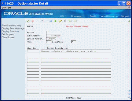

Choose Text Entry (F6) to access the Option Master Detail screen.
The system enters values for the Subdivision, Option Number, Plan, and Elevation fields.
Complete the following field.
Option Description
Click Add.
Exit (F3) to the Option Master screen.

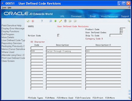

In the Contingent Option field choose Field Sensitive Help (F1).
The User Defined Codes Window displays the current contingent options for the Contingent Option (Category Code 8) field.
Figure 9-3 User Defined Codes Window (Contingent Option) screen
From the Functions menu, choose Exit to User Defined Codes Maintenance (F10).
Figure 9-4 User Defined Code Revisions screen

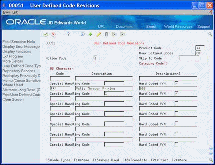

On User Defined Codes Revisions, choose More Details (F4).
Figure 9-5 User Defined Code Revisions (Detail) screen
Complete the following fields and click Add:
Code
Description
Description 2
Special Handling Code
Hard Coded Y/N
Exit (F3) to the User Defined Codes window.

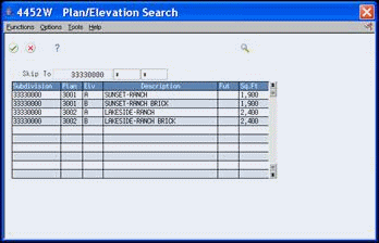

You can search for an existing plan or elevation and include this information to your option master.
From Options/Bid Subcontracts Setup (G44H11), choose Option Master
To add an existing plan or elevation
On Option Master, complete the following field:
Subdivision
Complete either of the following fields:
Plan
Elevation
Choose Field Sensitive Help (F1).
The Plan/Elevation Search window displays with valid plan and elevation combinations.
Choose the plan or elevation detail line.
The Option Master screen redisplays with the Plan/Elevation information.

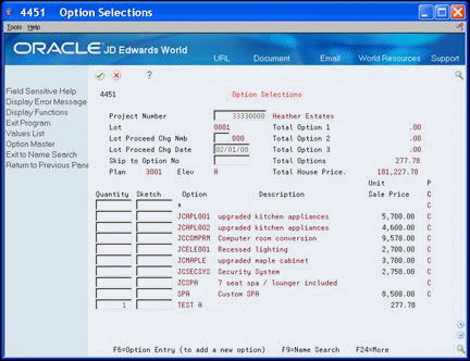

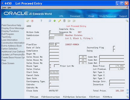

You can use the Option Selections screen to select specific options for a lot. You can also add an option that is specifically for a lot.

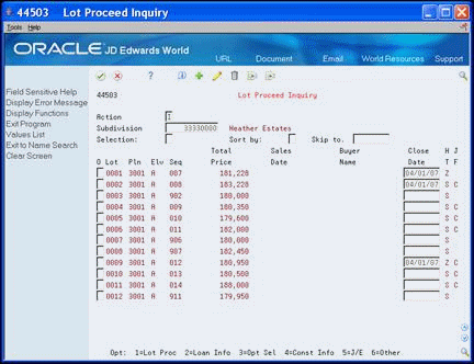

You use the DREAM Writer Version Selection processing option for the Lot Proceed Inquiry program (P44503) to control the version of the Option Selections screen.
From Homebuilder Management (G44H), choose Closing/Revenue Processing
From Homebuilder Accounting Entries (G44H16), choose Lot Proceed Inquiry r
On Lot Proceed Inquiry, complete the following field and click Inquire.
Subdivision
Enter 1 in the following field next to a lot to access the Lot Proceed Entry screen:
Option
On Lot Proceed Entry, complete the following fields:
Plan/Elevation
House Type
Start Date
Choose Option Selection (F12) to access Option Selections.
On Option Selections, perform one of the following:
Choose Option Master (F6) to access the Option Master Entry screen and add an option for that lot.
Complete the Quantity field to select the options for the specific project and lot and click Enter.

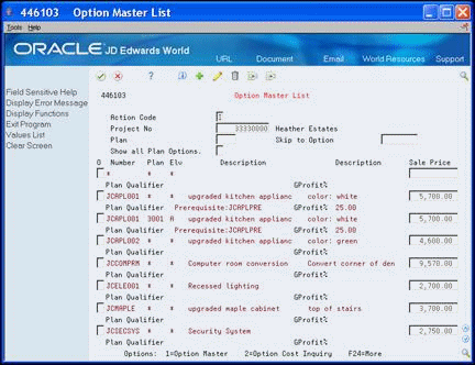

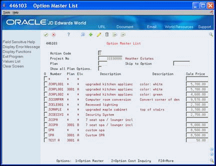

You use the Option Master List to review all of your available options. You can review the options for the subdivision or for a particular plan. You cannot change option information using this screen. You can select an option and access the Option Master Entry screen, where you can make changes. You can also select an option and access the Option Cost Detail screen, where you can view change supplier and cost information.
From Options/Bid Subcontracts Setup (G44H11), choose Option Master List
On Option Master List, complete the following fields and click Inquire.
Project No
To narrow your search, complete the following fields:
Plan
Skip to Option
The Option Master List displays your subdivision or plan options.
Access the detail area (F4).
Figure 9-13 Option Master List (Detail) screen

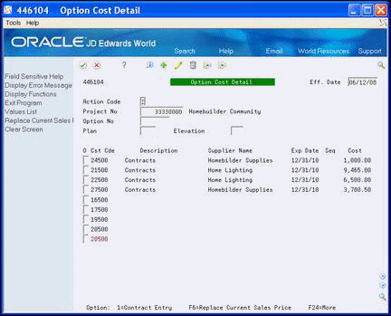

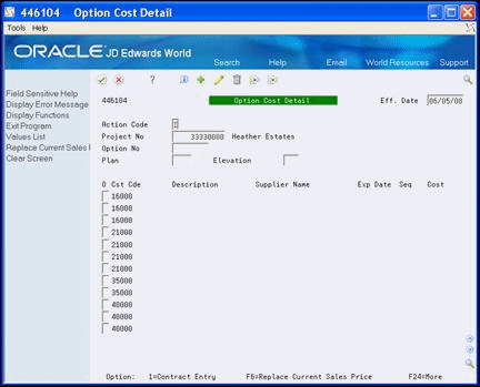

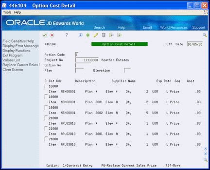

The system creates the option detail information after you run the Lot Proceed Proof/Post program. You use the Option Cost Detail screen to review supplier and cost information for an option. You can review the option information by subdivision, by subdivision and plan, by subdivision and option, or by subdivision, option, and plan. If you choose to review the option information using subdivision, option, plan, and elevation, the Option Cost Detail screen displays the previous sale and current sales price.
From Options/Bid Subcontracts Setup (G44H11), choose Option Cost Detail
Alternatively, you can access Option Cost Detail from the Option Master List screen by entering 2 in the Option field for a specific option.
On Option Cost Detail, complete the following fields and click Inquire.
Project No
Option No
Plan
Elevation
The Option Cost Detail screen displays option supplier and cost information.
Figure 9-15 Option Cost Detail (Details Shown) screen
You can change the current sales price on the Option Cost Detail screen. The system uses the current option sales price and the effective date from the Option Master (F4461) table to update the current sales price. Other than the current sales price, you cannot change option information using the Option Cost Detail screen.
For the system to accept a change in the sales price, the header fields on the Option Cost Detail screen must match the data in the Option Master (F4461) table. All of the header fields on the Option Cost Detail screen are required fields when you change a sales price.
Project No
Option No
Plan
Elevation
The Option Cost Detail screen displays supplier and cost information for an option. Previous and current sales price fields also display.
Figure 9-16 Option Cost Detail (Change Sales Price) screen
Choose Replace Current Sales Price (F6).
The Option Cost Detail screen redisplays with the current sales price. The system updates this field based on the effective date and the current sales price from the Option Master Entry program (P446100). The date in the Effective Date field should fall between the dates in the Start and End Date fields. There must also be a subcontract with dates in the Effect Date and Complete Date fields for this information to display on the screen.
Choose More Detail (F4) to access the detail area.

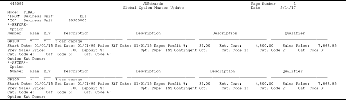

You use Global Option Master Update to copy or change options or option fields from one city, company, or subdivision business unit to another business unit. To use this program, you must ensure that you are copying from and to the same business unit types. For example, copy from a company business unit with a business unit type of residential to a subdivision business unit with a business unit type of residential. This program generates the Global Option Master Update report (R445094).
You can run a DEMO version or copy a version and change it to suit your needs from the DREAM Writer version list. You can also run this program in proof mode and final mode.
From Homebuilder Management (G44H), choose Hidden Selection 27
From Homebuilder Management Technical Operations (G44H31), choose Global Option Master Update
If you use this program, the appropriate information must exist in the Type Business Unit field of the Job Master Revisions screen.
Figure 9-17 Global Option Master Update report
