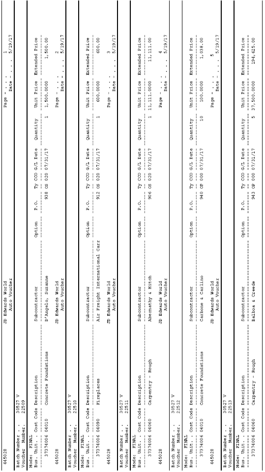

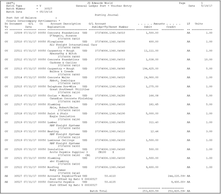

You use the Auto Voucher program to simultaneously create progress payment vouchers for multiple homebuilder contracts that have open payable amounts. The program creates vouchers for any remaining open amounts from the contracts you select and a batch of accounts payable records in the Accounts Payable Ledger table (F0411). This program creates the Auto Voucher Report (R445028) and the Posting Journal (R09871). You should correct any errors from the Posting Journal and then post the batch of vouchers.

When you select Auto Voucher from the menu, the system displays a DREAM Writer version list. You can run a DEMO version or copy a version and change it to suit your needs. Enter the General Ledger date in the Date Selection processing option and specify proof or final mode in the Update Option processing option. Additionally, in the Default Status processing options enter A for Pay Status, OV for the voucher type, and Z for the purge code.

Figure 45-2 General Ledger Post -Voucher Entry report

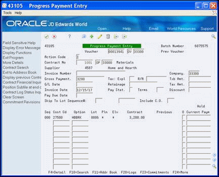

Use the Progress Payment Entry program to enter a voucher.

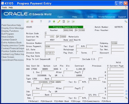

If you plan to pay the entire amount, you can leave the Gross Payment field blank and enter 1 in the Option field in the detail line. If you plan to make a partial payment, enter the amount in the Gross Payment field and in the Current Payment field in the detail line.
On Progress Payment Entry, complete the following fields and click Enter.

The detail area of the screen displays the line item commitments for the contract. It also includes the total amount for each line item and the paid-to-date amounts.
Enter the voucher information in the specific commitment lines and click Enter.
For a single-priced voucher, you do not need to enter the voucher amount. Instead, you can enter the number of units you want, and the system calculates the voucher amount for the commitment line.
Figure 45-4 Progress Payment Entry (Detail) screen
The system accepts your entries and clears the screen except for the G/L Date and Company Number. The Previous Voucher field displays the voucher number that the system assigns. The system calculates the following:
The gross amounts (gross payment, retainage, taxable amount, tax amount, and discount) that display in the upper portion of the screen based on the vouchers you enter on the commitment line item.
The pay due date, based on the payment terms code in the Address Book system for the contractor or supplier.
The amount of retainage instead of the percentage rate for each commitment line for which you enter a voucher.

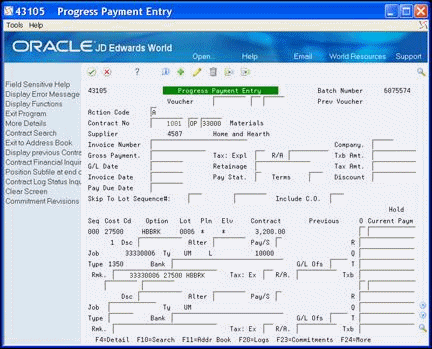

If you do not enter a contract type, the system enters the value from the Default Option processing option. If you do not enter a contract company and there is more than one contract with the same contract number, the Order Selection screen displays allowing you to select a company. The Progress Payment Entry screen displays the amounts for the specific line items of the contract.
On Progress Payment Entry, complete the following fields and click Inquire.

Figure 45-5 Progress Payment Entry (Locate Voucher) screen
Choose More Details (F4) to access the detail area.
Figure 45-6 Progress Payment Entry (Locate Voucher, Detail) screen

After you create vouchers, you must post them to the general ledger. You use Post Voucher to G/L to perform this task.

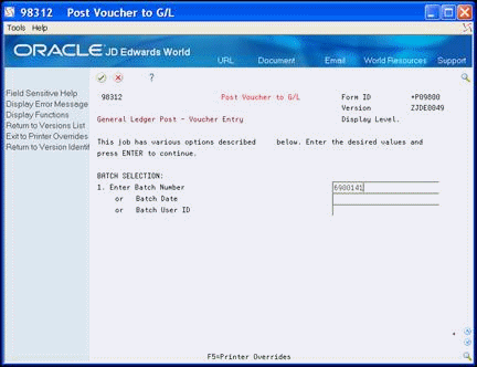

To post vouchers to the general ledger
On Post Voucher to G/L, complete one of the following fields and click Enter.
Batch Number
Batch Date
Batch User ID
Figure 45-7 Post Voucher to General Ledger screen
