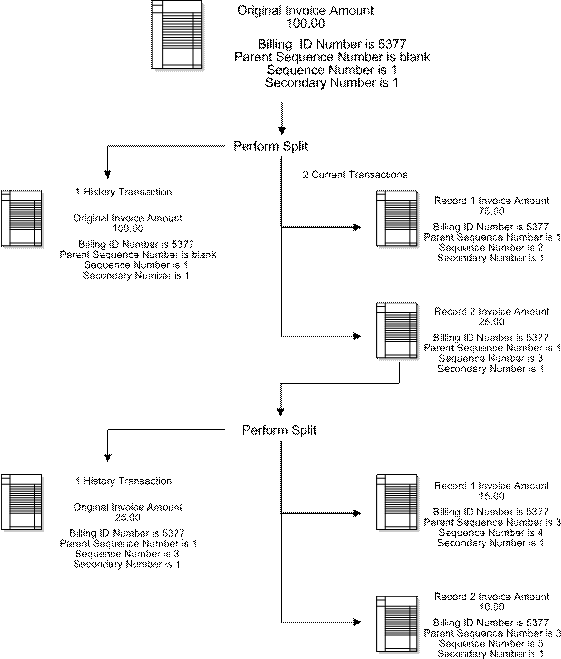

When you revise workfile transactions, the system assigns the transactions and each new revision a series of sequence numbers.
Figure 6-1 Workfile Revisions and Sequence Numbers
You can use these numbers to track the progression of revisions to original workfile transactions. The system assigns each workfile transaction the following sequence numbers:
| Number | Description |
| Billing Control ID | The BCI number is assigned at the time the workfile transaction is first created in the Billing Workfile. The system uses Next Numbers (System 48, Index 2 for Billing Control) to derive the number. The BCI number of a workfile transaction never changes, regardless of the revisions made to the workfile transaction. |
| Sequence number | The sequence number of the original workfile transaction is always 1. The sequence number changes only when you split the workfile transaction. The system assigns the next available sequence number within that BCI series to the resulting workfile transactions. Tor example, the first time a workfile transaction is split, the sequence numbers assigned to the resulting workfile transactions are 2 and 3. If you split one of those workfile transactions, the sequence numbers assigned to the resulting workfile transactions are 4 and 5. |
| Parent sequence number | The parent sequence number for an original workfile transaction is always blank. The system assigns a parent number to transactions that result from a split. The parent number for resulting transactions is always the sequence number of the transaction that you split. For example, if you split an original workfile transaction with a sequence number of 1 and a blank parent sequence number, the system assigns the resulting transactions a parent number of 1. |
| Secondary sequence number | The secondary sequence number tracks the number of revisions you make to a workfile transaction. The secondary sequence number of the original workfile transaction is always 1. You can use this number to track the progression of revisions to original workfile transactions. For example, you might revise a transaction three times. The secondary sequence number of the transaction you revise is 1. After the revision, the secondary sequence number for the transaction is 2. When you change the transaction again, the secondary sequence number is 3. When you split a workfile transaction, the secondary sequence numbers will be 1 on the resulting workfile transactions. |

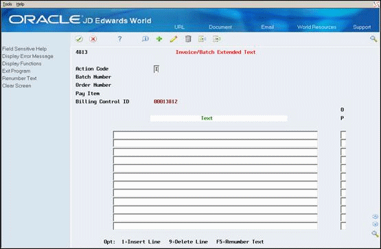

You can enter text to associate additional information with a workfile transaction. For example, the text might be a further description of the services for which you bill customers. You can enter text for a transaction at any point in the billing process. You can also print this text on an invoice. The system uses the billing control ID (BCI) number to attach text, which is stored in the Service Billing Invoice/Batch Extended Text File (F4813) to transactions in the Billing Workfile (F4812).
To add text to a workfile transaction
On Revisions
Complete the steps for reviewing workfile transactions.
Choose Text (Option 1) for a specific transaction.
Figure 6-2 Invoice/Batch Extended Text screen
On Invoice/Batch Extended Text, enter free-form text.
If you need to enter more text, you can scroll to display additional lines. After you enter text, the system highlights the Option field on the Revisions form to indicate that the text exists for the transaction.

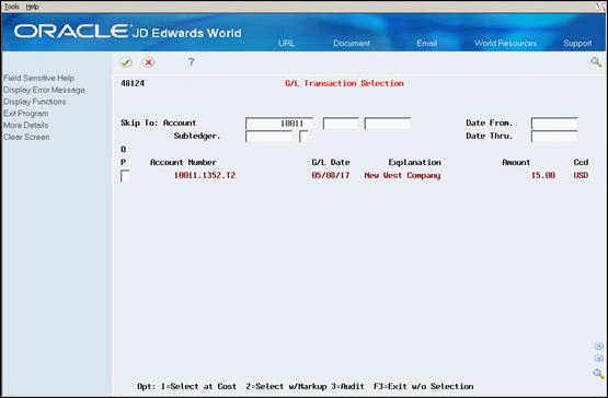

You can add transactions from the Account Ledger table (F0911) to the Billing Workfile (F4812) without running the Workfile Generation program (P48120). For example, you can include costs for workfile processing that you did not include in the workfile generation. You can also include costs in the workfile for processing that were entered in the General Accounting system after you ran Workfile Generation
You can add transactions to the workfile using one of the following amounts:
The cost without markup
The cost plus markup, based on the markup rules you define or the default markup percentage you specify in the system constants
When you add a source transaction to the workfile, the system runs Workfile Generation interactively for the selected accounting entries. The system marks the transaction as billed in the Account Ledger (F0911) table. If the billable accounting entry originated from the payroll system, the system updates the Payroll Transaction History (F0618) or Employee Transactions Detail (F06116) tables. The system also applies any markup, tax, and G/L offset information retrieved from the Service Billing tables.
To add existing G/L transactions
On Revisions
Figure 6-3 G/L Transaction Selection screen
On G/L Transaction Selection, complete the following field to display the existing source transactions:
Business Unit
To limit the list of transactions, complete one or more of the following fields:
Date From
Date Thru
Object
Subsidiary
Subledger
Subledger Type
The system automatically supplies the information for these fields if you completed them on the Revisions form.
Choose one of the following for a specific transaction:
Choose at Cost (Option 1)
Choose with Markup (Option 2)

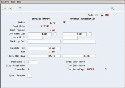

The markup for a transaction is the increase in costs to account for overhead and profit. You define markup rules in the Cost Plus Markup Table (P48096) when you set up your system. You can also change markup information after you accumulate costs.
After you make changes to the markup, you can apply the revised markup information to the transaction, or you can reapply the markup rules you originally defined for your system on the Cost Plus Markup Table.
In addition to changing the markup through Workfile Revisions, you can also make changes to the Amount Basis and Adjustment Reason Code options by choosing Re-Extension (P481202) from the Workfile Generation menu.
On Revisions
Choose Detailed Transaction Window (Option 4) for a specific transaction.
Figure 6-4 Detailed Transaction Window screen

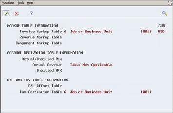

To review the origin of the markup and tax information for the transaction, choose Table Information (F15). In the following example, Table Not Applicable indicates that no markup table was found and the markup was derived from the system constants.
On Table Information, choose Amounts/Units Information (F11) to return to the Amounts/Units Information form.
On Amounts/Units Information, complete any combination of the following applicable fields:
Override Rate
Cap or Rate
Mark Up Percent
Mark Up Amount
Choose Update (F5).
The system calculates the markup and displays the changes.
Choose Exit Program (F3).

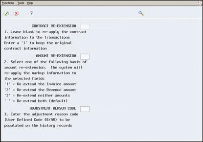

The system displays Transaction Re-Extension.
Figure 6-6 Transaction Re-Extension screen
On Transaction Re-Extension, complete the following applicable fields:
Amount Re-Extension
For Amount Re-Extension, the revenue option does not apply if the transaction is not eligible for the revenue recognition process. If you choose 2 for the Amount Re-Extension, the system does not re-extend the invoice information.
Choose Process (F6).
The system retains the information you entered on the form and displays it the next time you access the Transaction Re-Extension form.

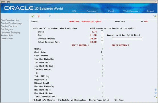

After you accumulate costs, you can split a workfile transaction into two new transactions. You can split a transaction by a specific currency amount, unit amount, or a percent.
You might want to split a transaction so that you can process one of the new transactions, but not the other. For example, an employee works overtime and is paid at twice the regular hourly rate. If you need to bill the employee's time at the regular rate, you can split the workfile transaction into two equal portions. One portion can be billable and the other nonbillable.
You can split only payroll transactions that do not include associated burden. You cannot split burden transactions.
When you split a workfile transaction, the system:
Displays two new transactions. The amounts and units for the new transactions equal that of the transaction prior to the modification.
Moves a copy of the workfile transaction prior to the modification to the Billing Workfile - History (F4812H).
Assigns sequence numbers to all the related transactions. The Billing Control ID (BCI) remains the same for the workfile transactions. You can review the sequence numbers and Billing Control ID in the accounting and internal control information.
Splits associated component transactions.
The following graphic illustrates how the system processes and assigns sequence numbers to transactions when you split a workfile transaction.
Figure 6-8 Split Workfile Transaction Sequence Numbers
To split a workfile transaction
On Revisions
Choose Split (Option 2) for a specific transaction.
Figure 6-9 Workfile Transaction Split screen
On G/L Transaction Split Window, complete one of the following fields:
Units
Cost
Invoice Amount
Complete the following field:
Amount or % for Split Record 1
Choose Update with Redisplay (F5) to update the displayed information.
Verify that the information is correct.
Choose Perform Split (F6) to update the workfile transactions.
| Field | Explanation |
| Units
(U) |
The quantity of something that is identified by a unit of measure. For example, it can be the number of barrels, boxes, cubic yards, gallons, hours, and so on.
Form-specific information If you enter X in this field, the system performs the split based on the units of the workfile transaction. |
| Cost
(AA) |
The cost (source) amount for a workfile transaction.
Form-specific information If you enter X in this field, the system performs the split based on the cost (source) amount of the transaction. |
| Invoice Amount
(ITXA) |
The portion of the invoice amount that is subject to tax.
Form-specific information If you enter X in this field, the system performs the split based on the taxable portion of the invoice amount of the transaction. |

Complete the following field for a specific transaction to make it nonbillable:
Eligibility Code
Use the Change action.
Amount Re-Extension
The system displays Revisions.
On Revisions, choose Delete (Option 9) for the workfile transaction.
Amount Re-Extension

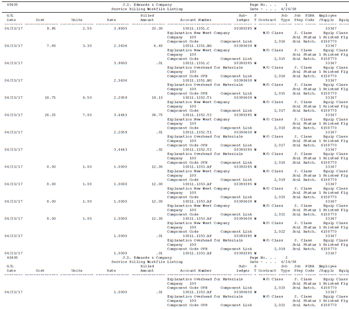

From Workfile Generation (G4822), choose Print Workfile (P48405)
You can review workfile transactions online. You can also generate a report that prints a list of selected transactions. You might want to use this report for a number of reasons, including:
As an exception report, for example, to print all of the transactions that are on hold
As a comparison with the detail in the general ledger
To compare the workfile transactions to the detail in the general ledger, you can review the general ledger online using Account Ledger Inquiry (P09200), or you can print the G/L by Object Account (P09421) report.
If you find a discrepancy, you should make the necessary revisions before you continue with the billing process.
Figure 6-10 Service Billing Workfile Listing
