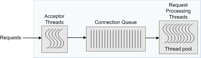

When a client sends a request to an HTTP listener in an Oracle Traffic Director instance, the connection is first accepted by an acceptor thread that is associated with the HTTP listener. The acceptor thread puts the connection in a connection queue and then waits for the next client request. A request processing thread from a thread pool takes the connection from the connection queue and processes the request. Note that if the thread pool is disabled, acceptor threads themselves process every request. The connection queue and request-processing threads do not exist.
Figure 14-1 depicts the connection handling process.
Figure 14-1 Connection Handling in Oracle Traffic Director
When an Oracle Traffic Director instance starts, it creates the specified number of acceptor threads for each listener and a thread pool that contains a specified, minimum number of request-processing threads.
If the number of acceptor threads for a listener is not specified, Oracle Traffic Director creates one acceptor thread per CPU on the host.
If the minimum size of the thread pool is not specified, Oracle Traffic Director creates one request-processing thread per processor on the host on which the instance is running.
As the request load increases, Oracle Traffic Director compares the number of requests in the connection queue with the number of request-processing threads. If the number of requests in the queue is more than the number of request-processing threads, Oracle Traffic Director creates additional threads, up to the specified maximum size for the thread pool.
The default value of the maximum number of request-processing threads will never be more than quarter of the maximum number of file descriptors available to the process. If there are 1, 2 CPUs, then the default is 256 and if there are 3, 4 CPUs, the default is 512. If there are more than 4 CPUs, the default is 1024.
The maximum number of threads is a hard limit for the number of sessions that can run simultaneously. Note that the maximum threads limit applies across all the virtual servers in the instance.

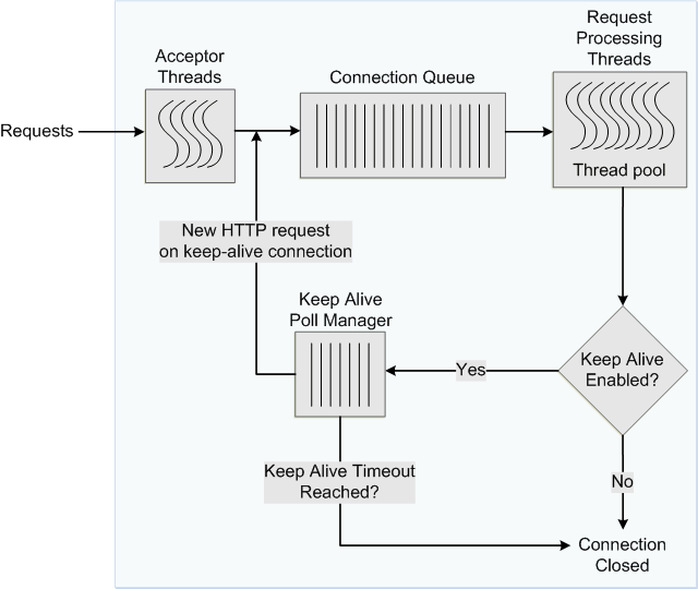

HTTP 1.0 and HTTP 1.1 support sending multiple requests over a single HTTP connection. This capability, which was called keep alive in HTTP 1.0, is called persistent connections in HTTP 1.1 and is enabled by default in Oracle Traffic Director.
Keeping a connection active even after processing the original request helps reduce the time and overhead associated with creating and closing TCP connections for future similar requests. However, keep-alive connections over which few or no requests are received are an unnecessary burden on the system.
Figure 14-2 depicts the connection handling process when keep-alive is enabled.
Figure 14-2 Connection Handling in Oracle Traffic Director with Keep Alive Enabled
To avoid this problem, you can specify the maximum number of waiting keep-alive connections. When a keep-alive request is received, if there are more open connections waiting for requests than the specified maximum number, the oldest connection is closed. In addition, you can specify the period after which inactive keep-alive connections should be closed.

If Oracle Traffic Director must run in low-memory situations, reduce the thread limit to a bare minimum by lowering the value of the Maximum Threads setting on the configuration's Performance Tab fi HTTP sub tab. You can also set it with the set-thread-pool-prop command's max-threads property.
The server automatically selects many server defaults based on the system resources, for optimal performance. However, if the server's chosen defaults are not suited to your configuration, you can override them. For more information about how to tune the server to obtain a smaller memory footprint, see Large Memory Footprint.
If your application runs out of maximum sessions as evidenced by a "too many active sessions" message in the server log file, and results in the container throwing exceptions, application performance will be impacted. To address the situation, consider the session manager properties, and the session idle time. Note that JSPs have sessions enabled by default.
The server does not allow the number of active threads to exceed the thread limit value. If the number of simultaneous requests reaches that limit, the server stops servicing new connections until the old connections are freed up. This can lead to increased response time.
In Oracle Traffic Director, the server's default maximum threads setting is greater of 128 or the number of processors in the system. If you want your server to process more requests concurrently, you need to increase the maximum number of threads.
The symptom of a server with too few threads is a long response time. Making a request from a browser establishes a connection fairly quickly to the server, but if there are too few threads on the server it can take a long time before the response comes back to the client.
The best way to tell if your server is being throttled by too few threads is to see if the number of active sessions is close to, or equal to, the maximum number of threads. To do this, see Session Creation and Thread Information.
Oracle Traffic Director automatically configures the connection queue size based on the number of available file descriptors in the system. The connection queue size on a system is determined by the sum total of thread-pool/max-threads element, thread-pool/queue-size element and keep-alive/max-connections element in the server.xml file.
In certain cases, the server's chosen defaults leads to larger memory footprint than what is required to run your applications. If the server selected defaults does not suit your needs, the memory usage of the server can be changed by specifying the values in server.xml. The thread-pool/max-threads is greater of 128 or the number of processors in the system unless explicitly specified in server.xml. The thread-pool/queue-size can be obtained from perfdump by examining the Connection Queue Information. The keep-alive/max-connections can be obtained from Keep-Alive Information and Keep-Alive Count. Logging at level fine will print these values in the error log file.

Each Oracle Traffic Director virtual server acts as a reverse proxy through which clients outside the network can access critical data and applications hosted on multiple origin servers in the back end. This section describes the parameters that you can tune to improve the performance of Oracle Traffic Director as a reverse-proxy server.
Enable keep-alive: This parameter indicates whether the Oracle Traffic Director virtual server should attempt to use persistent connections to the origin server or create a new connection for each request. It is enabled by default.
Keep-alive timeout: This parameter specifies the maximum duration, in seconds, for which a persistent connection can be kept open. The default timeout duration is 29 seconds.
Idle timeout: This parameter specifies the maximum duration, in seconds, for which a connection to the origin server can remain idle. The default duration is 300 seconds.
Always use keep-alive: This parameter indicates whether the Oracle Traffic Director virtual server can reuse existing persistent connections to origin servers for all types of requests. If this parameter is not enabled (default), the Oracle Traffic Director virtual server attempts to use persistent connections to the origin server only for the GET, HEAD, and OPTIONS request methods.
Proxy buffer size: This parameter specifies the size of the buffer in which Oracle Traffic Director stores data received from the origin server, before sending the data to the client. Larger the buffer, lower is the number of write system calls. The default size of the proxy buffer is 16 kilobytes.
