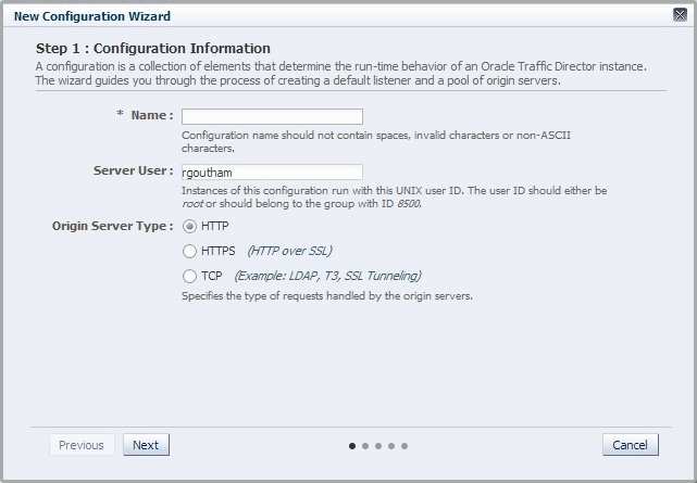

While creating a configuration by using the New Configuration wizard, you can choose to also instantiate the configuration on one or more administration nodes. The wizard enables you to do this by displaying the host names of the administration nodes that are registered with the administration server.
Creating a Configuration Using the Administration Console
To create a configuration by using the administration console, do the following tasks:

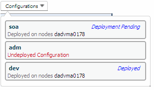

At any time, you can view a list of the available configurations by using either the administration console or the CLI.
The CLI examples in this section are shown in shell mode (tadm>). For information about invoking the CLI shell, see Accessing the Command-Line Interface.
Viewing a List of Configurations Using the Administration Console
To view a list of the available configurations by using the administration console, do the following:
You can view the properties of a configuration by clicking on its name.

A configuration can be in one of the following statuses:
Deployed: One or more instances of the configuration exist. All of the instances have the updated configuration settings.
Deployment pending: One or more instances of the configuration exist. But the instances do not have the latest configuration settings.
Undeployed: No instances exist for the configuration.
Instance modified: The settings of one or more instances of the configuration have been manually modified.
