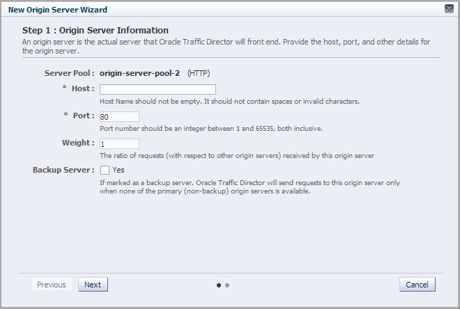

You can add an origin server to an origin-server pool by using either the administration console or the CLI.
When you add an origin server to a pool, you are, in effect, modifying a configuration. So for the updated configuration to take effect in the Oracle Traffic Director instances, you should redeploy the configuration as described in Deploying a Configuration.

Before you begin adding an origin server to a pool, decide the following:
The origin-server pool to which you want to add the origin server.
The host name or IP address of the origin server. It is recommended that the IP address that you provide is the InfiniBand interface IP address (IPoIB) or Socket Director Protocol (SDP) address.
SDP is a native Infiniband protocol. With SDP, performance is very specific to work load. Hence, it is important to evaluate and compare the performance with SDP and IPoIB, and then select the one that meets your requirement.
The port number at which the origin server listens for requests.
Whether the server is a backup origin server.
Oracle Traffic Director forwards requests to a backup origin server only when the health check indicates that none of the primary origin servers is available.
The proportion of the total request load that Oracle Traffic Director should distribute to the origin server. You define this proportion as a weight number that is relative to the weights assigned to the other origin servers in the pool.
You can use weights to get Oracle Traffic Director to distribute the request load based on the relative capacities of the origin servers in a pool.
Consider a pool consisting of three origin servers—os1, os2, and os3, with the weights 1, 2, and 2 respectively. The total of the weights assigned to all the servers in the pool is 1+2+2=5. Oracle Traffic Director distributes a fifth (1/5) of the total load to os1, and two-fifths (2/5) of the load to each of os2 and os3.
Adding an Origin Server to a Pool Using the Administration Console
To add an origin server to a pool by using the administration console, do the following:
