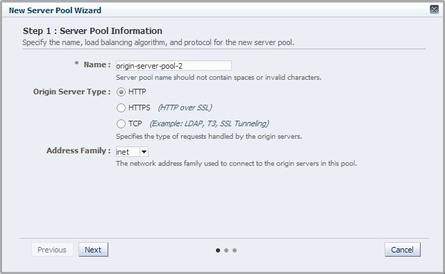

Creating an Origin-Server Pool Using the Administration Console
To create an origin-server pool by using the administration console, do the following:
