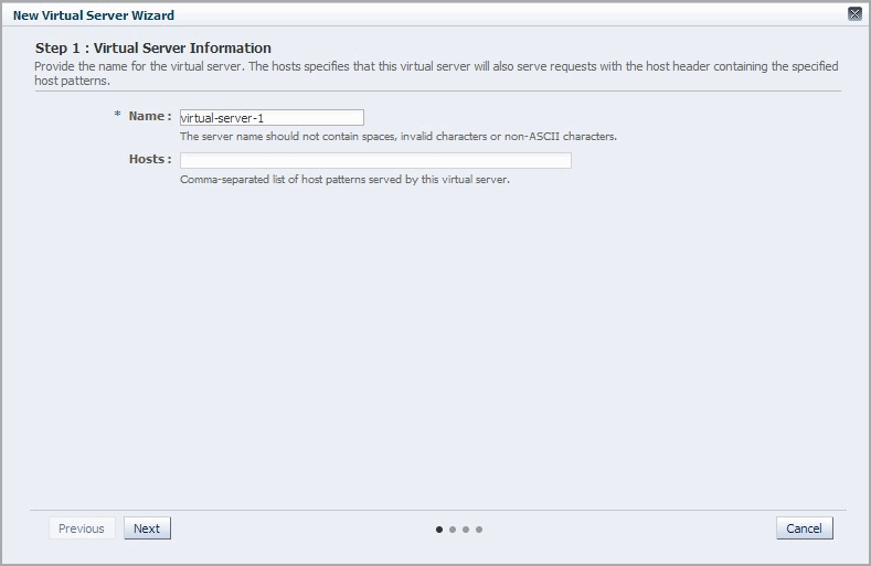

Creating a Virtual Server Using the Administration Console
To create a virtual server by using the administration console, do the following:
