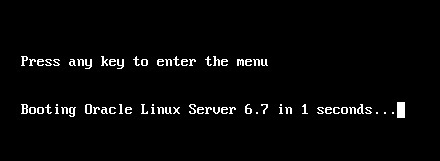

If you selected UEFI Boot Mode, the Booting Oracle Linux Server
boot screen appears. For example, for Oracle Linux 6.7:
For the purposes of this installation, do one of the following:
To do the installation in Legacy BIOS Boot Mode, accept the
default and press Enter.
To do the installation in UEFI Boot Mode, press Enter or allow the
screen to timeout.

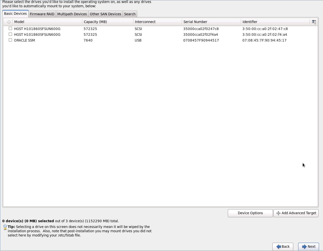

The "Please select the drive you'd like to install the operating system
on" screen appears.
Select the storage drive on to which you want to install the operating
system, scroll to the bottom of the screen, and click
Next.

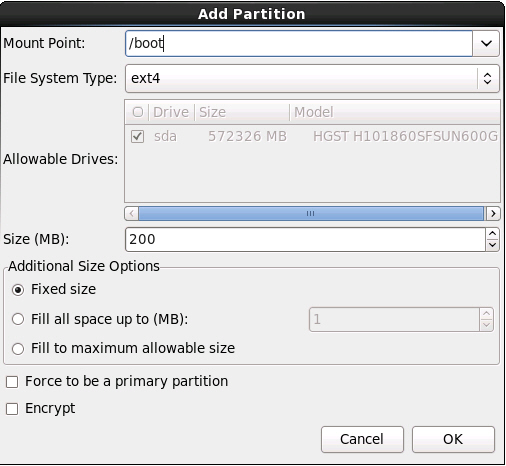

To create partitions, do the following:
Scroll to the bottom of the screen and click Create.
The Create Storage dialog appears.
Select Standard Partition, and click Create.
The Add Partition dialog appears.
In the dialog, set the Mount point to /boot and
leave the File System Type set to ext4 and the
Size (MB) set to 200.
Here is the updated Add Partition dialog.
Click OK.
The partition is created.

At first reboot after installing Oracle Enterprise Linux 6.7, press any
key to enter the menu.
The GNU GRUB screen appears.
Choose Oracle Linux Server Red Hat Compatible Kernel
(2.6.32-573.el6.x86_64)
