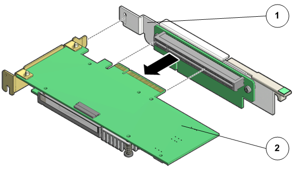

Each Pilot supports a single 6 Gb/s SAS HBA on the PCIe slot of its riser. The SAS HBA is installed in the internal PCIe 4 slot of riser 3 and is not visible from the back of the Pilot. To service a SAS HBA, the PCIe risers inside the Pilot and the filler panels inside the riser must be removed. The SAS HBA is a customer replaceable unit (CRU) and is not hot-serviceable. However, replacing a SAS HBA will require failing over all operations to the other Pilot. The following figure shows the location of the SAS HBA inside a riser board assembly.
Figure 1: SAS HBA
 | 1 Riser board assembly |
| 2 SAS HBA |
