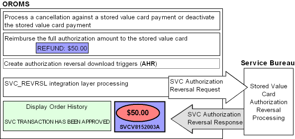

Stored Value Card Authorization Reversal Process
Purpose: The system reimburses a stored value card the original authorization amount associated with the card when you process a cancellation associated with a stored value card payment or deactivate the stored value card.
Note: If the Perform Authorization Reversal during Deposit Processing (J20) system control value is selected, when you process deposits and the deposit amount is less than the original authorization amount, the system reimburses the stored value card the difference; see Authorization Reversal Process During Deposits.
Stored Value Card Authorization Reversal Process:
1. |
You process a cancellation associated with a stored value card payment or deactivate the stored value card. You can process a cancellation by: • Selecting Cancel for an order line or selecting Cancel to cancel the entire order in order maintenance. • Selecting Void All/Cancel Order to void the pick slip and cancel the order at the Reprint/Void Pick Slips by Order Screen. • Selecting Cancel Group to cancel a group of order lines based on the cancellation date or item in the Working with Backorders Pending Cancellation (WBPC) menu option. • Processing soldout cancellations by submitting the job using the Processing Auto Soldout Cancellations (MASO) menu option or by selecting Sell Out for an order line in order maintenance. • Submitting a job to cancel orders flagged for cancellation due to credit card decline using the Working with Credit Card Cancellations (WCCC) menu option. • Submitting a job to cancel order lines for a given item and adding a substitute item to each order using the Processing Item Substitutions (PSUB) menu option. • Cancelling an order line or order on the web storefront using the Maintenance E-Commerce Process. You can deactivate a stored value card payment by selecting Deactivate for a stored value card payment at the Enter Payment Method Screen. |
2. |
The system determines if the order is eligible for stored value card authorization reversal. For an order to be eligible for stored value card authorization reversal, the order must: • contain a stored value card payment method that is associated with a cancellation or deactivation. Stored value card payments have a Pay category of Credit Card and a Card type of Stored Value. • have an open, unused authorization remaining for the stored value card. An open, unused authorization is an authorization that is: • in an A (authorized) or O (authorized, but not used) status • not associated with an outstanding pick slip for the order • not partially confirmed or deposited. Authorizations in sent status: When you process a cancellation or deactivate a stored value card payment and the authorization is in an S (sent, but not received) status, the system does NOT create a SVC authorization reversal for the payment even if you later receive an approved authorization response. Expired authorizations: If the original authorization for an order is expired and the order received a new authorization during pick slip generation, the system will create an authorization reversal against the expired authorization when you process deposits. However, the service bureau will reject this authorization reversal since they have already expired the authorization and reimbursed the stored value card. |

3. |
The system creates an authorization reversal for the original authorization amount, not the actual amount of the reversal. |
4. |
The system creates a record in the Auth History SVC Reversal table for the authorization amount to reimburse. |

5. |
The system creates an authorization reversal download trigger for the stored value card authorization reversal. You can view all download triggers in the IL Outbound Trigger table at the Work with Outbound Interface Transactions screen. Each authorization reversal download trigger in the IL Outbound Trigger table contains a: • File code: indicating the type of information to download and which IL process job processes the trigger. For authorization reversal download triggers, the File code is AHR. • Key: indicating the specific record to download. For AHR download triggers, the Key identifies the specific company, order number, order payment method sequence number, authorization sequence number, and authorization reversal sequence number in the SVC Authorization Reversal table. For example, the Key 55500006794001001001 indicates the authorization reversal information is located in company 555 for order number 6794, order payment method sequence number 001, authorization sequence number 001, and authorization reversal sequence number 001. • Capture type: indicating the type of activity performed against the record. AHR download triggers are always capture type A indicating the authorization reversal was created. |
6. |
Looks at the Authorization service field defined for the stored value card payment to determine the service bureau used to process the authorization reversal. |
7. |
The system looks for unprocessed AHR download triggers to process, based on the setting of the Use Activation / Reversal Batch Processing (I50) system control value. • If this system control value is selected, the system does not process the stored value card trigger records until you submit the batch process using the Transmitting Activation and Reversal Transactions (SSVC) menu option or the SVCREV periodic function (program name PFR0077). • If this system control value is unselected, the SVC Activation and SVC Reversal integration layer jobs monitor for stored value card download trigger records to process at defined intervals, based on the Outbound delay time. The system: • looks for AHR download triggers with the File code AHR and a status of ready (R). • determines which stored value card authorization reversal to download, based on the Key field for the authorization reversal download trigger. |
8. |
For each authorization reversal download trigger, the system generates a Stored Value Card Authorization Reversal Request. |
9. |
The system looks at the Communication type field for the service bureau to determine how transactions are processed between Oracle Retail Order Management System and the service bureau. • Integration Layer = The system sends authorization reversal transactions to the service bureau using the queues defined for the authorization reversal integration layer job. • Payment Link = Point-to-point integration. The system sends authorization reversal transactions to the service bureau using a point-to-point integration. You must define communication settings in Working with Customer Properties (PROP). The system does not use an integration layer job to communicate with the service bureau; however, the system uses the job to process authorization reversal triggers. Note: This option is available for the Customer Engagement Stored Value Card Integration. See Processing Authorization Reversals Using Payment Link Communication. |
Processing Authorization Reversals Using Payment Link Communication If the Communication type field for the service bureau is Payment Link: • Oracle Retail Order Management System sends the authorization reversal request in the format of the other system. If you are using the Customer Engagement Stored Value Card Integration, the system sends the Oracle Retail Customer Engagement Void Request to the Oracle Retail Customer Engagement system. • The service bureau receives the Authorization Reversal Request, processes the authorization reversal, and sends a response back to Oracle Retail Order Management System. If you are using the Customer Engagement Stored Value Card Integration, the system receives the authorization reversal response from Oracle Retail Customer Engagement in the Oracle Retail Customer Engagement Void Response message. |
10. |
Oracle Retail Order Management System processes the authorization reversal response accordingly. See: • What Happens When the Authorization Reversal is Approved? • What Happens When the Authorization Reversal is Declined? • When Communication Failures Occur Note: Stored value card authorization reversal responses contain a Response code and Response date, but may not contain an Authorization code. In this case, if the Response code is 100, the system updates the Authorization code with a dummy authorization number so that the authorization reversal is approved. |
An authorization reversal is approved if the Authorization Reversal Response message contains an authorization number. In this case, the system:
• updates the associated record in the Integration Process Control table to CMP complete (if the Communication type field for the service bureau is Integration Layer).
• updates the associated record in the SVC Authorization Reversal table with the approval date, approval time, and reversal response.
• creates an order transaction history message indicating the authorization reversal was approved: Reversal Has Been Approved.
• voids the authorization history record.
Note: If the stored value card authorization reversal response contains an amount, the system ignores the amount sent back and continues to use the amount from the Auth History SVC Reversal table.
You can review the stored value card authorization reversal at the Display Authorization Reversals Screen. The approved reversal will have a Response and an Approval date and time.
