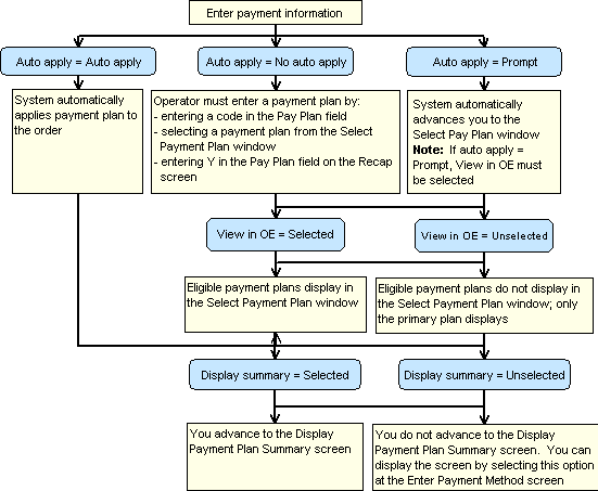

Plan (Deferred or installment payment plan code)
A code that represents the deferred or installment payment plan you wish to assign to this order. An order is eligible for a payment plan only if it uses a credit card whose Card type is Credit Card) rather than, for example, a stored value card. See Types of Credit Cards for more information.
Included only if the Deferred and Installment Billing (F51) system control value is selected.
If an operator does not have authority to the Override Deferred and Installment Billing Options (A81) secured feature, this field is display-only.
An error message indicates if an operator enters a payment plan code and the order is not eligible.
See Assigning a Payment Plan to the Order on how the system determines the payment plan to assign to the order.
Payment plans are defined in and validated against the Flexible Payment Option table. See Working with Flexible Payment Options (WFPO).
Alphanumeric, 5 positions; optional.

Setting up a payment plan: These fields in the Flexible Payment Option table determine how an eligible payment plan is assigned to an order.
• Is the payment plan automatically applied to the order? If the Auto apply field for the payment plan is set to:
- 1 (auto apply), the system automatically applies the most eligible payment plan to the order.
- 2 (no auto apply), the system does not automatically apply a payment plan to the order. You can apply a payment plan to the order by selecting the Pay plan field on the Work with Order/Recap Screen, entering a payment plan code in the Pay plan field on the Enter Payment Method screen, or by selecting a payment plan from the Select Payment Plan pop-up window.
- 3 (prompt), the system advances you to the Select Payment Plan Window where you can select a payment plan to apply to the order.
Note: In order to make payment plan selection easier, each payment plan should have the same Auto apply setting.
• Is the payment plan viewable in order entry and order maintenance? If the View in oe/om field for the payment plan is selected and the order is eligible for the payment plan, the plan is indicated in the Select Payment Plan Window. If this field is unselected, the plan does not display in the Select Payment Plan pop-up window; however, you can still apply this plan to the order by entering the code in the Pay plan field. The system also displays the primary payment plan in this window regardless of the setting of this field.
• Do you advance to the Display Payment Plan Summary screen? If the Display summary field for the payment plan is selected, the system advances you to the Display Payment Plan Summary Screen when a payment plan is assigned to the order. If this field is unselected, the system does not advance you to the Display Payment Plan Summary Screen, but you can display this screen upon request by using option Pay Plan Summary on the Enter Payment Method Screen.
Purpose: Use this window to assign a payment plan to the order. This window lists all payment plans that are eligible for this order and are set up to:
• prompt in order entry (the Auto apply field in the Flexible Payment Option table is set to 3) and as viewable in order entry (the View in oe/om field in the Flexible Payment Option table is selected).
• not automatically apply in order entry (the Auto apply field in the Flexible Payment Option table is set to 2) and as viewable in order entry (the View in oe/om field in the Flexible Payment Option table is selected).
Note: The primary payment plan is indicated in the Select Payment Plan window regardless of the value defined in the View in oe/om field.
For more information: See Working with Flexible Payment Options (WFPO).
How to display this window:
• enter a credit card payment type for the order on the Enter Payment Method Screen or Work with Order/Recap Screen if the Auto apply field for the payment plan is set to prompt.
• click on the arrow in the Pay plan field on the Enter Payment Method Screen or Work with Order/Recap Screen.
