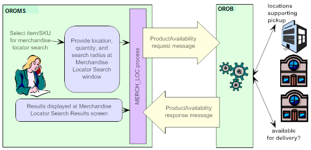

Overview: A typical process of inquiring on locations where an item is available for pickup, as well as whether the item is available for shipment from a location, is described below.
1. |
A customer wants to know if an item/SKU is available for pickup at a nearby store or available for shipment from a store location. You select the item/SKU for merchandise locator inquiry. This option is available in order entry, order maintenance, and at the Display Item Availability Screen. |
2. |
You advance to the Merchandise Locator Search Window (Searching for an Item), where you provide or confirm the customer’s geographic location, the requested quantity of the item, and the radius to search within (for example, search all stores within 25 miles of the customer’s home). Note: The Order Broker supports merchandise locator searches only in the U.S. and Canada. |
3. |
In the background, the MERCH_LOC process: • Generates the ProductAvailability request message and sends it to Order Broker. Order Broker checks the availability of the item in stores that stock the item/SKU within the search area, as well as whether the item is available for shipment at any store locations within the same search area. • Receives the ProductAvailability response returned by Order Broker. This message lists: - the item/SKU’s current or estimated availability in each searched location that stocks the item for pickup - an indicator of whether the requested quantity of the item/SKU is available for shipment within the search area |
4. |
You advance to the Merchandise Locator Search Results Screen, displaying the item/SKU’s availability for pickup in each of the locations, including information on any open purchase orders. The screen also indicates whether the requested quantity of the item/SKU is available for delivery from a store within the same search area. |
Purpose: Use this window to check availability for an item across external locations, such as retail stores, typically through Order Broker. To search, you need to specify the customer’s location, either by city and state or postal code, the search radius, and a search quantity.
Address defaults: If you advance to this window in order entry or order maintenance, the customer’s address information defaults. Also, if you have overridden the address information in order entry or order maintenance, the system continues to default the override information until you are working with a different customer. For example, if you perform a search using the customer’s work address for an item/SKU, and then select another item/SKU for a search while working with the same order, the customer’s work address defaults.
How to display this window: Select Merch locator for an item at the:
• Work with Order Lines Screen (Adding Items to the Order)
• Display Item Availability Screen
Note: This option is available only if:
- The Use Merchandise Locator (I38) system control value is selected. Otherwise, the screen displays an error message: Merchandise Locator is not enabled. Also, merchandise locator searching is not available for all items; see Merchandise Locator for Different Types of Items for a listing of items that are not eligible.
- You have not already selected a quantity of the item to add to the current order at the Display Item Availability Screen in order entry. Otherwise, the screen displays an error message: Option not allowed since item already selected.
Important: The Order Broker Order Broker supports merchandise locator searches only within the U.S. and Canada.
The merchandise locator search is an inquiry only, and does not create or update an order. See the Order Broker Integration for information on submitting a brokered backorder, store pickup, or ship-for-pickup order to Order Broker.
Field |
Description |
Item |
The item selected at the previous screen. The SKU information, if any, is to the right. Item code: alphanumeric, 12 positions; display-only. SKU: alphanumeric, three 4-position fields; display-only. |
Item description |
The description of the item. Even if the item has SKUs, the item description is displayed. Alphanumeric, 40 positions; display-only. |
Note: If you advanced to this window from order entry or order maintenance, the customer’s address information defaults. |
Postal code |
The customer’s U.S. zip or Canadian postal code, to serve as the central point for the search radius. For example, if the Search within field is set to 25 miles, the search includes stores within 25 miles of this postal code. The search radius applies only to locations that use proximity rules. You might set up Order Broker so that proximity rules apply to stores only and not warehouses. Note: Your entry in this field is not validated against the Zip/City/State table. Alphanumeric, 10 positions; required if you do not enter a city and state. |
Address |
The customer’s street address, to serve as the central point for the search radius. The search radius applies only to locations that use proximity rules. You might set up Order Broker so that proximity rules apply to stores only and not warehouses. Alphanumeric, 32 positions; optional. |
City |
The customer’s city, to serve as the central point for the search radius. The search radius applies only to locations that use proximity rules. You might set up Order Broker so that proximity rules apply to stores only and not warehouses. Alphanumeric, 25 positions; required if you do not enter a postal code. |
State |
The customer’s U.S. state or Canadian province, to identify the location of the city. The search radius applies only to locations that use proximity rules. You might set up Order Broker so that proximity rules apply to stores only and not warehouses. Alphanumeric, 2 positions; required if do not enter a postal code. |
Country |
The customer’s country. The country defaults from the customer address if you advanced to this window from order entry or order maintenance; otherwise, it defaults from the Default Country for Customer Address (B17) system control value. Defined in and validated against the Country table; see Setting Up the Country Table (WCTY) for more information. The search radius applies only to locations that use proximity rules. You might set up Order Broker so that proximity rules apply to stores only and not warehouses. Alphanumeric, 2 positions; required. |
Search quantity |
The requested quantity of the item. Defaults to 1. Numeric, 7 positions; required. |
Indicates the search radius, in miles or kilometers, to search within for the selected item. The search radius defaults from the Default Search Within Radius (I40) system control value, but you can override it. Note: • The search radius applies only to locations that use proximity rules. You might set up Order Broker so that proximity rules apply to stores only and not warehouses. • The distance unit of measure (miles or kilometers) specified with the Merchandise Locator Distance Measurement (I39) system control value is displayed to the right. • Typically, a search for a delivery location can use a broader search radius than a search for a pickup location, which is generally within driving distance. To see if the item is available for delivery as opposed to pickup, you might search twice, specifying a different search radius when determining if the item is available for delivery. Numeric, 5 positions; required. |
Completing this window:
• If they have not already defaulted, indicate the postal code or the city and state to serve as the central point for the search radius.
• Optionally, override the Search quantity.
• Optionally, override the Search within radius to a different distance.
• Click OK. The system generates the ProductAvailability request message. See Sample ProductAvailability Messages for more information.
When the system receives the response message, you advance to the Merchandise Locator Search Results Screen.
