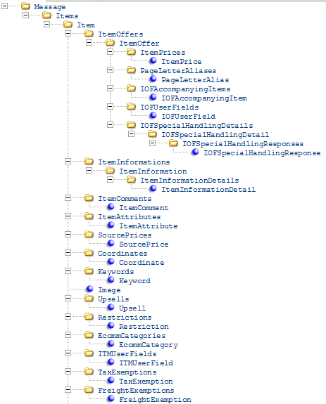

For each item download trigger, the Item Outbound message builder determines which elements to include in the item download message, based on XML inclusion rules.
You can define Item Outbound XML inclusion rules at the Outbound Interface XML Inclusion Screen.
XML inclusion defines which elements to include in the item download message.
• If the element is included, that element and its parents are included in the generated item download XML message.
• If the element is excluded, that element and its children are excluded from the generated item download message.
This table indicates which elements in the item download message are included, based on which elements you flag to include or exclude.
Include element in XML message? |
Element |
Selected = Include Item Unselected = Exclude Item and all of its children; the system sends a message with only the Message element and its attributes |
Item |
Selected = Include ItemOffer and its parent Item Unselected = Exclude ItemOffer and its children ItemPrice, PageLetterAlias, IOFAccompanyingItem, IOFUserField, IOFSpecialHandlingDetail and IOFSpecialHandlingResponse |
ItemOffer |
Selected = Include ItemPrice and its parents, ItemOffer and Item Unselected = Exclude ItemPrice |
ItemPrice |
Selected = Include PageLetterAlias and its parents ItemOffer and Item Unselected = Exclude PageLetterAlias |
PageLetterAlias |
Selected = Include IOFAccompanyingItem and its parents ItemOffer and Item Unselected = Exclude IOFAccompanyingItem |
Selected = Include IOFUserField and its parents ItemOffer and Item Unselected = Exclude IOFUserField |
IOFUserField |
Selected = Include IOFSpecialHandlingDetail and its parents ItemOffer and Item Unselected = Exclude IOFSpecialHandlingDetail and its child IOFSpecialHandlingResponse |
IOFSpecialHandlingDetail |
Selected = Include IOFSpecialHandlingResponse and its parents IOFSpecialHandlingDetail, ItemOffer, and Item Unselected = Exclude IOFSpecialHandlingResponse |
Selected = Include ItemComment and its parent Item Unselected = Exclude ItemComment |
ItemComment |
Selected = Include ItemAttribute and its parent Item Unselected = Exclude ItemAttribute |
ItemAttribute |
Selected = Include SourcePrice and its parent Item Unselected = Exclude SourcePrice |
SourcePrice |
Selected = Include Coordinate and its parent Item Unselected = Exclude Coordinate |
Coordinate |
Selected = Include Keyword and its parent Item Unselected = Exclude Keyword |
Keyword |
Selected = Include Image and its parent Item Unselected = Exclude Image |
Image |
Selected = Include Restriction and its parent Item Unselected = Exclude Restriction |
Restriction |
Selected = Include ITMUserField and its parent Item Unselected = Exclude ITMUserField |
ITMUserField |
Selected = Include TaxExemption and its parent Item Unselected = Exclude TaxExemption |
TaxExemption |
Selected = Include FreightExemption and its parent Item Unselected = Exclude FreightExemption |
FreightExemption |

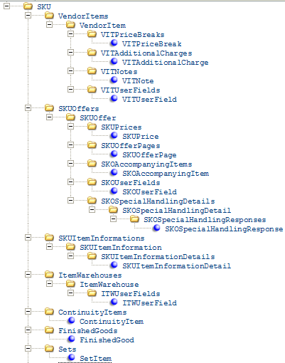

Selected = Include SKU and its parent Item Unselected = Exclude SKU and all of its children VendorItem, SKUItemInformation, ItemWarehouse, FinishedGood, SetItem, VariableSet, SKUComment, SKUAttribute, UPC, SKUUserField |
SKU |
Selected = Include VendorItem and its parents SKU and Item Unselected = Exclude VendorItem and its children VITPriceBreak, VITAdditionalCharge, VITNote, and VITUserField |
VendorItem |
Selected = Include VITPriceBreak and its parents VendorItem, SKU, and Item Unselected = Exclude VITPriceBreak |
VITPriceBreak |
Selected = Include VITAdditionalCharge and its parents VendorItem, SKU, and Item Unselected = Exclude VITAdditionalCharge |
VITAdditionalCharges |
Selected = Include VITNote and its parents VendorItem, SKU, and Item Unselected = Exclude VITNote |
VITNote |
Selected = Include VITUserField and its parents VendorItem, SKU, and Item Unselected = Exclude VITUserField |
VITUserField |
Selected = Include SKUOffer and its parents SKU and Item Unselected = Exclude SKUOffer and its children SKUPrice, SKUOfferPage, SKOAccompanyingItem, SKOUserField, and SKOSpecialHandlingDetail |
SKUOffer |
Selected = Include SKUPrice and its parents SKUOffer, SKU and Item Unselected = Exclude SKUOfferPage |
SKUPrice |
Selected = Include SKUOfferPage and its parents SKUOffer, SKU, and Item Unselected = Exclude SKUOfferPage |
SKUOfferPage |
Selected = Include SKOAccompanyingItem and its parents SKUOffer, SKU, and Item Unselected = Exclude SKOAccompanyingItem |
Selected = Include SKOUserField and its parents SKUOffer, SKU, and Item Unselected = Exclude SKOUserField |
SKOUserField |
Selected = Include SKOSpecialHandlingDetail and its parents SKUOffer, SKU, and Item Unselected = Exclude SKOSpecialHandlingDetail and its child SKOSpecialHandlingResponse |
Selected = Include SKOSpecialHandlingResponse and its parents SKOSpecialHandlingDetail, SKUOffer, SKU, and Item Unselected = Exclude SKOSpecialHandlingResponse |
Selected = Include SKUItemInformation and its parents SKU and Item Unselected = Exclude SKUItemInformation and its child SKUItemInformationDetail |
SKUItemInformation |
Selected = Include SKUItemInformationDetail and its parents SKUItemInformation, SKU, and Item Unselected = Exclude SKUItemInformationDetail |
Selected = Include ItemWarehouse and its parents SKU and Item Unselected = Exclude ItemWarehouse and its child ITWUserField |
ItemWarehouse |
Selected = Include ITWUserField and its parents ItemWarehouse, SKU, and Item Unselected = Exclude ITWUserField |
ITWUserField |
Selected = Include FinishedGood and its parents SKU and Item Unselected = Exclude FinishedGood |
FinishedGood |
Selected = Include SetItem and its parents SKU and Item Unselected = Exclude SetItem |
SetItem |
Selected = Include VariableSet and its parents SKU and Item Unselected = Exclude VariableSet and its children VariableSetGroup and VariableSetItem |
VariableSet |
Selected = Include VariableSetGroup and its parents VariableSet, SKU, and Item Unselected = Exclude VariableSetGroup and its child VariableSetItem |
VariableSetGroup |
Selected = Include VariableSetItem and its parents VariableSetGroup, VariableSet, SKU, and Item Unselected = Exclude VariableSetItem |
VariableSetItem |
Selected = Include SKUComment and its parents SKU and Item Unselected = Exclude SKUComment |
SKUComment |
Selected = Include SKUAttribute and its parents SKU and Item Unselected = Exclude SKUAttribute |
SKUAttribute |
Selected = Include UPC and its parents SKU and Item Unselected = Exclude UPC |
UPC |
Selected = Include SKUUserField and its parents SKU and Item Unselected = Exclude SKUUserField |
SKUUserField |

• Delete transactions contain all elements (based on XML inclusion rules) since an item can be identified using fields other than Item number and SKU code.
• For non-SKU’d items, the SKU element does not include the SKU_Code attribute. The following elements are not included for non-SKU’d items:
- SKUOffer and its children, SKUPrice, SKUOfferPage, SKOAccompanyingItem, SKOUserField, SKOSpecialHandlingDetail, SKOSpecialHandlingResponse.
- SKUItemInformations and its children, SKUItemInformation, SKUItemInformationDetails, and SKUItemInformationDetail.
- SKUComments and its child, SKUComment.
- SKUAttributes and its child, SKUAttribute.
- SKUUserFields and its child, SKUUserField.

The ItemComment element repeats for each item comment defined for the item in the SKU Comments table. |
Seq_Nbr |
numeric |
3 |
The sequence number assigned to the item comments. From the Seq # field in the SKU Comments table. |
Comment_line |
alpha |
50 |
The comments entered for the item. From the Comment field in the SKU Comments table. |
Print_code |
alpha |
1 |
Indicates where to print or display the item comments. • B = Print on the pick slip and on the invoice, if supported by your unique invoice print program. • N = Do not print. • P = Print on pick slip. • R or blank = Print on reports. This option is not currently implemented. • I = Print on the invoice, if your unique invoice print program supports it. • W = Display on pop-up window when you select an item to add to an order. From the Print code field in the SKU Comments table. |
The ItemAttribute element repeats for each item attribute defined for the item in the Item Attribute table. |
IAT_Type |
alpha |
6 |
A code that identifies an item attribute. From the Type field in the Item Attribute table. |
IAT_Description |
alpha |
30 |
A description of the item attribute type. From the Description field in the Item Attribute table. |
IAV_Value |
alpha |
6 |
A code that identifies an attribute value. From the Value field in the Item Attribute Value table. |
IAV_Description |
alpha |
30 |
A description of the attribute value. From the Description field in the Item Attribute Value table. |
The SourcePrice element repeats for each source price for the item in the Special Pricing by Source table. |
SRC_Source_code |
alpha |
9 |
The source code associated with special price breaks for items by source code. From the SRC source code field in the Special Pricing By Source table. |
SPS_Qty |
numeric |
5 |
The number of units of the item that the customer must purchase to receive the special price. From the SPS quantity field in the Special Pricing by Source table. |
SPS_Price |
numeric |
7.2 |
The special price for the item, quantity, and source code. From the SPS price field in the Special Pricing By Source table. |
SPS_Associate_price |
numeric |
7.2 |
The special price for the item for associate customers. From the SPS associate price field in the Special Pricing By Source table. |
SPS_Tax_price |
numeric |
7.2 |
The special price of the item if the order is subject to VAT. From the Tax incl price field in the Special Pricing By Source table. |
SPS_Associate_tax_price |
numeric |
7.2 |
The special price of the item for associate customers if the order is subject to VAT. From the Tax inclusive associate price field in the Special Pricing By Source table. |
The Coordinate element repeats for each coordinate for the item in the Item Coordinate table. |
ICN_Coordinate_item |
alpha |
12 |
The related item coordinated to the primary item for cross-selling purposes. From the Coordinate item field in the Item Coordinate table. |
ICN_Message |
alpha |
70 |
The persuasive or descriptive message to display for the coordinate item. From the Message field in the Item Coordinate table. |
ICN_Sequence |
numeric |
3 |
The sequence number assigned to the item coordinate type, indicating the sequence in which the Display Coordinate Items window displays coordinate items assigned to this type in order entry. From the Seq field in the Item Coordinate table. |
ICN_Coordinate_type |
alpha |
2 |
A code representing a type of item coordinate, such as mandatory or optional. From the Type field in the Item Coordinate table. |
The Keyword element repeats for each keyword for the item in the Keyword table. |
KWD_Type |
alpha |
1 |
Indicates whether the word is created as a keyword for the item. • I = Include the word as a keyword for the item. • E = Do not include the word as a keyword for the item; for example, you may want to exclude words such as “the” and “with.” From the KWD type field in the Keyword table. |
KWD_KeywordExclusion |
alpha |
20 |
The word you wish to include or exclude as a keyword, based on the Type field. From the KWD keyword/exclusion field in the Keyword table. |
ECI_Thumbfile_Picture |
alpha |
255 |
Not implemented. |
ECI_Regular_Picture |
alpha |
255 |
Not implemented. |
ECI_Large_Picture |
alpha |
255 |
Not implemented. |
The Restriction element repeats for each item restriction defined for the item in the Item Restriction by Country/State table. |
RPR_Country |
alpha |
3 |
A country to which you cannot ship the item, or to which one or more states have shipping restrictions for the item. From the RPR country field in the Item Restriction by Country/State table. |
NAM_State |
alpha |
2 |
A state which has a shipping restriction for the item. From the NAM state field in the Item Restriction by Country/State table. |
The ITMUserField element repeats for each item user field defined for the item in the Item User Field table. |
ITM_UDF_Sequence_Nbr |
numeric |
3 |
The sequence number assigned to the item user field. From the Seq# field in the Item User Field table. |
ITM_UDF_Text |
alpha |
30 |
The text defined for the item user field. From the Text field in the Item User Field table. |
ITM_UDF_Number |
numeric |
16 |
The number defined for the item user field. From the Number field in the Item User Field table. |
ITM_UDF_Date |
numeric |
7 |
The date defined for the item user field. From the Date field in the Item User Field table. |
ITM_UDF_Display_sequence |
numeric |
3 |
The sequence number assigned to the item user field, controlling its placement on the screen. From the Display sequence field in the Item User Field table. |
ITM_UDF_File_code |
alpha |
3 |
The code representing the table to which the user-defined field is linked. For item user fields, the file code is ITM. From the ITM UDF file code field in the Item User Field table. |
UDD_Field_label |
alpha |
15 |
The field label that appears on a screen for the item user field. From the Field label field in the User Defined Field Detail table. |
UDD_Field_type |
alpha |
1 |
A code that identifies the type of field. • D = Date field. • N = Number field. • T = Text field. From the Field type field in the User Defined Field Detail table. |
UDD_Field_usage |
alpha |
1 |
A code that identifies whether you are collecting the field information for the user-defined field. • I (Input) = you can enter information in this field. • O (output) = you cannot enter information in this field. From the Field usage field in the User Defined Field Detail table. |
The TaxExemption element repeats for each tax exemption defined for the item in the Item Tax Exempt table. |
ITE_State |
alpha |
2 |
A code that represents the state in which an item tax exemption applies. From the ITE state field in the Item Tax Exempt table. |
ITE_Seq_Nbr |
numeric |
3 |
The sequence number assigned to the item tax exemption. From the Seq # field in the Item Tax Exempt table. |
ITE_Tax_value |
numeric |
9.2 |
The dollar value up to which the item is taxable. The portion of the item price above this value is tax exempt. From the ITE tax value field in the Item Tax Exempt table. |
ITE_No_tax_value |
numeric |
9.2 |
The dollar value that is tax exempt. If the item price is this value or less, the item is tax exempt. If the item price is greater than this value, the item is taxable in full. From the ITE no tax value field in the Item Tax Exempt table. |
ITE_Exempt |
alpha |
1 |
A code indicating whether the item is tax exempt. • Y = the item is tax exempt. • N = the item is not tax exempt. From the Exempt? field in the Item Tax Exempt table. |
The FreightExemption element repeats for each freight exemption defined for the item in the Freight Exemption table. |
FEF_Sequence_Number |
numeric |
5 |
The sequence number assigned to the item freight exemption. From the FEF sequence number field in the Freight Exemption table. |
Offer_Number |
alpha |
3 |
The offer in which the item is exempt from freight. From the Offer number field in the Freight Exemption table. |
SRC_Source_code |
alpha |
9 |
The source code in which the item is exempt from freight. From the SRC source code field in the Freight Exemption table. |
Each item download message contains one Item element and one SKU element. For example, if you update a SKU’ed item, the system generates a separate item download message for each SKU. |

The SKUOffer element repeats for each SKU offer record defined for the SKU in the SKU Offer table. |

The SKUPrice element repeats for each SKU price record defined for the SKU in the SKU Price table. |

The SKUOfferPage element repeats for each SKU offer page record defined for the SKU in the SKU Offer Page table. |

The SKOAccompanyingItem element repeats for each accompanying item record defined for the SKU in the Accompanying Item table. |

The SKOUserField element repeats for each SKU offer user field record defined for the SKU in the SKU Offer User Field table. |

The SKOSpecialHandlingDetail element repeats for each special format detail record defined for the SKU offer in the Special Format Details table. |

The FinishedGood element is included only if the item is defined as a finished good item (the Kit_type attribute is set to F). The FinishedGood element repeats for each finished good component defined for the SKU in the Kit Details table. |
SeqNbr |
numeric |
5 |
The sequence number assigned to the kit detail. From the Seq# field in the Kit Detail table. |
Qty |
numeric |
5 |
The number of items that are used to make up the finished good. From the Qty field in the Kit Detail table. |
Kit_Comp_ITM_Number |
alpha |
12 |
A component item that makes up the finished good. From the Kit comp ITM number field in the Kit Detail table. |
Kit_Comp_SKU_Code |
alpha |
14 |
The SKU of the component item that makes up the finished good. From the Kit comp SKU code field in the Kit Detail table. |
The SetItem element is included only if the item is defined as a set item (the Kit_type attribute is set to S). The SetItem element repeats for each set component defined for the SKU in the Set Details table. |

The VariableSet element and its children, VariableSetGroup and VariableSetItem, is included only if the SKU is defined as a variable set (the Kit_type attribute is set to V). |
VSE_Create_coord_group |
alpha |
1 |
From the Create coord group? field in the Variable Set table. |
The VariableSetGroup element repeats for each variable set group defined for the SKU in the Variable Set Group table. |

The UPC element repeats for each UPC code defined for the SKU in the Item UPC table. |
UPC_Type |
alpha |
3 |
The type of UPC code. The UPC type determines the type of validation performed against the UPC code. • E13 = EAN-13; 13 position UPC code. • E8 = EAN-8; 8 position UPC code. • UA = UPC-A; 12 position UPC code. • UE = UPC-E; 6 position UPC code. From the UPC type field in the Item UPC table. |
UPC |
alpha |
14 |
The UPC code defined for the SKU. From the UPC field in the Item UPC table. |

The SKUUserField element repeats for each SKU user field defined for the SKU in the SKU User Field table. |

Item Download Message: Sample XML
A sample of the Item Download XML Message (CWItemOut) is presented below.
<Message source="RDC" target="IDC" type="CWITEMOUT">
<Items>
<Item Allow_SKUs="Y" Buyer="HEB" Buyer_Name="HANNAH BROWN" Company="6" Drop_ship_item="N" ITM_Allow_Pct_discount="Y" ITM_Create_Date="1081014" ITM_Description="GEL PEN" ITM_Exclude_From_Flex_Pay="N" ITM_Membership="N" ITM_Oversize_flag="N" ITM_Royalty="N" Item_Number="GEL2000" Non-inventory="N" Serial_Nbr_tracking="N" Standard_cost="1.2340" Transaction_type="C" UOM_Description="EACH" UOM_Units="1" Unit_of_measure="EA" VIA_Ship_via_code="0" Vendor_Nbr="12">
<ItemOffers>
<ItemOffer Freight="2.12" Gift_wrap_flag="Y" Gift_wrap_price="1.12" Hidden_freight="2.12" IOF_Coupon_Disc_dlr="1.12" IOF_Coupon_Effective_Date="1100101" IOF_Required_Add_Reason="N" IOF_Volume_Discount_YN="N" IOF_Warranty_Item="N" Offer_Number="OFR" SH_price="2.12" Special_handling="Y">
<ItemPrices>
<ItemPrice Associate_price="9.12" Effective_date="1081001" Price="10.12" Qty="1" />
</ItemPrices>
</ItemOffer>
</ItemOffers>
<SourcePrices>
<SourcePrice SPS_Associate_price="0.11" SPS_Price="0.12" SPS_Qty="100" SRC_Source_code="SOURCE" />
</SourcePrices>
<Keywords>
<Keyword KWD_KeywordExclusion="GEL" KWD_Type="I" />
<Keyword KWD_KeywordExclusion="WRITER" KWD_Type="I" />
</Keywords>
<SKU List_price="2.23" Location="PRIM1" Lowest_price="0.12" Restrict_orders="N" SKU_Average_Cost="1.2345" SKU_Code="BLUE " SKU_Create_Date="1081014" SKU_Cubing_value_override="5.0" SKU_Description="BLUE" SKU_Element_1_Code="BLUE" SKU_Element_1_Desc="BLUE" SKU_Element_1_Name="COLR" SKU_Element_2_Code="" SKU_Element_2_Name="SIZE" SKU_Element_3_Code="" SKU_Element_3_Name="OTHR" SKU_Gift_certificate="N" SKU_Original_Retail_Price="5.12" SKU_Returnable="N" SKU_Subscription="N" SKU_Suppress_BO_Card="N" Sale_credit_flag="N" Selling_weight_override="2.120" Short_SKU="760" Warehouse="1" Warehouse_name="MAIN WAREHOUSE LOCATION" Weight_override="1.120">
<VendorItems>
<VendorItem Cubic_volume="1" Description="BLUE" Item="VGEL2000" Lead_days="1" Minimum_qty="1" Price="1.2345" Ship_weight="1.230" UOM_Description="EACH" UOM_Units="1" Unit_of_measure="EA" VIT_Upload_frt_dlr_limit="100.12" VIT_Upload_hnd_dlr_limit="90.12" VIT_Upload_other_dlr_limit="80.12" VIT_Vend_ord_qty_multiple="1" Vendor_Nbr="12" />
</VendorItems>
<SKUOffers>
<SKUOffer Freight="3.12" Gift_wrap_flag="Y" Gift_wrap_price="4.12" Hidden_freight="2.12" Offer_Number="OFR" Page_Nbr="32" SH_price="5.12" SKO_Coupon_discount_dlr="2.12" SKO_Coupon_effective_date="1121212" SKO_Required_Add_Reason="N" SKO_Volume_discountable="N" SKO_Warranty_Item="N" Special_handling_flag="Y">
<SKUPrices>
<SKUPrice Associate_price="10.12" Effective_date="1081001" Price="11.12" Qty="1" />
</SKUPrices>
</SKUOffer>
</SKUOffers>
<ItemWarehouses>
<ItemWarehouse Allocation_freeze="N" Economic_order_qty="20" ITW_Current_retail_price="2.34" ITW_Original_retail_price="1.23" ITW_Protect_MinMax="N" ITW_Protect_current_price="N" Max_qty="100" Min_qty="5" Reorder_qty="5" Warehouse="1" />
</ItemWarehouses>
<UPCs>
<UPC UPC="1234567890" UPC_Type="E13" UPC_VND_Vendor="12" />
</UPCs>
</SKU>
</Item>
</Items>
</Message>
