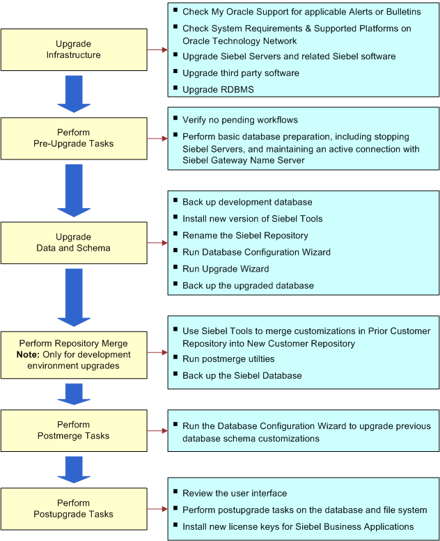

Figure 9 displays the basic tasks for upgrading the Siebel database environments.
Figure 9. Upgrading the Siebel Database Environment
