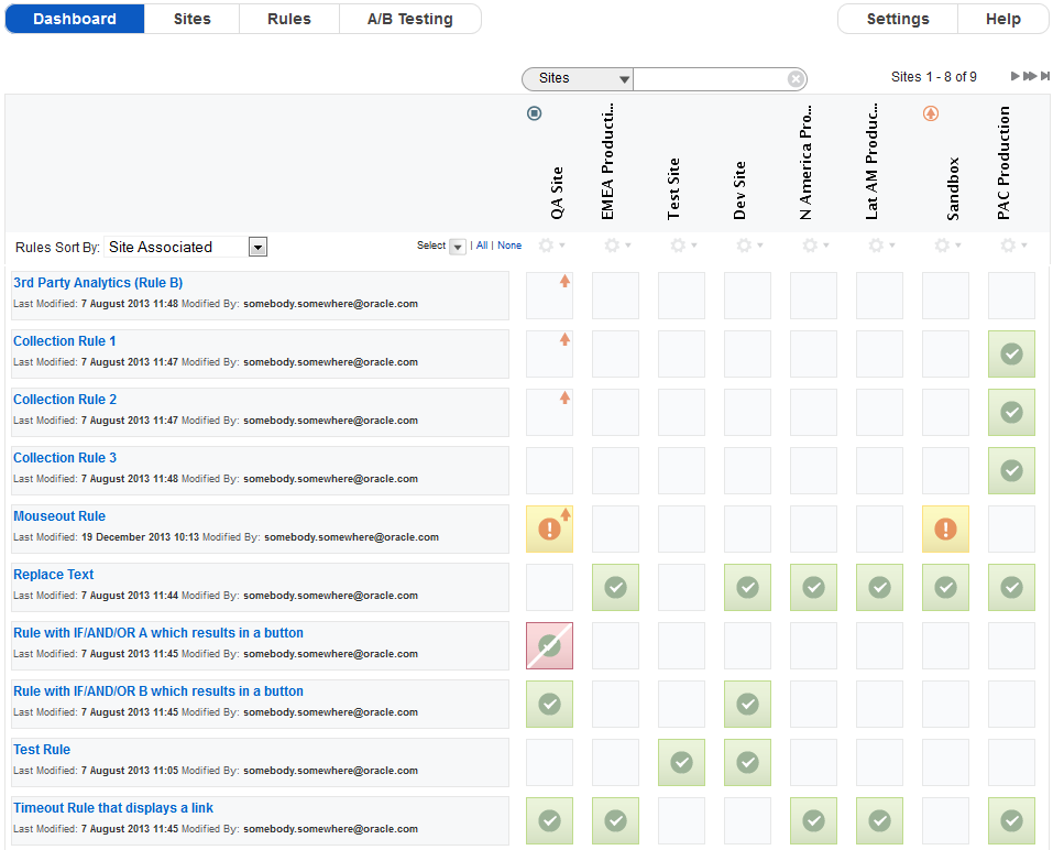

When you open Engagement Engine Editor you are presented with the Dashboard. The dashboard displays all of the rules available via the application and all of the sites available via the application, and provides a quick means of identifying which rules are deployed on which sites, and the current status of particular rule on a particular site.
If you hover over a cell in the dashboard, a tool tip appears which describes the current relationship between that particular site and rule.
Dashboard
You can navigate through the list of available rules by using the scroll bar to move up and down the list, and you can filter the rules using the rule filter option.
If you hover over a rule name in the dashboard, a tool tip appears which displays the name and the description for the rule.
There is a maximum of eight sites displayed on the dashboard at any time. If there are more than eight sites available, you can navigate through the sites by using the arrows displayed above the row containing the site names, and you can filter the sites using the site filter option.
As well as displaying the current status of a rule within a particular site, clicking on a cell in the grid cycles through the various available states for that rule on that site, i.e., you can identify a rule to be added to, modified on, or deleted from a site, depending on the current status of that particular rule on that particular site.

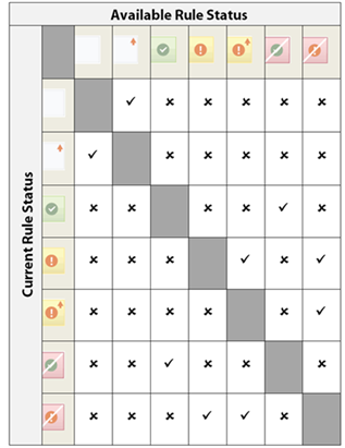

The following table displays which states are accessible for a rule in any particular state. These are the states you can select by clicking on a cell within the dashboard. The rows represent the current state for a rule on a particular site, and the columns represent the potential states for the rule.
Accessible rule states
The dashboard also provides a warning if any of the rules are affected by particular circumstances. These warnings are:
The Rule contains invalid data. This means that either a link or an operating hours set associated with the rule has been deleted, and the rule must be updated accordingly.
Another user has updated rules & sites during your session. This means that someone else who is logged onto Engagement Engine Editor has made changes to the highlighted rule or site during your session. You can remove this warning by clicking on the link provided to refresh the dashboard.
