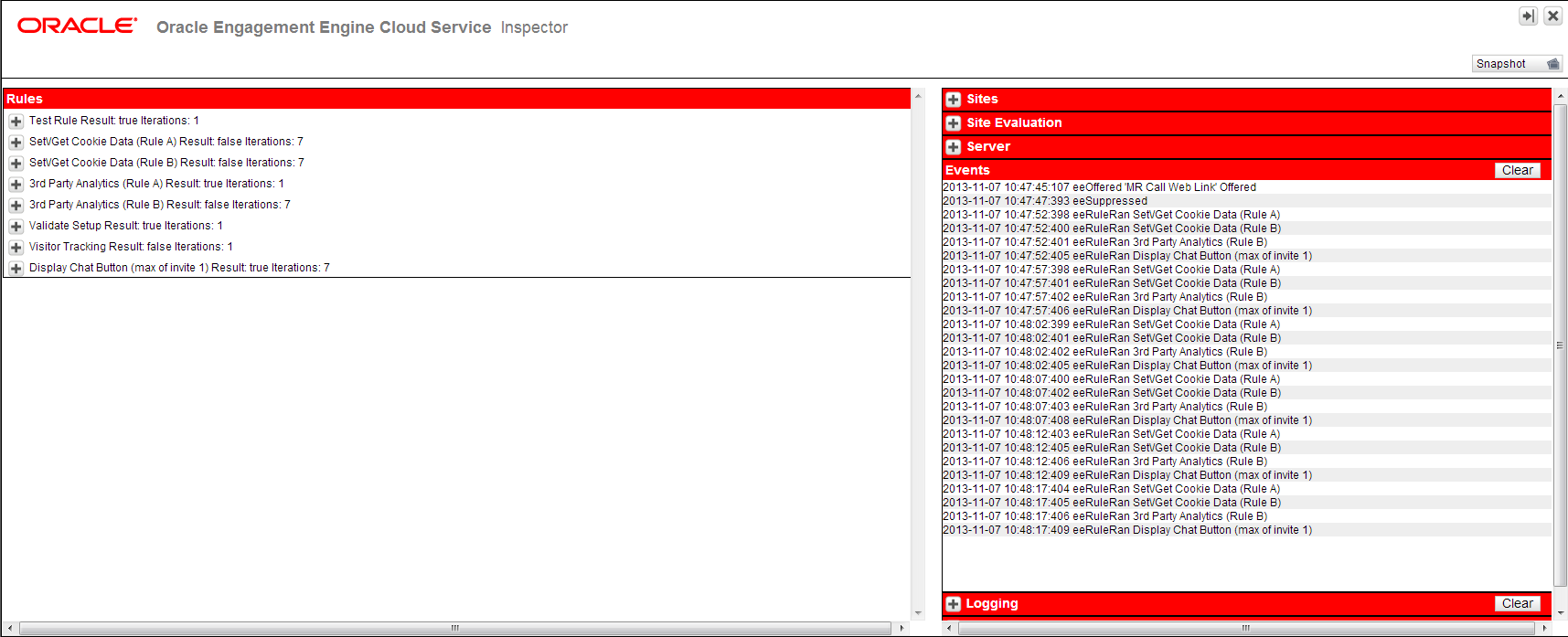

Inspector tool
The left hand side of the Inspector tool shows the Rules window. The right hand side shows a number of compressed windows that each provide further detail about Engagement Engine activity. You can expand these windows as required.
The windows that are displayed within Inspector are:
Rules: This provides technical information about the rules that have run on this page in the current session. It displays a list of the rules that have been evaluated. The list is displayed in the order that the rules were initially evaluated on the page. If you click on the + button beside a rule, Inspector displays further detail about that rule including how often the rule runs, and what conditions and actions are associated with the rule.
Note: If a rule does not run due to server-side conditions, that rule is not sent from the Engagement Engine server to the visitor’s browse, and so is not displayed in the Rules window.
Note: Because rules for a page are loaded at page load, if a rule includes an action to stop processing rules, any subsequent rules that are already loaded are displayed in Inspector with a false result. This is due to how Inspector processes the rules and does not indicate that the rules have been evaluated. This can be confirmed by the iteration count for the rules.

Events: This provides information about the events that have been triggered by rules and invites on the current page. This window updates in real-time and you can clear the contents of this window by clicking on the Clear button.
Logging: This displays any log entries that have been made while on this page. This includes system log entries and any custom log entries that have been made as a result of a rule action. Logging data is only available from pages that have been tagged to use atgsvcs-test.js. This window updates in real-time and you can clear the contents of this window by clicking on the Clear button.
Custom Data: This provides information about what data is currently held in the custom data fields.
The data displayed by Inspector is live data. The information displayed in each of the windows is updated as soon as new information relevant to each window is generated.
You can take a snapshot of the current data by clicking on the Snapshot button. This creates a new tab which contains all of the information in each of the windows as it was when the button was pressed. Inspector can capture a maximum of 5 snapshot tabs at any one time.
