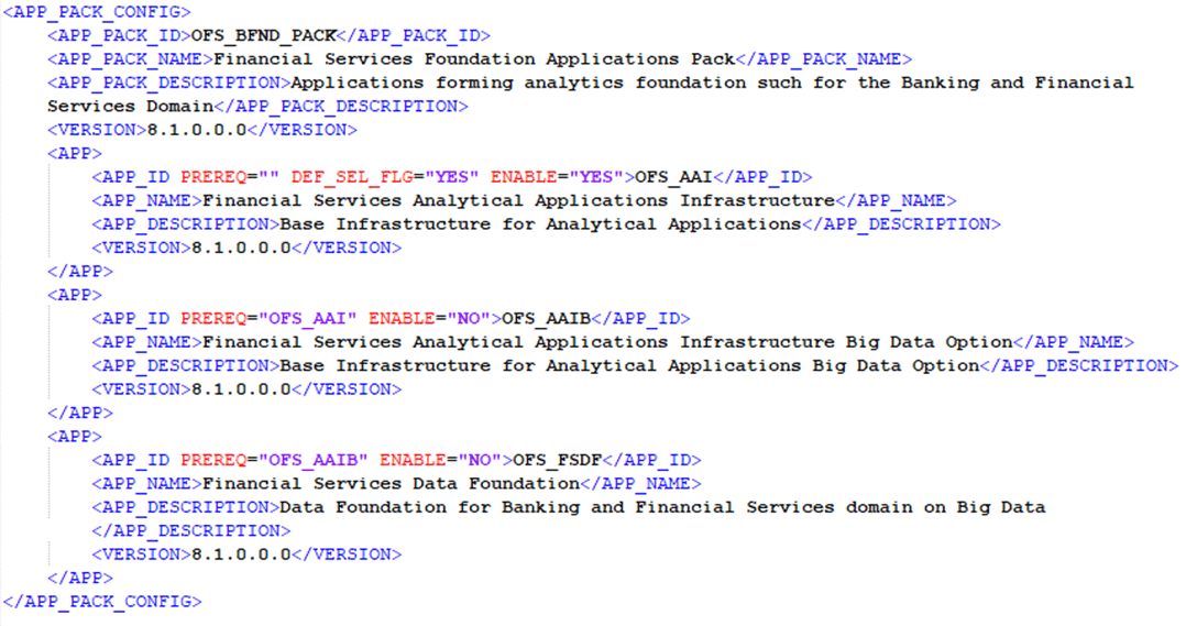

Update the OFS_BFND_PACK.xml File
Update the OFS_BFND_PACK.xml file to enable only the existing installed Application Packs.
To configure the OFS_BFND_PACK.xml file, follow these steps:
1.     Navigate to the OFS_BFND_PACK/conf/ directory.
2.     Rename the file OFS_BFND_PACK.xml to OFS_BFND_PACK.xml.template
3.     Open the OFS_BFND_PACK.xml file in a text editor.
4.     Update the OFS_BFND_PACK.xml file as mentioned in the following table only for the specified parameter.
NOTE
For the Big Data mode of installation, enable the option as YES for the APP_ID parameter with the value OFS_AAIB as illustrated in the sample.
Figure 46: Sample OFS_BFND_PACK.xml File
Title: Description of the sample OFS_BFND_PACK.xml file with the update for Upgrade follows - Description: This illustration shows the sample OFS_BFND_PACK.xml file with the update for Upgrade.
Table 39: Update Specific Parameters in the OFS_BFND_PACK.xml file
