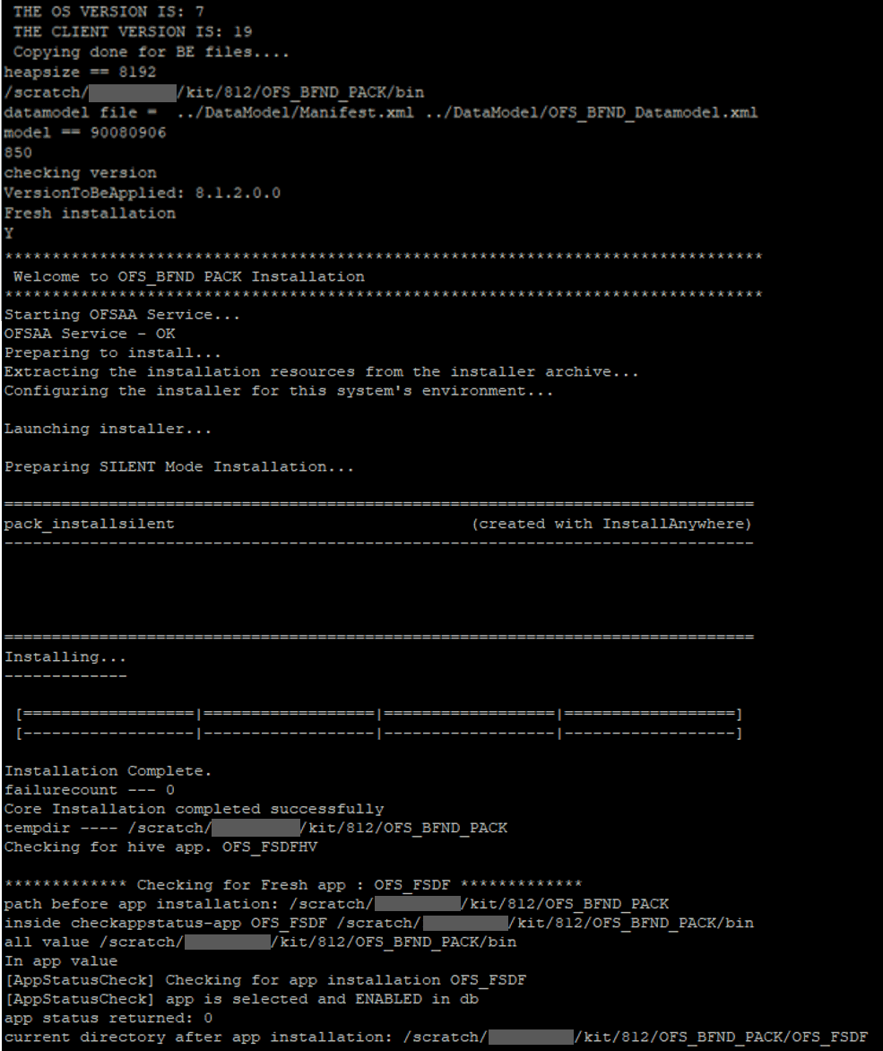

5.     Trigger the installation.

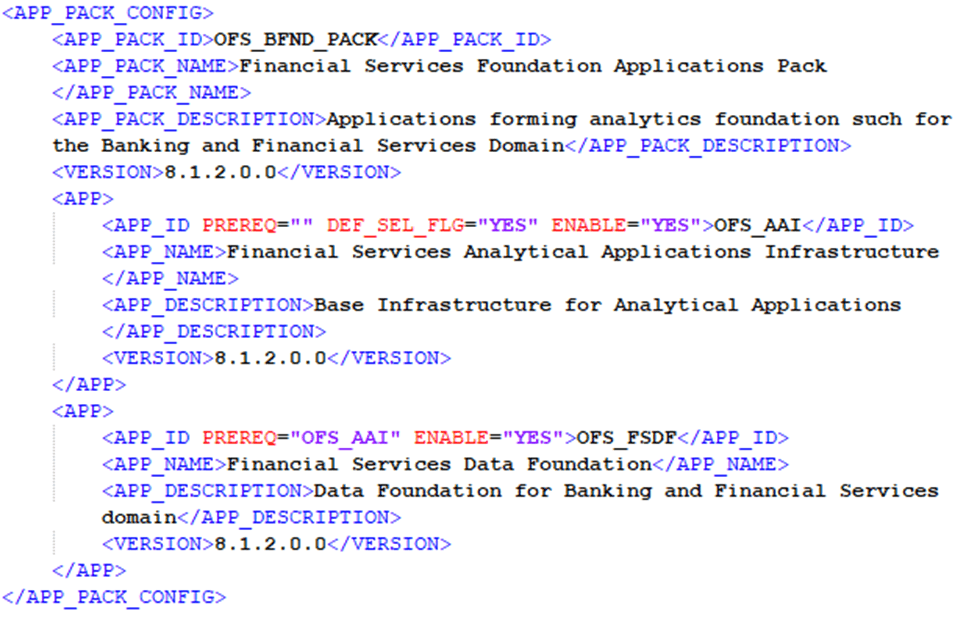

Update the OFS_BFND_PACK.xml file to enable the existing installed Application Packs.
To configure the OFS_BFND_PACK.xml file, follow these steps:
1.     Navigate to the OFS_BFND_PACK/conf/ directory.
2.     Rename the file OFS_BFND_PACK.xml to OFS_BFND_PACK.xml.template.
3.     Open the OFS_BFND_PACK.xml file in a text editor.
4.     Update the OFS_BFND_PACK.xml file in the text editor as mentioned in the following table only for the specified parameter.
Figure 36: Sample OFS_BFND_PACK.xml File
This illustration shows the OFS_BFND_PACK.xml file with sample values for the parameters.
Table 35: Update Specific Parameters in the OFS_BFND_PACK.xml File
Tag Name
Attribute Name
Description
Mandatory?
Comments
APP_ID
ENABLE
Enable the Application or Product
YES if installing in the SILENT mode.
The default value is YES for Infrastructure.
The default value is NO for Others.
The permissible values are YES and NO.
Set this attribute value to YES against every APP_ID, that is licensed and enable for the upgrade.
NOTE: You cannot disable the Application or Product after you enable it. However, the Application or the Product that is not enabled during installation can be enabled later through the Administration UI.
5.     Save the file.

Update the OFS_BFND_PACK.xml File
Update the OFS_BFND_PACK.xml file to enable only the existing installed Application Packs.
4.     Update the OFS_BFND_PACK.xml file as mentioned in the following table only for the specified parameter.
Figure 42: Sample OFS_BFND_PACK.xml File

2.     Enter the following command in the console to execute the OFSDF Application Pack installer with the Silent option:
./setup.sh SILENT

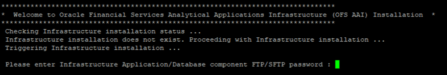

3.     The installer proceeds with the Pre-installation Checks.
4.     Enter the OFSAA Processing Tier FTP/SFTP password value and proceed, when prompted in the command prompt.
Figure 43: OFSAA Processing Tier FTP/SFTP Password Prompt
This illustration shows the OFSAA Processing Tier FTP/SFTP Password prompt. Type the correct FTP/SFTP password.

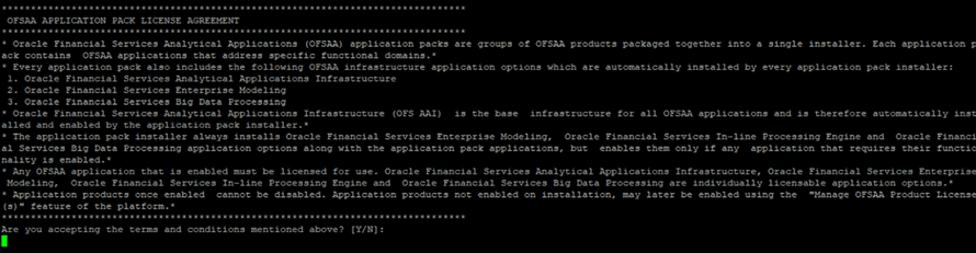

5.     The process displays the OFSAA License. Enter Y and proceed.
Figure 44: Accept the OFSAA License Agreement
This illustration shows the OFSAA License Agreement. To proceed with the installation and accept the agreement, type Y.

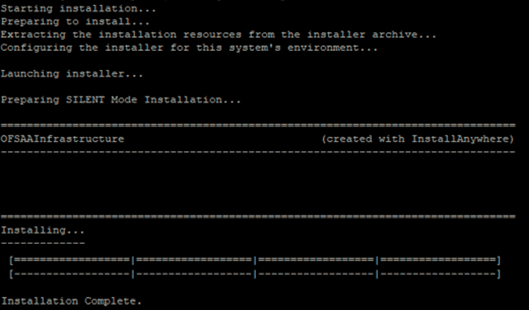

6.     The installer installs the OFSAAAI application.
Figure 45: OFS AAAI Silent Mode Installation
This illustration shows installation of the OFSAAI Application Pack in the SILENT mode.
7.     After OFSAAAI is installed, the OFSDF Application Pack installation begins.
Figure 46: OFSDF Application Pack Installation
This illustration shows installation of the OFSDF Application Pack in the SILENT mode.

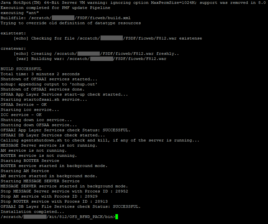

Figure 47: OFSDF Application Pack Installation Complete
This illustration shows the successful installation of the OFSDF Application Pack in the SILENT mode.
8.     The following message is displayed in the console:
Installation completed…
