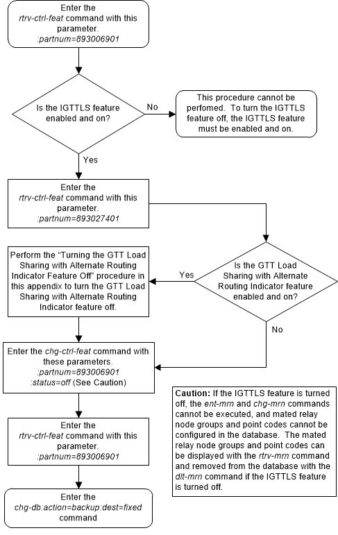

This procedure is used to turn off the IGTTLS feature,
using the
chg-ctrl-feat command.
The
chg-ctrl-feat command uses the
following parameters:
:partnum - The part
number of the IGTTLS feature, 893006901.
:status=off – used to
deactivate the IGTTLS feature.
The status of the IGTTLS controlled feature must be
on and is shown with the
rtrv-ctrl-feat command.
The GTT Load Sharing with Alternate Routing Indicator feature must be turned off before the IGTTLS feature can be turned off.
Caution:
If the IGTTLS feature is deactivated, theent-mrn and
chg-mrn commands cannot be executed,
and mated relay node groups and point codes cannot be configured in the
database. The mated relay node groups and point codes can be displayed with the
rtrv-mrn command and removed from the
database with the
dlt-mrn command if the IGTTLS feature
is deactivated.
Figure 5-6 Turn Off the IGTTLS Feature
