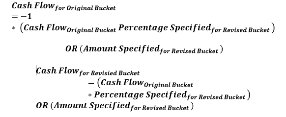

Cash flow assignment is done in the following manner:
Cash flow assignment formula
Formula for Cash flow assignment

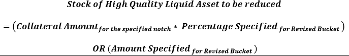

New Stock of HQLA assignment is done in the following manner:
Formula for new stock of HQLA assignment
Assuming a downgrade trigger of 3-Notches, this assumption is specified as follows:

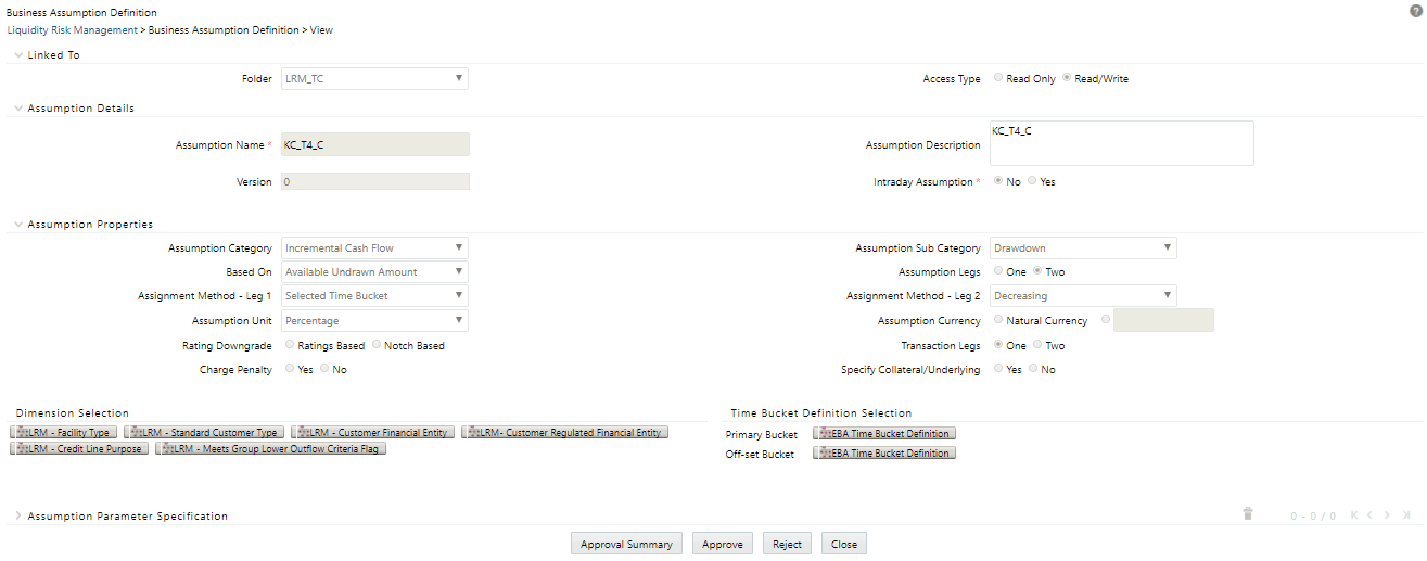

Drawdown
The Drawdown of Unutilized Credit and Drawdown of Funding Line of Credit assumption types have been merged as part of the drawdown subcategory. The assumption specification and computation method for this subcategory remain unchanged. This subcategory allows drawdown to be specified on lines of credit extended as well as received by banks in a single business assumption.
There is an amount line given to the bank or received by the banks which are allowed to drawdown. This allows drawdown to be specified on lines of credit extended as well as received by Banks.
·        Drawdown of Unutilized Credit: Banks generally allow customers to withdraw a certain amount which is a percentage of the value specified as the limit. This business assumption is applied to the undrawn portion, the assumption being that a certain portion of the undrawn amount is drawn by the customer at the specified time bucket thus leading to additional cash outflows. This assumption also allows you to specify the corresponding cash inflow for the specified cash outflow.
·        Drawdown of Funding Line of Credit: Banks also receive lines of credit from other banks and financial institutions. The bank can drawdown these lines as per its requirement at any time during the tenure of the facility. A percentage of the total undrawn amount is assumed to be drawn down over each time bucket. Drawdown of funding line of credit results in cash inflow first and outflow at a later date. This assumption also allows you to specify the corresponding cash outflow for the specified cash inflow
Additionally, this assumption allows you to specify the corresponding cash inflow for the specified cash outflow.
See Defining a New Business Assumption, for information on the steps involved in specifying this assumption.
The following steps are involved in applying the delay in cash flow timing assumption to cash flows:
1.     Identify the original time bucket and calculate the cash outflow occurring in it due to the assumption.
2.     Identify the corresponding revised time buckets and the cash inflow occurring in it, including penalties, if any.
3.     If time-specific or critical obligation, record the delay and indicate a breach.
Various options for cash flow assignments are available. Refer section Cash Flows.
Following is an illustration for drawdown:
This illustration shows the formula for drawdown.
Various options for cash flow assignments are available. See the Cash Flows section.

This assumption supports changes in the value of the collateral posted due to changes in market valuation of transaction or changes in the contract value. This further leads to cash outflow.
This assumption impacts the denominator of LCR that is, increase in the outflow for the Legal Entity.

Decreasing Cash Flow assignment is done using the following formula:
This illustration shows the formula for calculation of cash flows.
Equal cash Flow assignment is done using the following formula:
Proportional Cash Flow assignment is done using the following formula:
Selected Cash Flow assignment is done using the following formula:

Business Assumption Definition
The Business Assumption Definition window has the following sections for the purpose of defining assumption parameters:
Topics:
·        Linked To
·        Assumption Details
·        Assumption Properties
·        Filter Selection
·        Dimension Selection
·        Time Bucket Definition Selection
·        Cash Flow Interval Selection
·        Assumption Parameter Specification
Linked To
The details must be specified as follows:
·        Folder: Select the Folder which is specific to the business assumption definition.
·        Access Type: Choose the access type option, Read/Write or Read Only.
Assumption Details
The details for each business assumptions are entered here as follows:
·        Assumption Name: Specify the Assumption Name.
·        Assumption Description: Enter the assumption description.
·        Intraday Assumption: Select Yes or No if it is an intraday assumption.

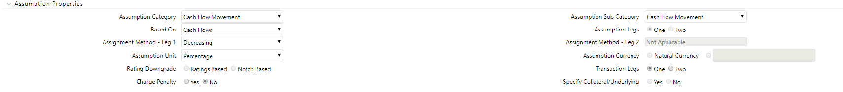

Assumption properties are the basic parameters required for defining a business assumption. They include the following:
·        Assumption Category
·        Assumption Subcategory
·        Assumption Intraday Subcategory
·        Based On
·        Assumption Legs
·        Assignment Method - Leg 1
·        Assignment Method - Leg 2
·        Intraday Assignment Method - Leg 1 and 2
·        Assumption Unit
·        Assumption Currency
·        Ratings Downgrade
·        Transaction Legs
·        Charge Penalty
·        Specify Collateral/Underlying
·        Sale Specification By
·        Reporting Line Classification

Assumption Legs
This option determines if only the off-set leg or both the primary and the off-set legs are required to specify the business assumption value as part of the assumption specification section. This is based on the type of business assumption being specified. For instance, in case of rollover, prepayments, Run-offs, and so on, assumption values are applied only to the off-set leg as the primary leg of the transaction has already occurred in the past. However, in case of a new business assumption, such as deposit growth, both the primary leg (amount deposited) and the off-set leg (repayment of the amount deposited) are required as both legs occur in the future. This selection is determined by the assumption subcategory selected. In the case of subcategories where only one option is applicable, the selection has defaulted to One in an un-editable mode. In cases where both values are applicable, Two can be selected.
The following options are present:
·        One: If One is selected as assumption leg, then only one column appears for entering the off-set assumption value.
·        Two: If Two is selected as the assumption leg, then two columns appear for entering primary assumption value and secondary or off-set value.
This option determines how the primary assumption value is allocated to time buckets. There are specific methods in which the assumption value can be distributed across buckets. Assignment methods determine how the primary assumption values are assigned to multiple buckets to determine the cash flows. Leg 1 is applicable when only one leg of the transaction is affected, such as when the assumption legs field value is selected as One.
The options are as follows:
·        Selected Time Bucket
·        Increasing
·        Decreasing
·        Equal
·        Proportionate
This method assigns the cash flows only to the time buckets against which the assumption value is specified. If the assumption is not specified on Level 0 buckets, then the assignment to the more granular buckets is done proportionately to the bucket size.
The formula is as follows:
The time buckets used for computation are as follows:

3.     Increasing assignment:
The cash flows are assigned to each bucket up to the selected bucket in increasing order based on ranks assigned to cash flows. Assignments are made in increasing order to the selected level and further assignment is done until the most granular level.
The formulae under different conditions are as follows:
a.     When, Cash Flow Based Assumptions, Assumption Unit = Percentage
b.     When Assumption Unit = Value
The following example shows Increasing Cash Flow assignment method based on Cash Flow.
This option determines how the secondary assumption value is allocated to time buckets. Secondary assumption value refers to the off-set value which can be selected in addition to the primary assumption value. Assignment methods determine how the primary assumption values are assigned to multiple buckets to determine the cash flows. Leg 2 is applicable when only two legs of the transaction are affected, such as when the assumption legs field value is selected as Two. The secondary assumption value is the off-set value specified by you in addition to the primary assumption value and is applicable only when the assumption leg is selected as Two. This is applicable only when assumption legs are selected as Two.
·        Increasing
·        Decreasing
·        Equal
·        Proportionate
The detailed calculations pertaining to each assignment method are explained in section Assignment Method Leg 1.
When the Intraday Assumption is selected as Yes in the Business Assumption Definition window the Intraday Assignment Method - Leg 1 and 2 are applicable.
For Assumptions which include time bucket as a dimension, Assumption methods are defined in the Business Assumptions window. For each leg of the assumption, the intraday assignment method is chosen separately. Assignment methods signify the method by which payments at a higher level intraday time bucket flow down to lower level intraday time buckets. Assignment methods for intraday assumptions are listed as follows:
In this method, payments from one time bucket are aggregated and shifted to another selected time bucket. The size of the source and target time buckets is not the same; since the aggregation and /or dispersion occurs at a higher time bucket level. This assignment method is available in all assumptions. For a payments shift assumption, if the selected buckets are at a higher level, payments get aggregated and dispersed equally at all constituent lower buckets. In case of a drawdown assumption, if the selected bucket is at a higher level, a single drawdown for the input value occurs at any level zero bucket of the higher level. The same principle holds good for the offset bucket as well. For a payments default assumption, if the selected residual time bucket is at a higher level, the payments are dispersed equally at all constituent lower buckets.
·        Parallel Time Bucket
In this method, payments from one bucket are shifted in parallel to another bucket of the same level as the source bucket. In other words, a constant shift happens to all level 0 buckets constituting the higher level buckets.
This assignment method is available only for Payments Shift assumption:
For example: Within a Payments Shift Assumption, if
·        Source bucket (level 3): 11-12 hrs
·        Target Bucket- (level 3): 9-10 hrs
If the level 0 buckets are in minutes, then all payments under 11:00 moves to 09:00 bucket, all payments under 11:01 moves to 09:01 bucket, all payments from 11:02 moves to 09:02 and so on.
For a drawdown and value change assumption, the parallel bucket option is not applicable.
Assumption Unit
This option helps to identify the unit based on which the assumption is defined. The options which can be selected from the drop-down list are as follows:
·        Amount
·        Percentage
·        Units
NOTE:
Units are only applicable on the selection of the subcategory Asset Sale as part of the Cash Flow Movement assumption category).
Assumption Currency
This option is applicable only when the assumption unit is selected as Amount. If the assumption unit is selected as Amount then the following options are displayed:
·        Natural Currency
·        Currency Selection
NOTE:
If you select Natural Currency, then the currency must be selected as part of dimension selection.
Ratings Downgrade
Ratings downgrade caters to the downgrade of a legal entity’s rating. This option identifies the downgrade level for the purpose of triggering the need for additional collateral. This parameter identifies the downgrade specified for a legal entity.
This downgrade can be specified as follows:
·        Rating Based
·        Notches Based
NOTE:
This is applicable only on the selection of the subcategory Encumbrance and Ratings Downgrade as part of the assumption categories Incremental Cash Flow or Encumbrance.
Transaction Legs
This option determines if one or two off-set legs are required to specify the business assumption value as part of the assumption specification section. This is based on the product type. For instance, for loans, deposits, and so on, there is only one primary leg and one off-set leg whereas for swaps there are two primary and two off-set legs for the same transaction.
One of the following options is selected:
·        One: If One is selected, only one column for the specification of each assumption leg is displayed as part of the assumption specification table that is, one column each for primary and off-set assumption value specification.
·        Two: If Two is selected, two columns are displayed for specifying each assumption leg that is two columns each for primary and off-set assumption value specification.
Charge Penalty
The Charge Penalty options are as follows:
·        Yes: If Yes is selected, an additional column in the assumption value grid is added to specify the penalty.
·        No: If No is selected, no Penalty is required.
NOTE:
This option is enabled only for the following assumption sub-categories under Cash Flow Movement category:
·        Cash Flow Movement
·        Prepayment
·        Cash Flow Delay
This option determines if existing unencumbered assets are required to be posted as collateral or underlying in the case of secured funding and repo transactions. The options are as follows:
·        Yes: If Yes is selected, existing assets can be posted as collateral for each row in the assumption specification table.

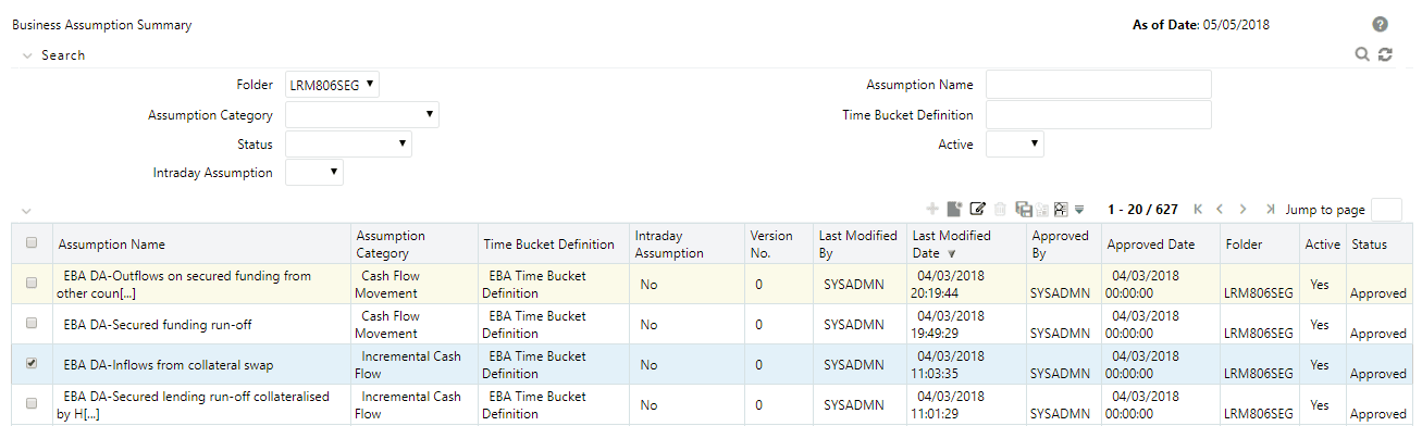

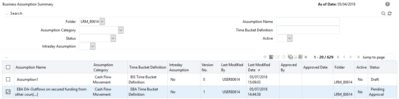

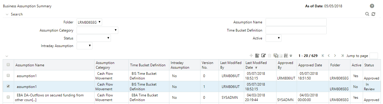

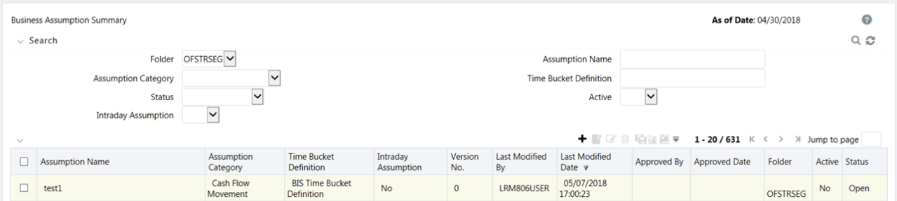

Understanding Business Assumption Summary
NOTE:
Time bucket definitions must be created before defining a new business assumption. Refer to the Time Buckets section for more information.
In the Oracle Financial Services Analytical Applications Infrastructure home screen, select Financial Services Liquidity Risk Management.
To open the Business Assumptions window, select Liquidity Risk Management then select Business Assumptions on the Left-Hand Side (LHS) menu.
Figure 22 Business Assumption Summary
Description of the Business Assumptions Summary page follows This illustration shows the Business Assumption Summary page for the OFS LRS application. You can add, view, edit, copy or delete definitions.
The definitions based on the search criteria are listed under List of Business Assumptions.
This is the search section which contains multiple parameters. You can specify one or multiple search criteria in this section. When you click Search, depending upon the search criteria, this filters and displays the relevant search combination parameters under the Business Assumption Summary as a list.
The Business Assumption Summary window displays the following fields.
Business Assumptions - Fields and Descriptions
Search Field or Icon
Description
SearchSearch icon
This icon allows you to search the Assumption based on the search criteria specified. Search criteria include a combination of Folder, Assumption Name, Assumption Category, Time Bucket Definition, Status, and Active Status. The business assumptions displayed in the List of Business Assumptions table are filtered based on the search criteria specified when clicking this icon.
Reset Refresh icon
This icon allows you to reset the search section to its default state that is, without any selections. Resetting the search section displays all the existing business assumption definitions in the List of Business Assumptions table.
Folder
This field allows you to search for the pre-defined business assumption definitions based on the selected folder. This field displays a list of folders that you have access to as a drop-down list. The selection of a folder from the drop-down list displays only those business assumptions that have been defined within the selected folder/segment in the List of Business Assumption table.
Assumption Name
This field allows you to search the pre-defined business assumption definitions based on the assumption name. Enter the assumption name.
Assumption Category
This field allows you to search the pre-defined business assumption definitions based on the assumption category. This field displays a list of categories that you have access to as a drop-down list. The selection of an assumption category from the drop-down list displays only those business assumptions that have been defined within the selected assumption category in the List of Business Assumption table.
Inclusion Filters
This field allows you to specify the Inclusion filters.
Exclusion Filters
This field allows you to specify the Exclusion filters.
This field allows you to search the pre-defined business assumption definitions based on the Time Bucket Definition. Enter the time bucket definition which was defined in the Time Bucket Definition window.
Status
This field allows you to search the pre-defined business assumption definitions based on approval status. This field displays a list of statuses that you have access to as a drop-down list, that is, Approved, Draft, In Review, Open, Pending Approval or Retired. Click the drop-down list to select Approved or Rejected status. The selection of a status from the drop-down list displays only those business assumptions that have been defined within the selected status in the List of Business Assumption table.
Active
This field allows you to search the pre-defined business assumption definitions based on active status. This field displays a status that you have access to as a drop-down list, that is, Yes or No. The selection of a status from the drop-down list displays only those business assumptions that have been defined within the selected status in the List of Business Assumption table.
Intraday Assumption
This field allows you to search the Intraday business assumption defined. This field displays options in the drop-down list, Yes or No. Selection of a Yes from the drop-down list displays only those intraday business assumptions that have been defined in the List of Business Assumption table. Selection of a No from the drop-down list displays only those business assumptions apart from intraday assumptions that have been defined in the List of Business Assumption table.
Business Assumptions Icon Name
Icon
Description
Add
Add icon
This icon allows you to define a new assumption.
View
View icon
This icon allows you to view the selected assumption.
Edit
Edit icon
This icon allows you to edit the selected assumption.
Delete
Delete icon
This icon allows you to delete the selected assumption.
Copy
Copy icon
The icon allows a definition to be copied and resaved as a new definition.
Make Active
Make Active icon
This icon allows activating the selected version of the assumption. The active version of the assumption is considered for Run definition.
Workflow Summary
Workflow Summary icon Workflow Summary icon
The icon displays the approval summary for the definition.
The Business Assumption Definition window allows you to define a new assumption definition in the LRM Application. See the Business Assumptions Supported section for a detailed explanation and calculations.
Figure 23 Business Assumption Definition
Description of the Business Assumption Definition window follows This illustration shows the Business Assumption Definition window. You can define a new business definition using this window.
The assumption parameters enabled are specific to each assumption category and sub-category. To create a new business assumption, follow these steps:
1.     Click Add icon in the Business Assumption Summary window.
2.     The Business Assumption Definition window is displayed where you can define new business assumption definitions. See the following table for field details.
Field
Available Options
Section: Linked to
Business Assumption Definition Linked to section
Folder
Select the folder specific to the business assumption definition.
Access Type
Select either Read/Write or Read-Only.
Section: Assumption Details
Business Assumption Definition Assumption Details section
Assumption Name
Enter a name unique across infodoms. This field allows special characters.
Enter a brief description. This field allows special characters.
Version Number
Generated automatically.
Intraday Assumption
Select either Yes or No.
Section: Assumption Properties
Business Assumption Definition Assumption Properties section
Assumption Category
Select from the following options:
·        Incremental Cash Flow
·        Encumbrance
·        Value Change
Assumption Sub-Category
Based on the Assumption category selected, the following options are displayed:
Note: If Intraday Assumption is selected as Yes, then intraday specific categories and sub-categories are displayed. See Assumption Intraday Sub-Category for details.
Assumption Category: Cash Flow Movement
Assumption sub-category:
·        Asset Sale
·        Cash Flow Delay
·        Delinquency
·        Prepayment
·        Recovery
·        Rollover
·        Run-off
Assumption Category: Encumbrance
·        Encumbrance
·        Ratings Downgrade
·        Valuation Changes
Assumption Category: Incremental Cash Flow
·        Drawdown
·        Liability Run-off
·        New Business
·        Ratings Downgrade
·        Run-off
·        Secured Funding/Financing
·        Valuation Changes
Assumption Category: Value Change
·        Available Stable Funding Factor
·        Haircut
·        Required Stable Funding Factor
Based On
Choose the based on measure to which the assumption parameter values are applied for cash flows calculation. See Based On for details.
Assumption Legs
Select the number of Assumption Legs to specify the assumption parameter values, as either:
·        One
·        Two
NOTE:
This field is not available for all assumption sub-categories. When One is selected as assumption leg, in assumption specification only a column is displayed to add the primary assumption value.
See Assumption Legs for details.
·        Increasing
·        Decreasing
·        Equal
·        Proportionate
See Assignment Method Leg 1, for details about the specific methods in which the assumption value can be assigned across multiple buckets.
Select from one of the following options:
·        Increasing
·        Decreasing
·        Equal
·        Proportionate
See Assignment Method leg 2,  for details about the specific methods in which the assumption value can be assigned across multiple buckets.
Assumption Unit
·        Amount
·        Percentage
·        Unit: Applicable when Sale is specified.
See Assumption Unit  for details. This parameter is the unit based on which the assumption values are specified.
Assumption Currency
This option is enabled only when you select the assumption unit as Amount. See Assumption Currency for details. You can either select the option as Natural Currency, or choose any other currency from the drop-down list, which is required as part of the definition.
NOTE:
·        If you select Natural Currency, ensure that the currency is selected as part of dimension selection.
·        Assumption Category - Incremental Cash Flow, sub-category - Liability Run Off is the only assumption where a currency is specified, even when the unit is specified as percentage. The assumption currency is required for specifying the minimum Balance.
Rating Downgrade
·        Notch Based
·        Ratings Based
This is applicable only when you select the sub-category Encumbrance and Ratings Downgrade, for assumption categories Incremental Cash Flow or Encumbrance. See Ratings Downgrade  for details.
Transaction Leg
·        One
·        Two
See Transaction Legs, for details.
Charge Penalty
·        Yes (For this option, an additional column in the assumption value grid is added to specify penalty)
·        No
See Charge Penalty  for details.
·        Yes
·        No
This parameter determines if the existing unencumbered assets are required to be posted as collateral or underlying that is, if there are secured funding and repo transactions. See Specify Collateral/Underlying  for details.
This field is available only when you select Cash Flow Movement as the Assumption Category and Asset Sale as the Sub-Category.
Select from one of the following options to specify a sale:
·        Individual Assets
·        Dimensions

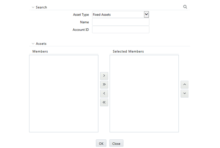

If you select Individual Assets follow these steps:
1.     In the Asset Browser Selection, click Select Assets icon Select Assets icon icon. The Asset Browser window appears.
2.     Select the Asset Type, enter Name and Account ID.
3.     Select one or more members from a list of members displayed.
4.     Click Move icon Move icon to move the selected members to Selected Members section or click Move All icon Move All icon to select all members.
5.     Click OK.
If you select Dimensions, follow the steps in Dimension Selection.
See Sale Specification By  for details.
Select Enable or Disable for the field Reporting Line Classification.
If you select Enable, the field Reporting Line Dimension is displayed. Click Select Dimension icon Select Dimension icon to view the hierarchy browser. All the dimensions in the FSI_LRM_REP_LINE_ATTR_DETAILS table are displayed. Click Move icon Move icon  to move the selected dimensions to the Selected Members section.
Section: Inclusion Filters/Exclusion Filters
Inclusion Filters
This field is available only for specific Assumption categories and sub-categories. See Filter Selection for details.

For category Value Change, sub-category Available Stable Funding Factor, this selection is enabled only when you select the Based On measure as Cash Flows, Less Stable Cash Flows, Non-operational Cash Flow, Operational Cash Flow or Stable Cash Flow.
3.     Click Grid Right icon Grid Right icon. The Assumption Parameter Specification table is generated with the selected dimensions as column values and dimension members as row values. Additionally, depending on your selection, one or two time bucket columns are displayed.
Assumption Parameter Specification section

·        To enable Collateral Posting, select a row, and then click the Add Assets icon Add Assets iconicon. The Asset Browser window with only unencumbered assets is displayed. This icon is enabled only when the Post Collateral parameter is selected as Yes.
·        The assets that are unencumbered during the selected period are displayed even if they are encumbered currently. These are allowed to be posted as collateral for the unencumbered period.
·        After selecting the members, click Move icon Move icon to move the selected member, or click Move All icon Move All icon to move all the members, to the Selected Members section, and click OK.
·        The selected collateral is displayed in the respective row in Assumption Specification. Encumbrance value can be specified as a percentage against each collateral. This column enables the specification of partial encumbrance. You can select one or multiple members for each selected dimension. These are displayed as sub rows against the dimensional combination row for which this is being specified in the Assumption Specification table.
4.     Follow these steps to add values to Collateral/Underlying, and Encumbered value columns for assumption category - Incremental Cash Flow, sub-category - Secured Funding/Financing:
a.     Click the check box on the left of the dimensional combination. Once the dimensional combination is chosen in the grid, click the Add Assets (Add Assets icon Add Assets icon) icon. The Add Assets icon allows you to add as many assets as needed for the particular row in the grid.
Assumption parameter specification grid Assumption parameter specification grid
b.     Once the Add Assets icon is clicked, enter values in the following screen.
Description of the Add Assets window follows This illustration shows the Add Assets window.
c.     The business assumption definition after collateral and encumbered value is specified are displayed as follows.

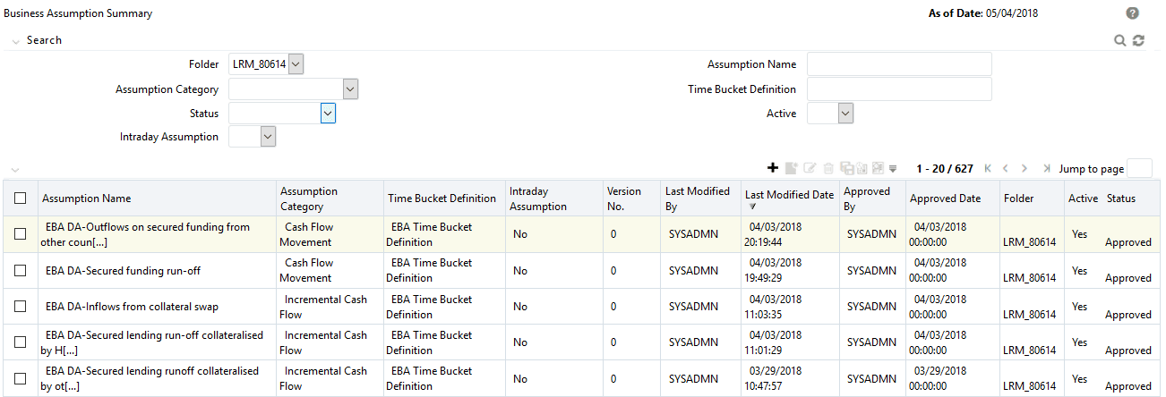

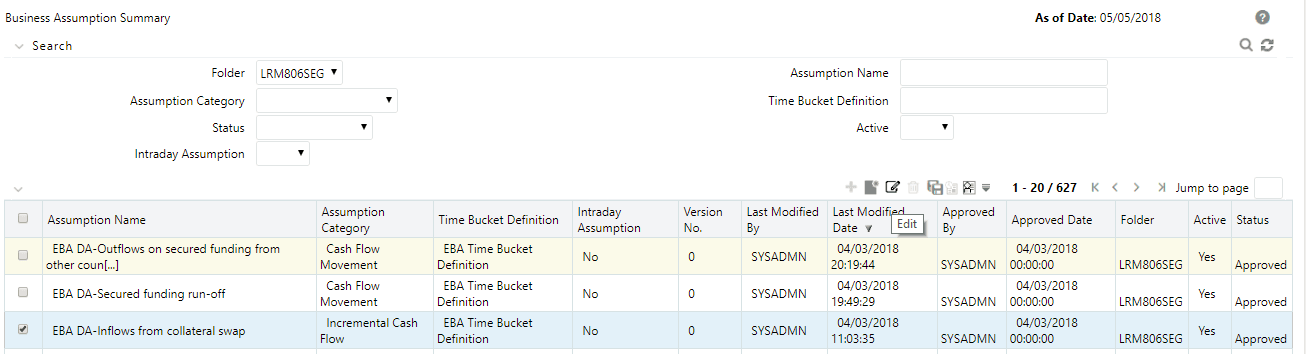

2.     Click Select icon Select icon to select a definition with the status “Draft”, “Open” or “In Review” from the list of business assumptions and then click the Edit icon Edit icon icon.
Figure 24 Business Assumption Summary - Draft Status
Description of the Business Assumption Summary - Draft Status page follows This illustration shows the Business Assumption Summary - Draft Status page.
Figure 25 Business Assumption Summary - Open Status
Description of the Business Assumption Summary - Open Status page follows This illustration shows the Business Assumption Summary - Open Status page.
Figure 26 Business Assumption Summary - In Review Status
Description of the Business Assumption Summary - In Review Status page follows This illustration shows the Business Assumption Summary - In Review Status page.

1.     Click Business Assumption on the LHS menu of the LRM Application to open the Business Assumption Summary window. Only assumptions which are in Pending Approval status can be approved or rejected by the approver.
2.     Click Select icon Select icon to select a definition with the status Pending Approval from the list of business assumptions and then click the View icon View icon icon.
Figure 28 Business Assumption Summary - Pending Approval
Description of the Business Assumption Summary - Pending Approval page follows This illustration shows the Business Assumption pending Approval page.
The Business Assumption Definition window is displayed with all the parameters defined.
Figure 29 Business Assumption Definition - Approve/Reject
Description of the Business Assumption Definiton - Approve or Reject window follows This illustration shows the Business Assumption Definition - Approve or Reject window.
3.     To approve the definition that is sent for authorization, click Approve.

Retiring a Business Assumption Definition
You can retire a business assumption definition when a definition is no longer valid and not required to be included in the selection of a new run calculation. To retire a definition once it is approved, follow these steps:
1.     To retire a definition, click Select icon Select icon to select a definition from the list of business assumptions and then click View icon View icon  or Edit icon Edit icon.
Figure 33 Business Assumptions - Retire
Description of the Business Assumption Summary page follows This illustration shows the Business Assumption Summary page.
The Business Assumption Definition window is displayed.
Description of the Business Assumption Definition - View page follows This illustration shows the Business Assumption definition - View page.
2.     Click Retire. A retired definition will not be available for selection as part of a new Run definition.

Editing a Business Assumption
The process of editing a business assumption is as follows:
1.     To edit a definition, click Select icon Select icon to select a definition from the list of business assumptions and then click Edit icon Edit icon.
Figure 34 Business Assumptions - Editing a Business Assumption
Description of the Business Assumption Summary follows This illustration shows the Business Assumption Summary page.
·        You can edit a definition which is in Draft, Open and In Review status. An LRM Analyst has the privileges to edit.
·        When the definition is in Draft status, all the parameters can be edited in the Business Assumption Definition window.
·        When the definition is in Open status and In Review status, all the parameters except the Assumption Name can be edited in the Business Assumption Definition window.
·        When you edit a definition which is Draft status, it remains in version 0.
·        When you edit a definition that is in Open status, the version number does not change.
NOTE:
·        In Draft and Open status, the changes made are overwritten and the version number does not change.
2.     When you edit a definition that is in Approved status, the version number is changed, and a new version is created. This changes the status to In Review.
