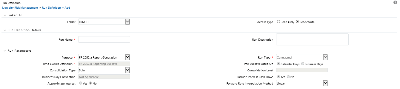

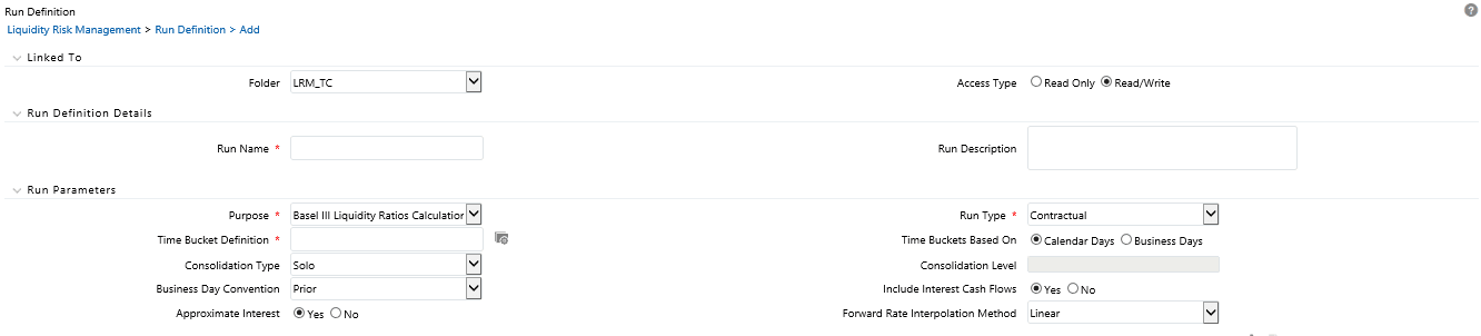

The Run Definition window has the following sections for defining parameters:
The details must be specified as follows:
· Folder: Select the Folder which is specific to the Run definition.
· Access Type: Choose the access type option, Read/Write or Read-Only.
The details for each Run definition are entered here as follows:
· Run Name: Specify the Run name.
· Run Description: Enter the Run description.
The parameters for each Run definition are entered here as follows:
· Purpose
· Run Type
· Payment System Consolidation Type
· Forward Rate Interpolation Method
· Include Forward Date Calculations
· Forward Balance Method Mapping Rule
· Forward Cash Flow Method Mapping Rule
· Balance Sheet Adjustment Method
· Balance Sheet Adjustment Rule
· Number of Forward Calculations

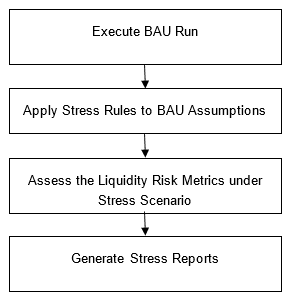

Figure 35: Process Flow of a Business-as-Usual Run
1. Executing BAU or Baseline Run: A Contractual Run is executed before the Business As Usual Run. Once the liquidity gaps are estimated under contractual terms, the changes in cash flows during the normal course of business due to consumer behavior are to be estimated. This involves defining business assumptions based on multiple rules and specifying assumption values. The assumptions include, drawdown, prepayments, rollovers, asset or liability book growth, run-offs, asset value changes, recovery from delinquent accounts, available stable funding factors, required stable funding factors, and so on. Assumption values specified for each dimension member combination is selected from predefined business hierarchies or dimensions. Once these assumptions are defined, they are grouped together and applied to contractual cash flows as part of the BAU Run or Baseline Run execution process. The impact of these business assumptions on liquidity gaps, ratios, and other metrics is estimated.
2. Baseline Reports: LRM generates the Baseline reports that enable a detailed view of the liquidity risk metrics.

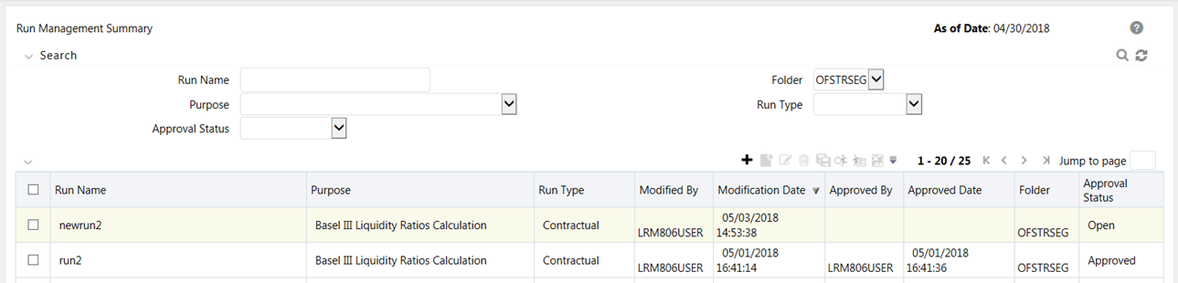

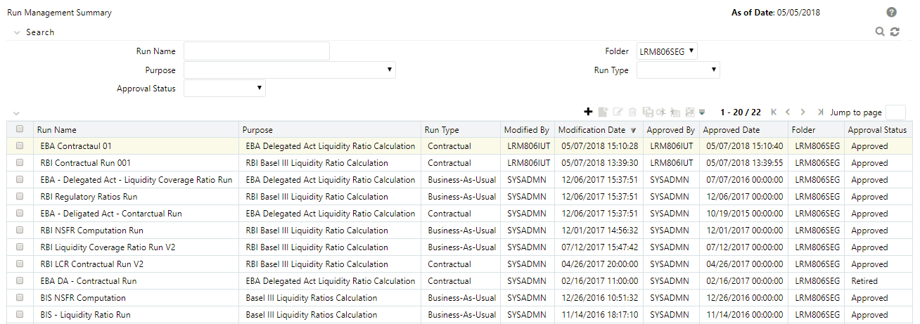

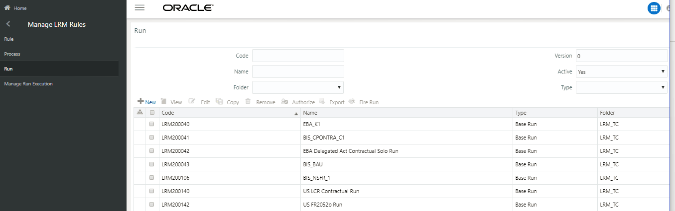

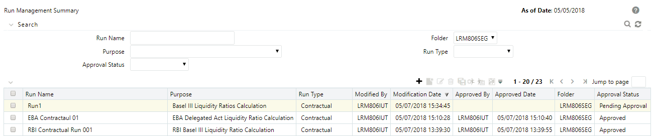

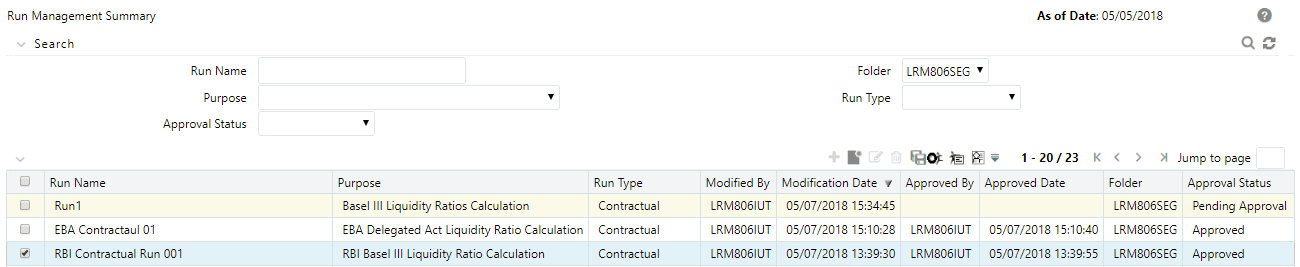

The Stress Run defined appears in the list of Runs in the Run Management Summary window. You can approve the definition and then execute it. BAU Run is a pre-requisite for defining stress Runs.

Figure 36: Process flow of a Stress Run
1. Executing Stress Run: The Contractual Run is executed first. The BAU Run is executed next. For executing Stress Runs, the Contractual or BAU cash flows are stressed. A combination of stressed assumptions or a stress value of higher magnitude becomes a stress scenario. The values can be applied as absolute values, or they can be percentages. The liquidity gaps under the given stress scenario are calculated. The impact of the stress scenario is assessed on Liquidity Coverage Ratio (LCR), Net Stable Funding Ratio (NSFR,) and Funding Concentrations.
2. Stress Reports: LRS generates the Stress reports that enable a detailed view of the liquidity risk metrics like Liquidity Gaps across time buckets, Cumulative Gaps, Gaps across time, Comparison across scenarios, LCR, NSFR, Funding Concentrations, and so on.

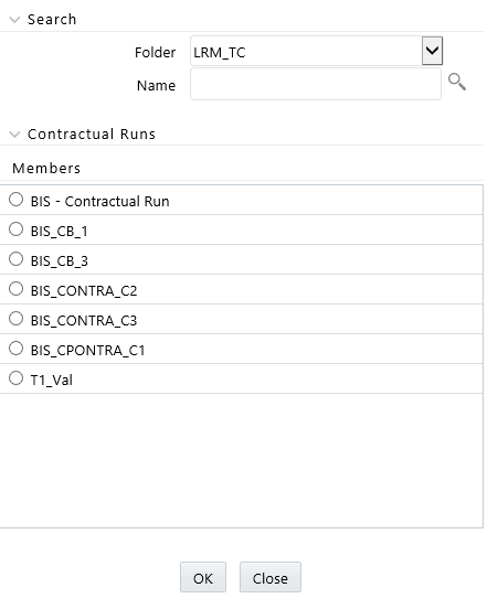

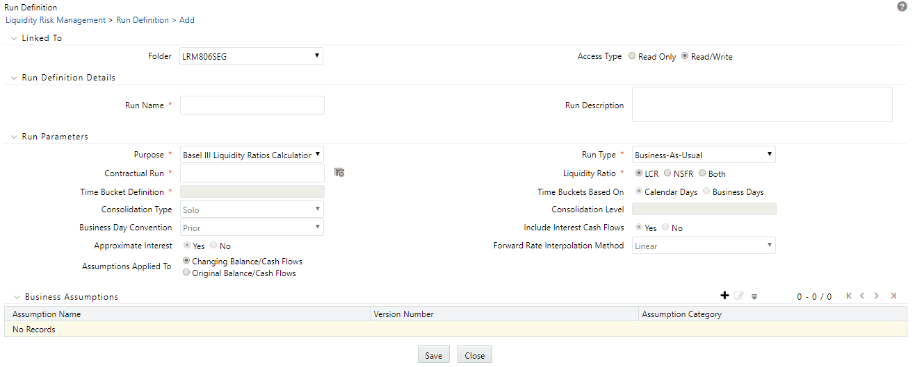

When the Run type is selected as Business-As-Usual, the Contractual Run is required to be selected from the Contractual Run browser. The Contractual Run browser displays a list of contractual Runs. The list is filtered by the purpose selected. For example, if the purpose is selected as Basel III Liquidity Ratios Calculation for a BAU Run, it displays only those Contractual Runs which are specified with that purpose. You are allowed to select a single Contractual Run.

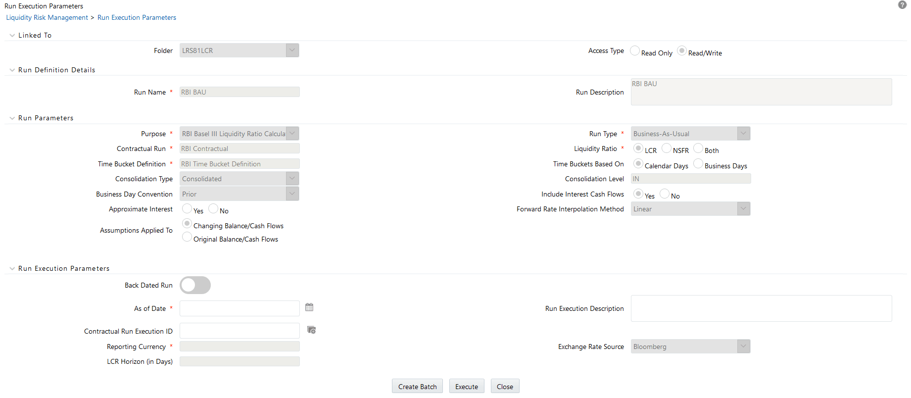

Figure 37 Run Definition - Contractual Run window

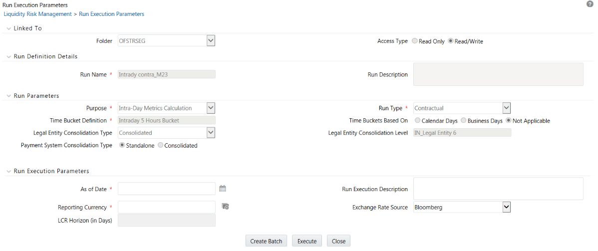

When the purpose is selected as Basel III Liquidity Ratios Calculation and the Run type is selected as BAU the Liquidity ratio button is enabled for selection in the Run Definition window. Select either of the following options:
· LCR: If you select LCR, only LCR is calculated.
· NSFR: If you select NSFR, then only NSFR is calculated.
· Both: If you select Both, both NSFR and LCR is calculated in the same Run.

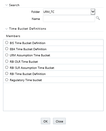

When the Run type is selected as Contractual, the Time Bucket Definition is available for selection from the Time Bucket Definition browser. The Time Bucket Definition browser displays the list of computational time buckets defined as part of the Time Bucket window. You are allowed select a single time bucket definition.
NOTE:
· When the Run purpose is selected as Intraday Metrics Calculation, only intraday buckets are listed under the list time bucket definitions section.
Figure 38 Run Definition - Time Bucket Definition window
When the Run type is selected as Contractual, Time Buckets Based On selection is allowed in the Run Definition window. Select either of the following options:
· Calendar Days: The start and end date of each time bucket are computed based on the number of calendar days when this parameter is selected. The time bucket dates are in running calendar day sequence. The time bucket dates are consistent across multiple legal entities each with different holidays.
· Business Days: The start and end date of each time bucket is computed based on the number of business days when this parameter is selected. The time bucket dates are not continuous calendar days in this case but will exclude holidays. The time bucket dates will be different for each legal entity based on its respective holiday calendar.

When the Run type is selected as Contractual, Consolidation Type selection is allowed in the Run Definition window. This parameter determines if the calculations are to be executed on a standalone basis for one or multiple selected legal entities or on a consolidated basis at the level of the selected legal entity. Select either of the following options from the drop-down list:
· Solo
· Consolidated

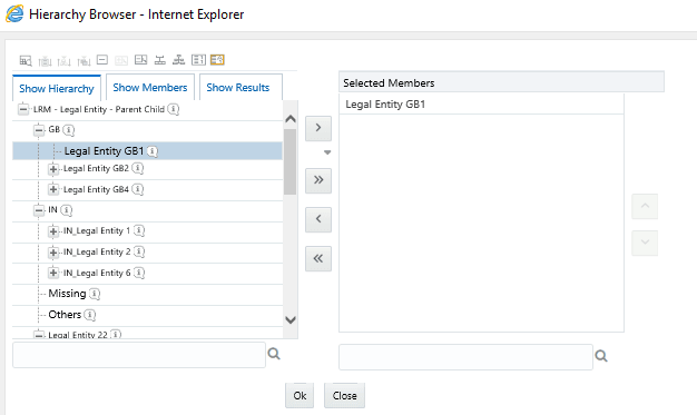

In case you have selected Consolidation Type as Consolidated, you must select in the Consolidation Level to launch the Legal Entity browser for selecting the consolidation level. Select a single legal entity, at which the consolidated liquidity risk measures are to be calculated, from the list of legal entities available in the Legal Entity browser.
NOTE:
· This selection is applicable only when the Run Type is selected as Contractual Run and Consolidation Type is selected as Consolidated. If you have selected the Consolidation Type as Solo, then Consolidation Level field is disabled, and the solo legal entities are to be selected as part of the Legal Entity Selection section.

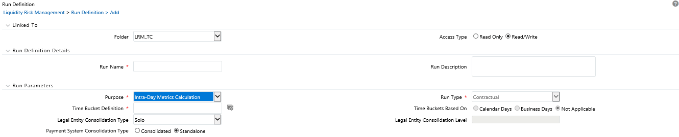

When the Run type is selected as Contractual and the purpose is selected as Intra-Day Metrics Calculation Payment System Consolidation Type is allowed for selection.
This parameter determines if the calculations are to be executed on a consolidated or standalone basis for one or multiple payment systems. Select either of the following options:
§ Consolidated
§ Standalone
NOTE:
· By default, the Payment System Consolidation Type is selected as Standalone.
When the Run type is selected as Contractual, Business Day Convention selection is allowed in the Run Definition window for the purpose of bucketing cash flows. Select either of the following options from the drop-down list:
· Conditional Following
· Conditional Prior
· Following
· No Adjustment
· Prior
When the Run type is selected as Contractual, Include Interest Cash Flows selection is allowed in the Run Definition window. Select either of the following options:
· Yes: In case you select Yes, both principal and interest cash flows are considered for calculations.
· No: In case you select No, only principal cash flows are considered, and interest cash flows are ignored.
When the Run type is selected as Contractual and when Include Interest Cash Flows are selected as Yes, Approximate Interest selection is allowed in the Run Definition window. Select either of the following options:

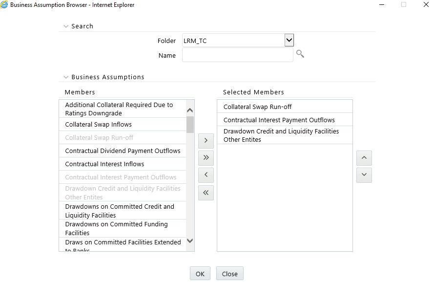

· Yes: When Approximate Interest is selected as Yes, the business assumption is applied only to the principal cash flows, and the interest cash flows are approximated based on changes to the principal.
· No: If you select No, the business assumption values are applied to both principal and interest cash flows. However, this application depends on how the business assumption is defined as follows:
§ If you have selected Cash Flow Type as a dimension in the business assumption and the dimension member as Principal, then the assumption is applied only to the principal cash flows.
§ If you have selected Cash Flow Type as a dimension in the business assumption and the dimension member as Interest, then assumption impacts only Interest cash flows.
§ If you have selected Cash Flow Type as a dimension in the business assumption and the dimension member as Principal and Interest, then the assumption is applied to both principal and interest cash flows.
§ If you have not selected Cash Flow Type as a dimension in the business assumption, then the assumption is applied to both principal and interest cash flows.
When the Run type is selected as Contractual, Forward Rate Interpolation Method selection is allowed in the Run Definition window. Select either of the following options from the drop-down:
· Linear
· Log Linear

Figure 39 Run Definition - Hierarchy window
NOTE:
· The parameters Contractual Run and Assumptions Applied to are applicable only when BAU Run is defined. All other parameters of the BAU Run are the same as those of the underlying contractual Run.
· All parameters of the Stress Runs are the same as those of the underlying BAU Run.

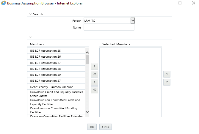

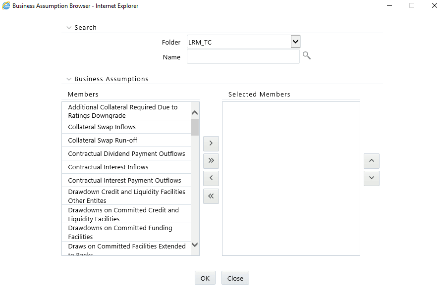

When the Run type is selected as Business-As-Usual, you are required to select one or multiple business assumptions to be applied to contractual calculations. The Business Assumptions browser displays a list of all approved business assumptions which have a time bucket definition that corresponds to the definition selected as part of the Run Parameters section. Select one or more business assumptions that you want to apply.
Figure 40 Run Definition - Business Assumption window
In Oracle Financial Services Analytical Applications Infrastructure home screen select, Financial Services Liquidity Risk Management.
To open the Run Management window, select Liquidity Risk Management then select Run Management on the Left-Hand Side (LHS) menu.

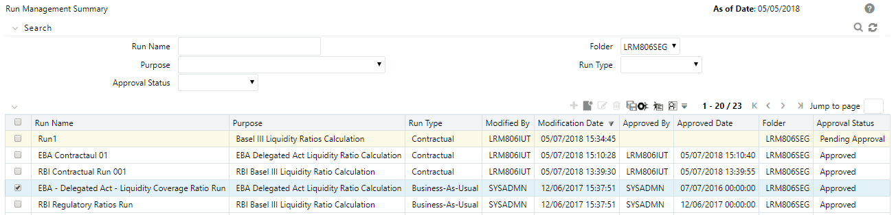

Figure 41 Run Management Summary
The Run management summary window of the LRMM application allows you to define, approve and execute Run or Runs.
This is the search section which contains multiple parameters. You can specify one or multiple search criteria in this section. When you click the search icon, depending upon the search criteria, this filters and displays the relevant search combination parameters under the Run Management Summary as a list.
Search Field or Icon |
Description |
Search |
This icon allows you to search the Run definition based on the search criteria specified. Search criteria include a combination of Run Name, Folder, Approval Status, and Run Type. The Run definitions displayed in the Run Management Summary table are filtered based on the search criteria specified on the clicking of this icon. |
Reset |
This icon allows you to reset the search section to its default state that is, without any selections. Resetting the search section displays all the existing Run definitions in the Run Management Summary table. |
Run Name |
This field allows you to search the pre-defined Run based on the Run name. Enter the Run name. |
Folder |
This field allows you to search for the pre-defined Run definitions based on the selected folder. This field displays a list of folders that you have access to as a drop-down. The selection of a folder from the drop-down list displays only those Run definitions that have been defined within the selected folder/segment in the Run Management Summary table. |
Run Type |
This field allows you to search the pre-defined Run based on Run Type (Contractual, BAU, or Stress Run). You need to specify the Run Type here for searching pre-defined Run. |
Approval Status |
This field allows you to search the pre-defined Run based on approval status. This field displays a list of statuses that you have access to as a drop-down that is, Approved, Draft, In Review, Open, Pending Approval or Retired. Click the drop-down list to select Approved or Rejected status. The selection of a status from the drop-down list displays only those Run definitions that have been defined within the selected status in the Run Management Summary table. |
Runs Icon Name |
Icon |
Description |
Add |
This icon allows you to define a new Run. |
View |
This icon allows you to view the selected Run definitions. |
Edit |
This icon allows you to edit the selected Run definition. Once the definition is approved, it cannot be edited in the case of Run definitions. |
Delete |
This icon allows you to delete the selected Run definition. |
Copy |
The icon allows a definition to be copied and resaved as a new definition. |

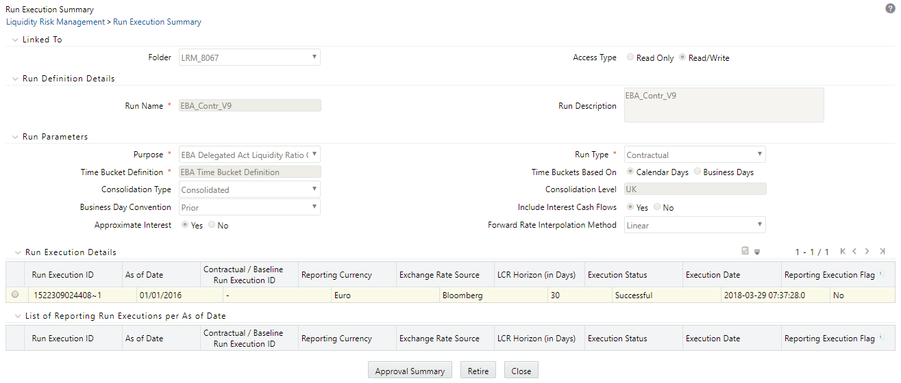

Run Execution Parameters |
This icon allows you to specify execution parameters and execute the Run from the Run Execution Parameters screen. Select the check-box against a Run definition and click the Run Execution Parameters icon to view the Run Execution Parameter Specification window. |
Run Execution Summary |
This icon displays the Run Execution Summary window. The Run parameters specified as part of the Run Definition window are displayed in an un-editable form in the Run Parameters window. The entire list of executions and their details are displayed for the selected definition in this screen. |

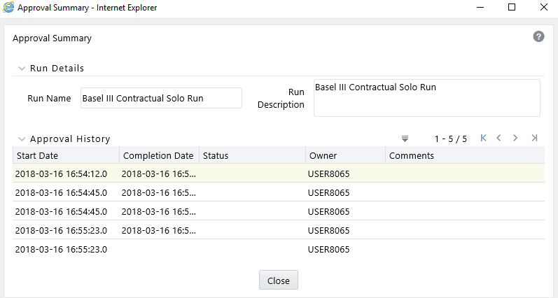

Workflow Summary |
The icon displays the approval summary for the definition. |

The Run Management window allows you to define a new Run or create a new Run definition.
Figure 42 Run Definition - Contractual Run
To define a Contractual Run, follow these steps:
1. Click Add
on the Run Management
window.
The Run Definition window is displayed where you can define a Run.
2. In Linked To section, follow these steps:
a. Select the Folder from the drop-down list, which is specific to the Run definition. The Run definitions are linked to a segment.
b. Select Access Type. It is either Read/Write or Read Only option
3. In Run Definition Details section, follow these steps:
a. Enter the Run Name which is unique across infodoms.
b. Enter the Run Description.
NOTE:
Both the Run Name and Run Description fields allow special characters.
4. In Run Parameters section, follow these steps:
a. Select the Purpose from the drop-down list. The drop-down list displays the following:
— Basel III Liquidity Ratios Calculation
— EBA Delegated Act Liquidity Ratio Calculation
— FR 2052a Report Generation
— FR 2052b Report Generation
— Intra-Day Metrics Calculation
— Long Term Gap Calculation
— RBI Basel III Liquidity Ratio Calculation
— RBI Short-Term Dynamic Liquidity Report Generation
— RBI Structural Liquidity Report Generation
— Regulation YY Liquidity Risk Calculation
— U.S Fed Liquidity Ratio Calculation
— BOT Liquidity Ratio Calculation
— BNM Liquidity Ratio Calculation
— MAS Liquidity Ratio Calculation
— Minimum Liquid Asset Calculation
— HKMA Liquidity Ratios for Category 1 Institutions
— HKMA Liquidity Ratios for Category 2 Institutions
NOTE:
Run purposes for the SKUs licensed only, will be displayed.
b. Select the Run Type as Contractual from the drop-down list. The drop-down list displays the following:
— Contractual
— Business-as-Usual
NOTE:
If the Purpose is selected as Intra-Day Metrics Calculation, Run Type is selected as Contractual by default.
5. When the Run type is selected as Contractual and the purpose is selected as Basel III Liquidity Ratios Calculation or Long Term Gap Calculation follow these steps:
a. In the Time Bucket Definition field, click
to select the time bucket definition. The Time
defined as part of the Time Bucket screen. Select the required time bucket
definition and then click OK.
b. In the Time Bucket Definition Based On field, select either Calendar Days or Business Days.
c. Select Consolidation Type from the drop-down list. It is either Consolidated or Solo.
If you have selected Consolidation Type as Consolidated,
in the Consolidation Level field, click
to
Select a legal entity, at which the consolidated liquidity risk measures
This selection is applicable only when the Run Type is selected as Contractual Run and Consolidation Type is selected as Consolidated. If you have selected the Consolidation Type as Solo, then the Consolidation Level field is disabled.
d. Select the Business Day Convention from the drop-down list. The drop-down list displays the following:
— Prior
— Conditional Prior
— Following
— Conditional Following
— No Adjustment
This is applicable only when Run Type is selected as Contractual Run.
e. Select the Include Interest Cash Flows as either Yes or No.
NOTE:
· The Approximate Interest field is disabled if you select Include Interest Cash Flows as No.
· Select the Forward Rate Interpolation Method from the drop-down list. It is either Linear or Log Linear. This is applicable only when the Run type is selected as Contractual.

7. When the Run type is selected as Contractual and the purpose is selected as Intra-Day Metrics Calculation, follow these steps:
NOTE:
Only intraday buckets are listed under the list time bucket definitions section.
b. Select the Legal Entity Consolidation Type from the drop-down list. It is either Consolidated or Solo.
c. If you have
selected Legal Entity Consolidation Type as
Consolidated, in the Legal Entity Consolidation Level
field, click
to
This selection is applicable only when the Run Type is selected as Contractual Run and Legal Entity Consolidation Type is selected as Consolidated. If you have selected the Consolidation Type as Solo, then the Legal Entity Consolidation Level field is disabled.
d. Select Payment System Consolidation Type as either Consolidated or Standalone.
By default, Standalone is selected.

9. When the Run type is selected as Contractual and the purpose is selected as EBA Delegated Act Liquidity Ratio Calculation or Regulation YY Liquidity Risk Calculation or U.S Fed Liquidity Ratio Calculation, BOT Liquidity Ratio Calculation, BNM Liquidity Ratio Calculation, MAS Liquidity Ratio Calculation, or Minimum Liquid Asset Calculation follow these steps:
to
select the time bucket definition. The Time Bucket Definition browser
Time Bucket screen. Select the required time bucket definition and then
click OK.
c. Select the Consolidation Type from the drop-down list. It is either Consolidated or Solo.
d. If you have
selected Consolidation Type as Consolidated, in the Consolidation
Level field, click
to
This selection is applicable only when the Run Type is selected as Contractual Run and Consolidation Type is selected as Consolidated. If you have selected the Consolidation Type as Solo, then Consolidation Level field is disabled.
e. Select the Business Day Convention from the drop-down list. The drop-down list displays the following:
— Prior
— Conditional Prior
— Following
— No Adjustment
f. Select the Include Interest Cash Flows as either Yes or No.
NOTE:
g. Select the Forward Rate Interpolation Method from the drop-down list. It is either Linear or Log Linear. This is applicable only when the Run type is selected as Contractual.
h. When the Purpose is selected as U.S Fed Liquidity Ratio Calculation, select Include Forward Date Calculations as either Yes or No. In case you select Yes, the following options are enabled:
i. The Forward Balance Method Mapping Rule displays LRM - Balance Method Reclassification - Forecast selected as default.
ii. The Forward Cash Flow Method Mapping Rule displays LRM - Cash Flow Method Reclassification - Forecast selected by default.
iii. Select the Exclude Holidays as either Yes or No.
iv. Select the Balance Sheet Adjustment as either Yes or No.
v. When you select Balance Sheet Adjustment as Yes, the Balance Sheet Adjustment Method option is enabled. Select one of the following from the drop-down list, Current Profile Based Increase, Current Profile Based Decrease, Cash Adjustment, Manual Adjustment.
vi. The Balance Sheet Adjustment Rule displays LRM - Manual Balance Adjustment - Forecast is selected by default when the Balance Sheet Adjustment Method is selected as Manual Adjustment.
vii. Select the Fixed Interval Forward Date as either Yes or No.
viii. In First Forward Day Interval field, enter a value in terms of days.
ix. In the Forward Date Frequency field, enter a value which is a whole number greater than 0. From the drop-down list choose Days, Months or Weeks.
x. In the Number of Forward Calculations field, enter a value which is a whole number greater than 0.

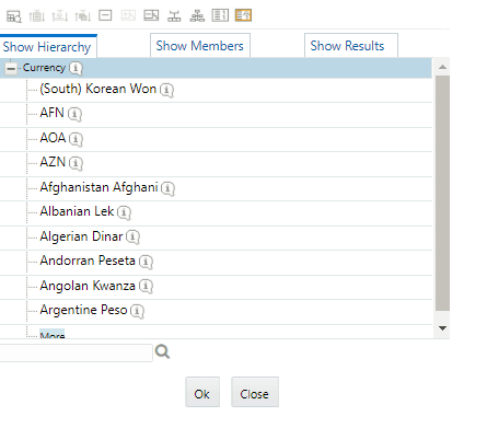

If you have selected consolidation type as Solo, in the Legal Entity Selection section, click
to select one or multiple legal entities from
the Hierarchy browser and then click OK. The
selected legal entities are listed under the Legal Entity Selection section.
If you wish to add or edit the legal entities click
Figure 43 Run Definition - Hierarchy Browser
i. When the Purpose is selected as EBA delegated Act Liquidity Ratio, the field Time Bucket Type is displayed. Select either Actual or Calendar Based.

The Run Definition window in the LRS application allows you to define a new Run.
Figure 44 Run Definition - Business-As-Usual Run
To define a BAU Run, follow these steps:
1. Click the
icon on the Run Management
window. The Run Definition window is displayed
where you can define a BAU Run.
2. In the Linked To section, follow these steps:
NOTE:
4. a. In Run Parameters section, select the Purpose from the drop-down list. The drop-down list displays the following:

5. Select the Run Type as Business-As-Usual from the drop-down list. The drop-down list displays the following:
§ Contractual
§ Business-As-Usual
6. When the Run type is selected as Business-As-Usual and the purpose is selected as Basel III Liquidity Ratios Calculation or Long Term Gap Calculation or RBI Basel III Liquidity Ratio Calculation or Regulation YY Liquidity Risk Calculation or U.S Fed Liquidity Ratio Calculation, BOT Liquidity Ratio Calculation, BNM Liquidity Ratio Calculation, or MAS Liquidity Ratio Calculation, follow these steps:
a. In the Contractual Run field, click
to
select from the list of contractual Runs available in the contractual
Run browser.
b. When the Purpose is selected as Basel III Liquidity Ratios Calculation, RBI Basel III Liquidity Ratio Calculation, BOT Liquidity Ratio Calculation, BNM Liquidity Ratio Calculation, or MAS Liquidity Ratio Calculation the ‘Liquidity Ratio’ field is enabled. This field has three options: LCR, NSFR, Both.
§ When the LCR option is selected, the Run computes the Liquidity Coverage ratio only.
§ When the NSFR option is selected, the Run computes the Net Stable Funding ratio only
§ When Both is selected, the Run computes both ratios that is, Liquidity Coverage Ratio and Net Stable Funding Ratio.
NOTE:
All other fields in the Run parameters section are consistent with the parameters specified as part of the selected Contractual Run. These fields are in un-editable form based on the Contractual Run selected.
For details on how to add a new custom Run Purpose, and enable NSFR, see Adding a Custom Run Purpose.
Select the Assumptions Applied To. It is either Changing Balance/Cash Flows or Original balance/Cash Flows. This field is applicable only when the Run type is selected as BAU.
For information on Changing Balance/Cash Flows or Original balance/Cash Flows, see the Assumption Supported section.
c. When the Purpose is selected as HKMA Liquidity Ratios for Category 2 Institutions the ‘Liquidity Ratio’ field is enabled, with LMR option
7. In the Business Assumptions section, click
. The
Business Assumptions browser is displayed. All the approved business assumptions
with the latest record indicator Y are listed. These have a time bucket
8. Click
to select one or click
to
select multiple business assumptions that you want to apply to the contractual
cash flows and move them to the Selected Members section.
9. Using
up
or down arrows, you can view the sequencing of assumptions.
Figure 45 Run Definition - Business Assumption window
The application saves the assumptions on the BAU Run definition window.
10. If you wish
to add or edit the business assumptions click
. If
you do not wish to save the assumption, click Close.
11. The details are displayed under the Business Assumption section for each selected business assumption as follows:

A stress Run is created in the Stress Definition window of the Stress Testing module of Oracle Financial Services Advanced Analytical Applications Infrastructure (OFSAAAI). A business-as-usual Run or Contractual Run is selected as the baseline Run and one or multiple BAU assumptions that are part of the selected baseline Run can be replaced or inserted by stress business assumptions to create a stress Run.
Each stress definition created in the Stress Testing module of OFSAAAI appears as a line item in the Run Management Summary window with the Run type as Stress. You can view, approve, and execute a stress Run from the Run Management screen of the LRM application.
There are two ways of defining a Stress Run:
· Contractual Run: When the purpose is selected as Intra-Day Metrics Calculation.
· BAU Run: For all the purposes other than Intra-Day Metrics Calculation which is Basel III Liquidity Ratios Calculation, FR 2052a Report Generation, FR 2052b Report Generation and U.S Fed Liquidity Ratio Calculation, EBA Delegated Act Liquidity Ratio Calculation, RBI Basel III Liquidity Ratio Calculation, BOT Liquidity Ratio Calculation.

2. Click
to select a definition with the status Draft,
Open from the list of business assumptions and then click
Figure 46 Run Management Summary - Draft Status
Figure 47 Run Management Summary - Open Status

To approve a Run definition, follow these steps:
1. Click Run Management on the LHS menu of the LRS application to open the Run Management Summary window. Only definitions that are in Pending Approval status can be approved or rejected by the approver.
2. Click
to select a definition with the status Pending
Approval from the list of Run definitions and then click
3. To view the definition in the approval summary window, click Approval Summary. You can view the status changes for the definition created.
Figure 48 Run Management Summary - Pending Approval
You cannot edit the values in the view window.

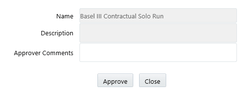

4. To approve the definition that is sent for authorization, click Approve.
The Approve dialog box is displayed with the assumption name and description.
Figure 49 Run Definition - Approve
5. Enter Approver Comments and then click Approve.

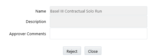

6. To reject the definition that is sent for authorization, click Reject.
The Reject dialog box is displayed with the assumption name and description.
Figure 50 Run Definition - Reject
7. Enter Approver Comments and then click Reject.
8. Click
to
view the summary of the entire approval workflow. It displays approval
history showing the start date, completion date, status owner, and comments
if any.
Figure 51 Run Management - Approval Summary

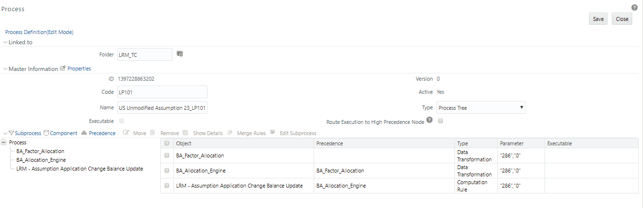

To add a task to a Run, follow these steps:
1. On the Oracle Financial Services Analytical Applications Infrastructure home screen, select Liquidity Risk Management select Manage LRM Rules then select Run on the LHS menu.
NOTE:
For Deposit Insurance Calculation, navigate to Liquidity Risk Management select Manage DIC Rules then select Run on the LHS menu.
On the RHS menu, you can view all the processes which are used and the tasks in the process. You can decide which process needs an additional custom task.
Figure 53: Processes Used

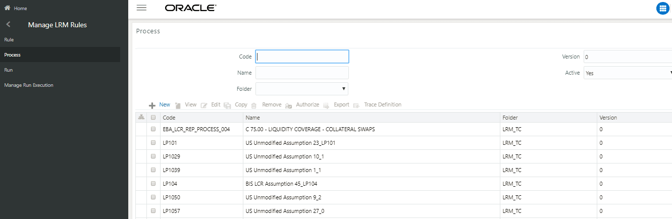

2. Select Manage LRM Rules and then select Process on the LHS menu.
Figure 54: Process Selection
3. Select
the process you wish to edit and then click Edit
The Process window is displayed.
Figure 55: Process Window
4. In the Process window, you can add a Custom Task. For more information on how to add a task to the process, see the Edit Process Definition section in the OFSAAI User Guide.
5. Click Save. You must save it to the existing version.

In the Run Management Summary
window, select a Run from the list of Runs and click
The Run Execution Parameters window appears.
The Run Execution Parameters window has the following sections:
This field displays the information about Linked To, which is selected as part of Run definition window. The details are displayed as follows:
· Folder: The folder which is specific to the Run definition.
· Access Type: Read/Write or Read-Only is selected.
This section displays the details which have already been specified for the selected Run as part of Run Definition window. These details may not be edited. The details are displayed as follows:
· Run Name: Displays the Run name.
· Run Description: Displays the Run description.
This section displays the parameters which have already been specified for the selected Run as part of Run Definition window. These parameters are not allowed to be edited. The parameters displayed include the following:
· Purpose
· Run Type
· Contractual Run (only in case of a Business-as-Usual Run)
· Baseline Run (only in case of Stress Run)
· Time Bucket Definition
· Consolidation Type
· Legal Entity Consolidation Legal Entity Consolidation Level Payment System Consolidation Type (only when the purpose is selected as Intraday Metrics Calculation)
· Business Day Convention
· Include Interest Cash Flows
· Approximate Interest
· Assumptions Applied To (only in case of Business-as-Usual and Stress Run)
This section displays the Legal Entity Selection which is selected as part of Run definition window.
The Run execution parameters must be specified for the selected Run.
Topics:
· Contractual Run Execution ID
This is a selection of a date from the calendar. The As of Date is with reference to the date of the input data required for computations. This is different from the execution date. The data available in the staging area which has a date corresponding to the As of Date is used for computations.
This field allows you to provide a brief description of the Run execution. It is optional.
When the Run type is selected as Business-As-Usual or Stress Run, execution ID of the underlying contractual Run is required to be selected from the Contractual Run Execution ID browser in the Run Execution Parameters window. Business assumptions, both BAU, and stress, are applied to the cash flows aggregated as part of the selected contractual Run execution, and further computations are carried out based on these aggregated cash flows and other interim metrics.
When the Run type is selected as Contractual, Reporting Currency is allowed for selection from the browser in the Run Execution Parameters window.
When the Run type is selected as Business-As-Usual, this field displays the reporting currency selected as part of the Contractual Run execution.
When the Run type is selected as Stress Run, this field displays the reporting currency selected as part of the Contractual Run execution.
For the first execution of a run, you must select the reporting currency. For subsequent executions, the previously executed reporting currency is automatically displayed but can be edited for each execution.

1. Click Run Management on the LHS menu of the application to open the Run Management Summary window.
2. Click
to select a contractual Run from the list of Runs
and click
Figure 57 Run Management Summary
NOTE:
All fields except for Run execution parameters are non-editable fields for the selected Run.
Figure 58 Run Execution Parameters

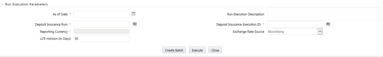

3. When the Run type is selected as Contractual and the purpose is selected as Basel III Liquidity Ratios Calculation or Long Term Gap Calculation or U.S Fed Liquidity Ratio Calculation, EBA Delegated Act Liquidity Ratio Calculation, RBI Basel III Liquidity Ratio Calculation, BOT Liquidity Ratio Calculation, BNM Liquidity Ratio Calculation, MAS Liquidity Ratio Calculation in the Run Execution Parameters section, follow these steps:
a. The Back Dated Run toggle field allows you to select toggle On or toggle Off only when the Purpose is selected as EBA Delegated Act Liquidity Ratio Calculation, RBI Basel III Liquidity Ratio Calculation, Deposit Insurance Calculation (available only for FDIC) and U.S Fed Liquidity Ratio Calculation. For U.S Fed Liquidity Ratio Calculation run, the Back Dated RunToggle field is enabled or disabled based on the selected Deposit Insurance Calculation Run. For example, if the selected Deposit Insurance Calculation Run is Back Dated, then the respective US FED LCR run will be considered for backdated execution (the Back Dated Run toggle field is disabled for user selection).
b. Click
to select the As of Date.
c. Enter the Run Execution Description.
d. Enter details in the fields Deposit Insurance Run and Deposit Insurance Execution ID. This is applicable only if selected run purpose is U.S Fed Liquidity Ratio Calculation, BNM Liquidity Ratio Calculation, or MAS Liquidity Ratio Calculation.
e. Click
to
select the Reporting Currency from the Hierarchy
window and then click OK. Only a single selection
is allowed here.
Figure 59 Run Definition - Hierarchy Browser
f. Select the Exchange Rate Source from the drop-down list.
g. Enter the LCR Horizon (in days). The default value is 30. This applies only when the purpose is selected as Basel III Liquidity Ratios Calculation or U.S Fed Liquidity Ratio Calculation.

To execute a BAU Run, follow these steps:
1. Click Run Management on the LHS menu of the LRMM application to open the Run Management Summary window.
2. Click
to select a BAU Run from the list of Runs and click
The Run Execution Parameters window appears. Here, the parameters of the Run are displayed in an un-editable form and the execution parameters are allowed to be specified for the selected Run.
Figure 60 Run Definition - Run Execution Parameters

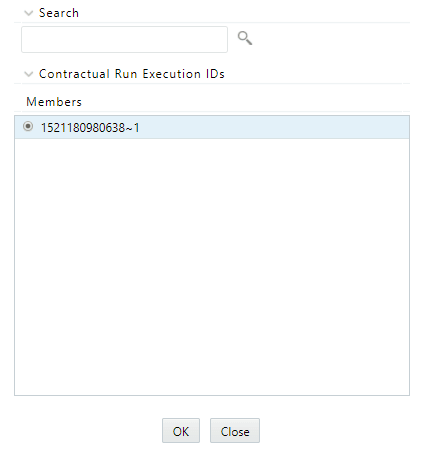

c. Click
to
select the Contractual Run Execution ID from the window and then
click OK. This is the execution ID of the underlying Contractual
Run.
Figure 61 Contractual Run Execution ID Browser

To view the summary of all the Run executions of a particular
Run, click
to
select a Run from the list of Runs in the Run Management Summary
window and click
The Run Execution Summary window is displayed as follows:
Figure 62 Run Execution Summary
1. All the parameters entered as part of the Run Definition window are displayed in an uneditable form.
2. Run Execution Details section displays the Run execution parameters specified for each execution.

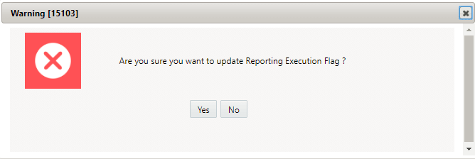

a. You can select
a successful Run Execution ID and click Reporting
Execution Flag
to report it for execution.
A confirmation message appears before updating the Reporting flag.
b. Click Yes. This Run ID is now listed in the List of Reporting Run Execution per As-of-Date section.
c. When you select
a Run execution that has failed, the Reporting Execution Flag
is disabled.
3. List of Reporting Run Execution per As-of-Date section displays the Run execution parameters which are reported for execution.
4. The business assumptions section displays the details of the business assumptions selected as part of each Run. This is applicable only in case of a Business-as-Usual or Stress Run. The details are displayed in a tabular format in the Business assumption section as follows:
a. Assumption Name: This column displays the name of the business assumption selected as part of the Run.
b. Version Number: This column displays the version number of the BAU or stress assumption that was used for computations as part of the selected Run execution. Click the version number to launch the Business Assumption Definition window that displays the specific version of the selected business assumption.
c. Assumption Category: This column displays the assumption category selected as part of the Run.
Additionally, for Stress Run, the following fields are displayed:
a. Stress Assumption Name: This column displays the name of the stress assumption selected as part of the Run.
b. Stress Version Number: This column displays the version number of the BAU or stress assumption that was used for computations as part of the selected Run execution. Click the version number to launch the Business Assumption Definition window that displays the specific version of the selected business assumption.
c. Stress Assumption Category: This column displays the stress assumption category selected as part of the Run.
d. Time Bucket Definition Validation: This column checks and displays if the Time Bucket Definition under Run Parameters section and the Time Bucket Definition under the Business Assumptions section in Run Definition match.
See the Approving a Run Definition section for how to retire a definition and view the approval summary.
