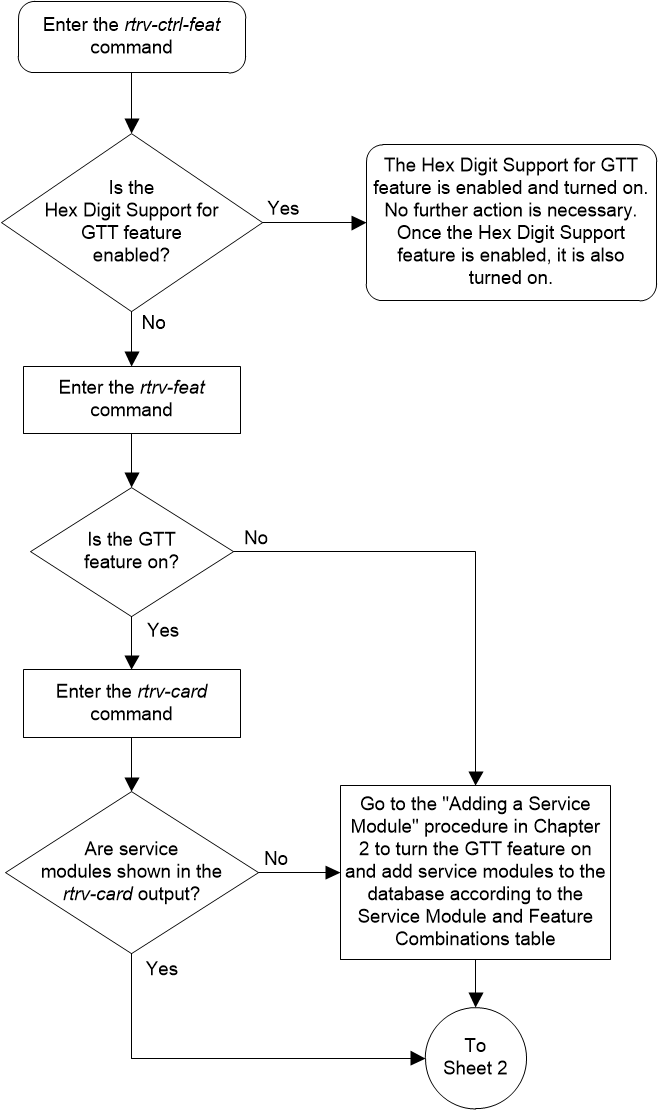

  1. Display the status of the Hex Digit Support for GTT feature by entering the rtrv-ctrl-feat command.
    The following is an example of the possible output.
    rlghncxa03w 06-10-28 21:15:37 GMT EAGLE5 36.0.0
    The following features have been permanently enabled:
    Feature Name              Partnum    Status  Quantity
    Command Class Management  893005801  on      ----
    LNP Short Message Service 893006601  on      ----
    Intermed GTT Load Sharing 893006901  on      ----
    HC-MIM SLK Capacity       893012707  on      64
    The following features have been temporarily enabled:
    Feature Name              Partnum    Status  Quantity     Trial Period Left
    Zero entries found.
    The following features have expired temporary keys:
    Zero entries found.
    If the Hex Digit Support for GTT feature is enabled, the entry Hex Digit Support for GTT is shown in the rtrv-ctrl-feat output. No further action is necessary. This procedure does not need to be performed.
    If the Hex Digit Support for GTT feature is not enabled, continue the procedure with 2.
  2. Verify the GTT feature is on, by entering the rtrv-feat command. If the GTT feature is on, the GTT field should be set to on.
    The rtrv-feat command output contains other fields that are not used by this procedure. If you wish to see all the fields displayed by the rtrv-feat command, see the rtrv-feat command description in Commands User's Guide.
    If the GTT feature is not on, perform Adding a Service Module to turn the GTT feature on and add SMs or SLIC cards to the EAGLE. After the GTT feature is turned on and the SMs or SLIC have been added, continue the procedure with 4.
    If the GTT feature is on, continue the procedure with 3.
  3. Display the cards in the EAGLE using the rtrv-card command. The Hex Digit Support for GTT feature requires that DSMs or SLIC running the VSCCP application are in the database. This is an example of the possible output.

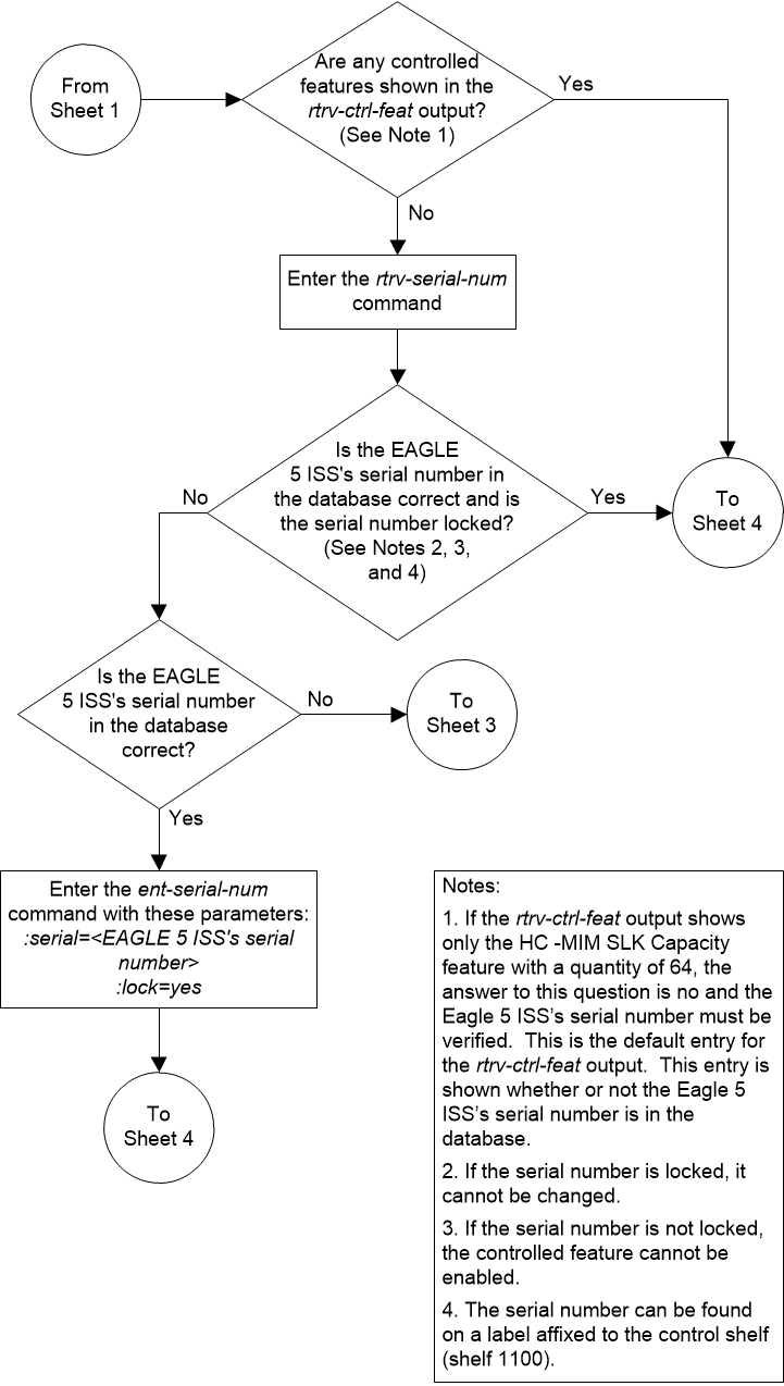

  4. Display the serial number in the database with the rtrv-serial-num command.
    If the rtrv-ctrl-feat output in 1 shows any controlled features, continue the procedure with 8. If the rtrv-ctrl-feat output shows only the HC-MIM SLK Capacity feature with a quantity of 64, 4 through 7 must be performed.
    System serial number = nt00001231
    System serial number is not locked.
    Command Completed.

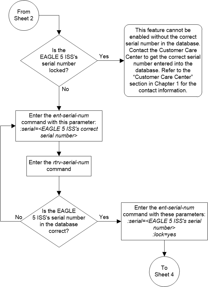

  5. Enter the correct serial number into the database using the ent-serial-num command with the serial parameter.
    If the serial number is correct and locked, continue the procedure with 8. If the serial number is correct but not locked, continue the procedure with 7. If the serial number is not correct, but is locked, this feature cannot be enabled and the remainder of this procedure cannot be performed. Contact My Oracle Support to get an incorrect and locked serial number changed. Refer to My Oracle Support (MOS) for the contact information. The serial number can be found on a label affixed to the control shelf (shelf 1100).
    For this example, enter this command.
    ent-serial-num:serial=<EAGLE’s correct serial number>
    When this command has successfully completed, the following message should appear.
    ENT-SERIAL-NUM:  MASP A - COMPLTD
  6. Verify that the serial number entered in 5 was entered correctly using the rtrv-serial-num command.
    Command Completed.
    If the serial number was not entered correctly, repeat 5 and 6 and re-enter the correct serial number.
  7. Lock the serial number in the database by entering the ent-serial-num command with the serial number shown in 4, if the serial number shown in 4 is correct, or with the serial number shown in 6, if the serial number was changed in 5, and with the lock=yes parameter.
    ent-serial-num:serial=<EAGLE’s serial number>:lock=yes

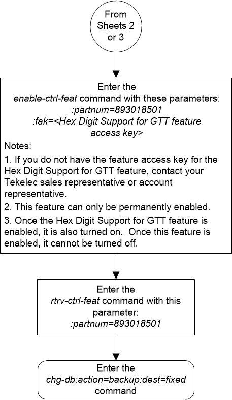

  8. Enable the Hex Digit Support for GTT feature with the enable-ctrl-feat command specifying the part number for the Hex Digit Support for GTT feature. Enter this command.
    enable-ctrl-feat:partnum=893018501
    The Hex Digit Support for GTT feature cannot be enabled with a temporary feature access key.
    When the enable-crtl-feat command has successfully completed, this message should appear.
    ENABLE-CTRL-FEAT: MASP B - COMPLTD
  9. Verify the changes by entering the rtrv-ctrl-feat command with the part number used in 8.
    rtrv-ctrl-feat:partnum=893018501
    Hex Digit Support for GTT 893018501  on      ----
    Zero entries found.
    Zero entries found.
  10. Backup the new changes using the chg-db:action=backup:dest=fixed command.

Figure 5-27 Activate the Hex Digit Support for GTT Feature - Sheet 1 of 4
Figure 5-28 Activate the Hex Digit Support for GTT Feature - Sheet 2 of 4
Figure 5-29 Activate the Hex Digit Support for GTT Feature - Sheet 3 of 4
Figure 5-30 Activate the Hex Digit Support for GTT Feature - Sheet 4 of 4
