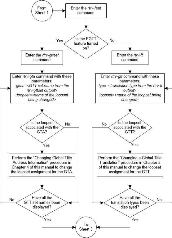

rtrv-gtt
command to verify the
loopset references. Perform the
Changing a Global Title Translation
procedure and change the loopset reference to
NONE
or to another loopset name, or
remove the global title translation by performing the
Removing a Global Title Translation
procedure.
rtrv-gta
Changing Global Title Address Information
NONE
remove the entry by performing the
Removing Global Title Address Information
procedure.

Figure 2-176 Change the Attributes of a Loopset - Sheet 1 of 3

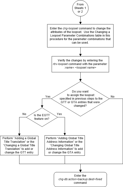

Figure 2-177 Change the Attributes of a Loopset - Sheet 2 of 3

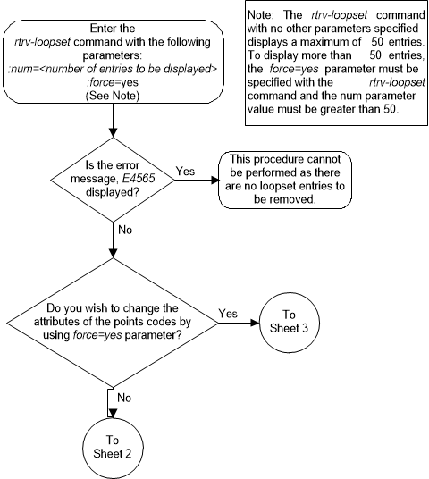

Figure 2-178 Change the Attributes of a Loopset - Sheet 3 of 3
