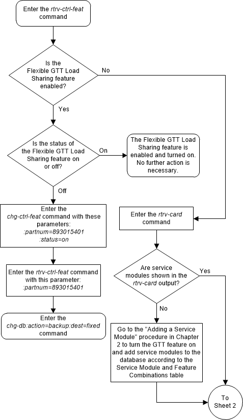

  1. Display the status of the controlled features by entering the rtrv-ctrl-feat command. The following is an example of the possible output.
    rlghncxa03w 06-10-28 21:15:37 GMT EAGLE5 36.0.0
    The following features have been permanently enabled:
    Feature Name              Partnum    Status  Quantity
    Command Class Management  893005801  on      ----
    LNP Short Message Service 893006601  on      ----
    Intermed GTT Load Sharing 893006901  on      ----
    XGTT Table Expansion      893006101  on      400000
    XMAP Table Expansion      893007710  off     ----
    Large System # Links      893005910  on      2000
    Routesets                 893006401  on      6000
    HC-MIM SLK Capacity       893012707  on      64
    The following features have been temporarily enabled:
    Feature Name              Partnum    Status  Quantity     Trial Period Left
    Zero entries found.
    The following features have expired temporary keys:
    Zero entries found.
    If the Flexible GTT Load Sharing feature is enabled and turned on, no further action is necessary. This procedure does not need to be performed.
    If the Flexible GTT Load Sharing feature is enabled and but not turned on, skip steps 2 through 8 and go to step 9.
    If the Flexible GTT Load Sharing feature is not enabled, go to step 2.
  2. Display the cards in the EAGLE 5 using the rtrv-card command.

    If no service modules are shown in the rtrv-card output, perform Adding a Service Module to add DSMs to the EAGLE.
    If DSMs running the VSCCP application are in the EAGLE, go to step 4.

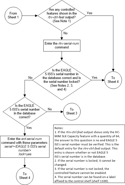

    If the rtrv-ctrl-feat output in step 1 shows any controlled features, skip steps 3 through 6, and go to step 7. If the rtrv-ctrl-feat output shows only the HC-MIM SLK Capacity Feature with a quantity of 64, steps 3 through 6 must be performed.
  3. Display the serial number in the database with the rtrv-serial-num command. This is an example of the possible output.
    System serial number = nt00001231
    System serial number is not locked.
    Command Completed.
    If the serial number is correct and locked, skip steps 4, 5, and 6, and go to step 7. If the serial number is correct but not locked, skip steps 4 and 5, and go to step 6. If the serial number is not correct, but is locked, this feature cannot be enabled and the remainder of this procedure cannot be performed. Contact My Oracle Support to get an incorrect and locked serial number changed. Refer to My Oracle Support (MOS) for the contact information. The serial number can be found on a label affixed to the control shelf (shelf 1100).

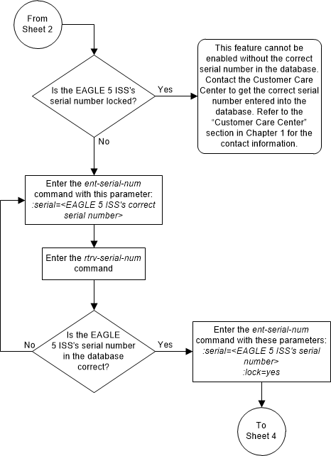

  4. Enter the correct serial number into the database using the ent-serial-num command with the serial parameter.
    For this example, enter this command.
    ent-serial-num:serial=<EAGLE’s correct serial number>
    When this command has successfully completed, the following message should appear.
    ENT-SERIAL-NUM:  MASP A - COMPLTD
  5. Verify that the serial number entered into step 4 was entered correctly using the rtrv-serial-num command. This is an example of the possible output.
    Command Completed.
    If the serial number was not entered correctly, repeat steps 4 and 5 and re-enter the correct serial number.
  6. Lock the serial number in the database by entering the ent-serial-num command with the serial number shown in step 3, if the serial number shown in step 3 is correct, or with the serial number shown in step 5, if the serial number was changed in step 4, and with the lock=yes parameter.
    ent-serial-num:serial=<EAGLE’s serial number>:lock=yes

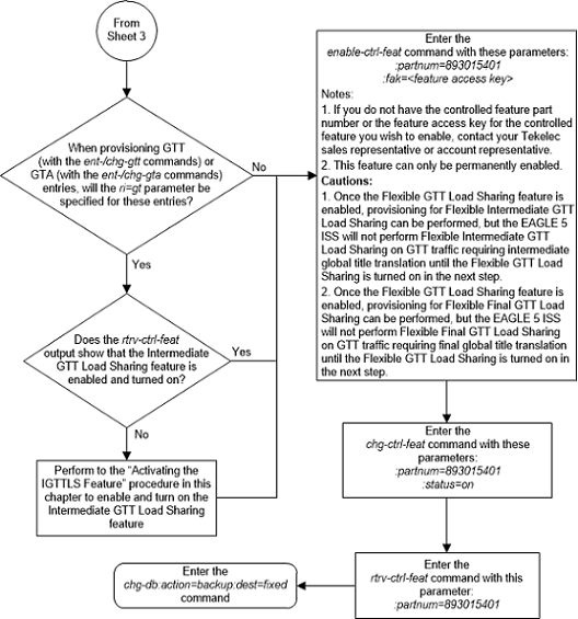

  8. Enable the Flexible GTT Load Sharing feature with the enable-ctrl-feat command specifying the part number for the Flexible GTT Load Sharing feature. Enter this command.
    enable-ctrl-feat:partnum=893015401
    The Flexible GTT Load Sharing feature cannot be enabled with a temporary feature access key.
    When the enable-crtl-feat command has successfully completed, this message should appear.
    ENABLE-CTRL-FEAT: MASP B - COMPLTD
    Caution:
    Once the Flexible GTT Load Sharing feature is enabled, provisioning for Flexible Intermediate GTT Load Sharing, using the ent-mrn, dlt-mrn, chg-mrn, and rtrv-mrn commands, can be performed, but the EAGLE will not perform Flexible Intermediate GTT Load Sharing on GTT traffic requiring intermediate global title translation until the Flexible GTT Load Sharing is turned on in Activating the Flexible GTT Load Sharing Feature .
    Caution:
    Once the Flexible GTT Load Sharing feature is enabled, provisioning for Flexible Final GTT Load Sharing, using the ent-map, dlt-map, chg-map, and rtrv-map commands, can be performed, but the EAGLE will not perform Flexible Final GTT Load Sharing on GTT traffic requiring final global title translation until the Flexible GTT Load Sharing is turned on in Activating the Flexible GTT Load Sharing Feature.
  9. Turn the Flexible GTT Load Sharing feature on with the chg-ctrl-feat command specifying the part number for the Flexible GTT Load Sharing feature and the status=on parameter. Enter this command.
    chg-ctrl-feat:partnum=893015401:status=on
    When the chg-crtl-feat command has successfully completed, this message should appear.
    CHG-CTRL-FEAT: MASP B - COMPLTD
  10. Verify the changes by entering the rtrv-ctrl-featcommand with the Flexible GTT Load Sharing feature part number. Enter this command.
    rtrv-ctrl-feat:partnum=893015401

Figure 5-17 Activate the Flexible GTT Load Sharing Feature - Sheet 1 of 4
Figure 5-18 Activate the Flexible GTT Load Sharing Feature - Sheet 2 of 4
Figure 5-19 Activate the Flexible GTT Load Sharing Feature - Sheet 3 of 4
Figure 5-20 Activate the Flexible GTT Load Sharing Feature - Sheet 4 of 4
