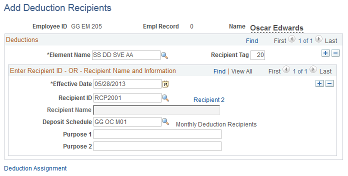

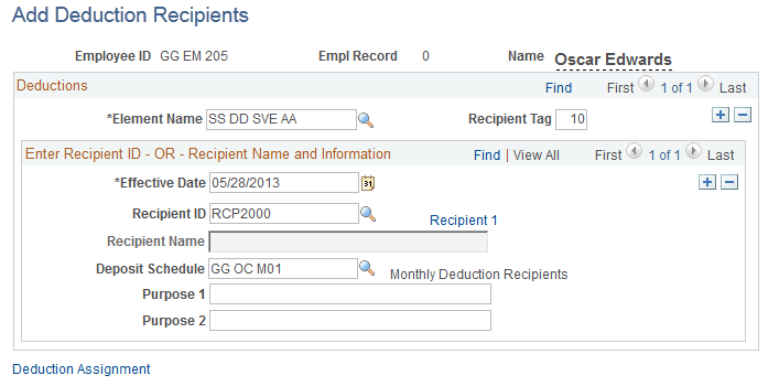

If an employee is enrolled in both the SS00 and SS01 scheme, you add the following rows on the Add Deduction Recipients page:
Deduction |
Recipient Tag |
Recipient ID |
SS DD SVE AA |
10 |
RCP2000 |
SS DD SVE AA |
20 |
RCP2001 |

When you run the banking processes, instance 1 of deduction SS DD SVE AA is associated with the recipient tag 10, which means that the deduction is paid to recipient RCP2000. Similarly, instance 2 is associated with recipient tag 20 and hence recipient RCP2001.
Here is an example showing a payee with two recipients for the deduction SS DD SVE AA:
Image: Add Deduction Recipients page (1 of 2)
This example illustrates the fields and controls on the Add Deduction Recipients page (1 of 2).
Image: Add Deduction Recipients page (2 of 2)
This example illustrates the fields and controls on the Add Deduction Recipients page (2 of 2).
