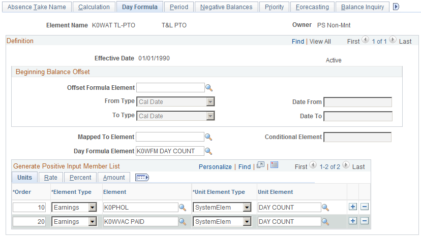

Examples of Absence Takes with Multiple Earnings
Absence Management enables you to define multiple earnings during the set up of an absence take.
For example, the following sample page displays the Absence Take - Day Formula page with two earnings listed in the Generate Positive Input Member List region:
Image: Example: Absence Take - Day Formula page with two earnings
This example illustrates the fields and controls on the Example: Absence Take - Day Formula page with two earnings. You can find definitions for the fields and controls later on this page.
For the following examples, each of the earnings displayed on the Absence Take – Day Formula page is associated with a valid Time Reporting Code.
This table illustrates the relationship between the Absence Earnings Code, the Time Reporting Code, and the Payroll for North America Earnings Code for the example K0WAT TL-PTO absence take element:
