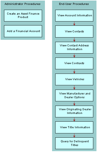

Lease and Loan Accounts Process Workflow
The image illustrates sample tasks that administrators and end users typically perform when managing automotive accounts.
Process of Administering Financial Accounts
To administer financial accounts, perform the following procedures:
