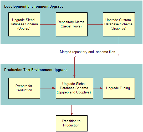

This guide describes how to upgrade three database environments:
Development environment
Production test environment
Production environment
Detailed information on each database environment is provided in the remainder of this topic. For an overview of the steps involved in upgrading each database environment, see the chapter in Siebel Database Upgrade Guide that provides an overview of the upgrade process.

Mapping Your Environments
You might have more or fewer environments than those described About Siebel Upgrade Environments. The following table gives recommendations for mapping your environments to the ones described in this guide.
| Environment Description | Recommended Upgrade |
The environment has the following characteristics:
Development environment upgrade. |
Production test environment upgrade. |
The environment is used for live business transactions by both local and remote users. |
Production environment upgrade. |

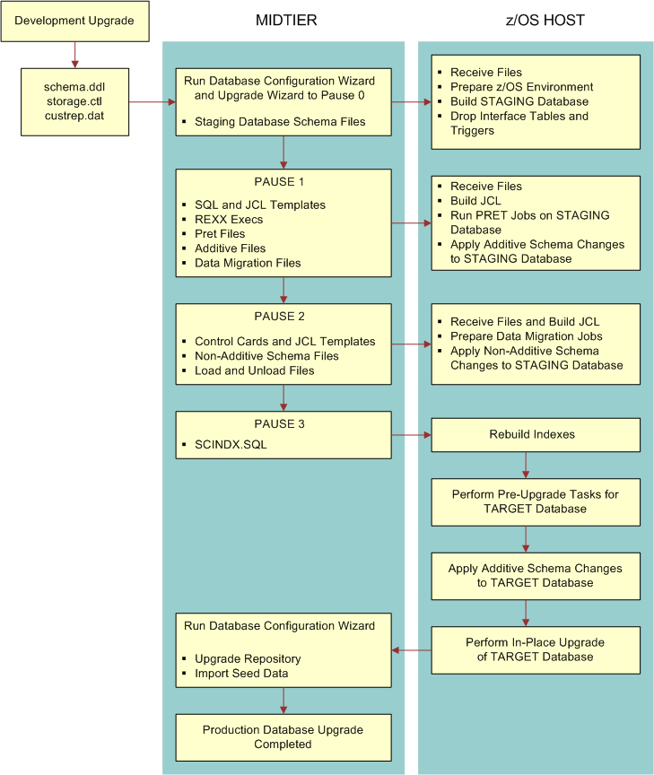

About the z/OS Upgrade
Historically, Siebel production environment upgrades were primarily performed on the z/OS host (mainframe-centric) but you could choose to upgrade your development environment using either a mainframe-centric or midtier-centric process. Since Siebel CRM 8.0, only mainframe-centric development environment upgrades are supported for DB2 for z/OS. In a mainframe-centric upgrade, all upgrade DDL statements (CREATE, DROP, ALTER, and GRANT) and DML (INSERT, UPDATE, DELETE, and SELECT) are executed on the mainframe host.
You initiate a Siebel database upgrade on DB2 for z/OS from a midtier platform (Windows or UNIX) using the Siebel Upgrade Wizard, which automatically generates the DDL and DML files necessary for the upgrade. The Siebel Upgrade Wizard is also run from the midtier to import seed data and the upgraded repository.
You must manually transfer the DDL and the data migration DML files generated on the midtier platform by the Upgrade Wizard to the DB2 host where they are unpacked and applied; this process is guided on the mainframe using REXX execs and ISPF panels. This manual portion of the upgrade, which runs directly on the z/OS host, allows you to tailor the upgrade process to suit your hardware environment and to minimize downtime. The following image shows the In-Place Upgrade Main Menu on the z/OS host.

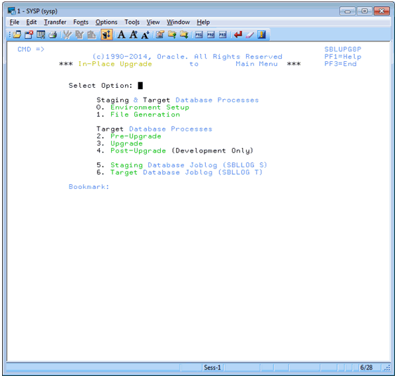

Each ISPF Upgrade panel has a bookmark label and message, indicating the last step completed or currently in progress. These bookmarks guide you through the upgrade process; you cannot rerun jobs that have completed successfully or run jobs out of sequence.

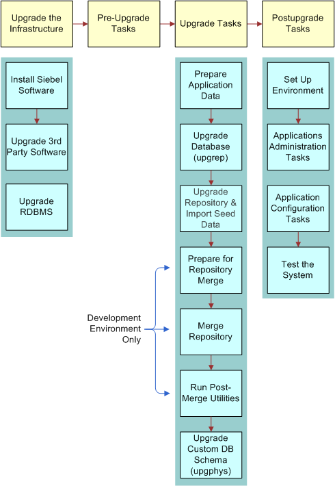

About the Siebel Database Upgrade Process
Upgrades: All upgrades.
Environments: All environments
Upgrading to a new release involves two aspects:
The order in which to upgrade your environments
The flow of the upgrade process within each environment
Environment Upgrade Order
If you have a development environment, you must upgrade it first. During this phase, your customizations are merged with the new Siebel release. A merged repository file and database schema file are created and become inputs to the production test environment upgrade and production upgrade.
If you do not have a development environment or have not customized your repository, no repository merge is required. You can use the repository and schema definition files included in the new release to upgrade your production test environment and production environment.
Flow of the Upgrade Within an Environment
Install Siebel software.
Upgrade 3rd party software.
Upgrade RDBMS.
Perform Upgrade Tasks (Development Environment), Perform Upgrade Tasks (Production Test Environment)Perform Upgrade Tasks (Production Environment)
Prepare application data.
Upgrade database (upgrep)
Upgrade repository and import seed data.
Prepare for repository merge.
Merge repository.
Run post-merge utilities.
Upgrade custom database schema (upgphys)
Set up environment.
Application administration tasks.
Application configuration tasks.
Test the system.
Upgrade the Infrastructure
The first phase is to upgrade your hardware and software to meet system and implementation requirements, which includes upgrading the Siebel Enterprise Server to the new release. This action upgrades the Siebel Servers and provides the programs, scripts, input files, and other files required to merge the repository and upgrade the Siebel database. For information on how to upgrade the infrastructure, see Siebel Installation Guide for the operating system you are using.
Perform Preupgrade Tasks
This phase prepares the Siebel database for upgrade and includes such tasks as closing database connections, clearing pending workflow tasks, disabling customized triggers and editing and validating the storage control file.
This phase merges your customizations into the new release. This phase also upgrades the development environment database and includes these tasks:
Prepare application data. These tasks prepare test data for migration.
Upgrade database (upgrep). Run the Database Configuration Wizard in upgrep mode, selecting the zSeries Staging of Files for Upgrade option. This generates the files required to build the staging database and generate the upgrade files required to perform the in-place upgrade of the database.
Perform the in-place upgrade of the database. During this phase, a basic upgrade of the Siebel database schema is performed and repositories are loaded to prepare for the repository merge.
The upgrep mode makes the following changes:
Drops interface tables and database triggers
Populates columns that must change from NULL to NOT NULL
Creates new tables. Merges existing tables.
Prepares for index creation. Verifies that there are no unique key violations.
Creates indexes
Imports seed data
Imports the Prior Siebel Repository, the New Siebel Repository, and the New Customer Repository
Makes modifications to repository objects to prepare for the repository merge
Updates primary children foreign key references
Performs miscellaneous file actions
Merge repository. You use Siebel Tools to merge your existing repository with the repository in the new release. During the repository merge, objects from the Prior Siebel Repository, the Prior Customer Repository, and the New Siebel Repository are compared to identify the total set of object differences. The process also determines how conflicts between repository changes are resolved as they are merged into the New Customer Repository.
Run postmerge utilities. You use Siebel Tools to run a set of utilities that examine the merged repository. The utilities analyze your customizations to applets and views, and apply changes to them as required to conform to the user interface in the new release.
Upgrade database (upgphys). You run the Database Configuration Wizard in upgphys mode. It further upgrades the Siebel database with changes resulting from the repository merge and completes the database upgrade.
The Database Configuration Wizard also generates the customer repository definition file and logical schema definition file that are used as input to the production test environment and production upgrades.
Specifically, this mode performs the following tasks:
Synchronizes the Siebel database schema to the logical schema definition in the merged repository.
Note: During the synchronization process, custom columns in the Siebel Schema that are not in the Siebel Repository are not removed but custom indexes in the Siebel Schema that are not in the Siebel Repository are removed.Exports repository object definitions to a file, custrep.dat, and exports the logical schema definition to a file, schema.ddl
These two files are used as input to the production upgrades.
Renames the New Customer Repository to Siebel Repository
Updates the schema version in
S_APP_VER
This phase upgrades a production test environment Siebel database to the new release allowing you to test how customizations work with the new release and to tune the upgrade scripts.
This phase includes the following tasks:
Prepare application data. These tasks are about preparing application data for migration.
Prepare for Production Upgrade (Upgrades from 7.5.3 only): Run the Database Configuration Wizard in Prepare for Production Upgrade mode. This mode compares the repository schema and the physical database schema and generates a file, SCINDX.SQL, which is used to remove obsolete indexes. SCINDX.SQL lists indexes present in the physical schema that are not present in the repository schema.
Note: You must define an ODBC connection to the development environment database before performing this upgrade step.Upgrade database (upgrep + upgphys). Run the Database Configuration Wizard in upgrep + upgphys mode, selecting the zSeries Staging of Files for Upgrade option. This generates the files required to build the staging database and generate the upgrade files required to perform the in-place upgrade of the database. The additive and nonadditive schema upgrade files are generated separately.
(Optional) Apply the additive upgrade files to upgrade the database. This is a nondisruptive upgrade process.
Perform the in-place upgrade of the database. The following changes are made during this phase of the upgrade process:
Uses the schema.ddl file from the development environment upgrade to create new tables and merge existing tables.
Creates indexes
Makes several administrative changes to table data, including updating the schema version in S_APP_VER.
Upgrade the repository and import seed data (upgrep + upgphys). Run the Database Configuration Wizard in upgrep + upgphys mode again, selecting the zSeries Seed/Repository Upgrade option to complete upgrade processing. During this step, the upgraded repository and seed data are imported.
Tune upgrade scripts (optional). You can improve the performance of the production environment upgrade by tuning the production upgrade scripts in the test environment.
Run several production upgrades against the test database. This allows you to understand the upgrade process before performing the production upgrade, to conduct performance testing, and to fine tune the upgrade scripts. After carrying out thorough performance testing, you can perform the live production upgrade using the tuned upgrade files.
This phase upgrades a production environment Siebel database to the new release and includes the following tasks:
Prepare Application Data. These tasks involve preparing application data in the production database for migration.
Note: If you have tuned the upgrade scripts during a production test upgrade and want to use them during your production upgrade, you do not have to perform this step. Instead, change the production test environment values in the upgrade files to production environment values and then apply these files on the Z/OS host to upgrade the target database. For further information on this task, see Process of Upgrading a Siebel Production Environment.(Optional) Apply the additive upgrade files to upgrade the database. This is a nondisruptive upgrade process.
Perform the in-place upgrade of the database. The same changes are made during the in-place upgrade of the production environment as were made during the in-place upgrade of the production test environment.
Perform Postupgrade Tasks
This phase is where you set up the environment, configure applications, and test the upgraded system as follows:
Set Up the Environment. These tasks set up the postupgrade environment, which includes extracting the developers’ databases and running database statistics.
Application Administration. These tasks set up applications and include such things as setting up user access and visibility of views and screens.
Application Configuration. These tasks prepare applications for testing, including data migration for specific applications.
Test the Upgraded System. These tasks test the upgraded system. For development environment upgrades, you perform basic unit tests to verify application function followed by a full suite of regression and stress tests to verify the upgraded system is ready for production.

The following image shows how the Database Configuration Wizard (and Upgrade Wizard) work together with the Siebel Tools repository merge to upgrade your environments. The steps shown in the following image are as follows:
Development Environment Upgrade:
Upgrade Siebel database schema (Upgrep)
Repository merge (Siebel Tools)
Upgrade custom database schema (Upgphys)
Merged repository and schema files from development environment are sent to production test environment.
Production Test Environment Upgrade:
Prepare for production
Upgrade Siebel database schema (Upgrep and Upgphys)
Upgrade tuning.
Transition to Production.

Job Flow of a Production Database Upgrade
Environments: Production environment only. Does not apply to production test environment.
This topic describes the major steps in a production database upgrade using the Database Configuration Wizard and Upgrade Wizard. This topic does not describe all the pre and postupgrade tasks you must complete for a production environment. See Process of Upgrading a Siebel Production Environment for a description of all the steps in upgrading a production environment.
The production environment upgrade job flow differs from a development environment upgrade job flow primarily in that a repository merge is not required. The repository (custrep.dat) and the logical schema (schema.ddl) are exported from the upgraded development environment and used in the production upgrade.
A production database upgrade job flow, as illustrated in the following image, is largely the same as the job flow of the upgrep stage of a development database upgrade.
The main steps in the production upgrade illustrated in this image are as follows:
Inputs to the Production Upgrade. The files required for the production upgrade are:
The storage control file (storage.ctl). This file specifies the storage layout of your upgraded database. Create and validate the storage.ctl before running a production upgrade.
The custrep.dat file (new customized repository) and the schema.ddl file (modified schema definition file). These files are generated during the development upgrade and must be copied to the appropriate upgrade directory before running a production upgrade.
Run upgrep + upgphys. Run the Database Configuration Wizard on the midtier:
Enter production environment information to create the production upgrade configuration file. Specify the following values:
Upgrade Option: Upgrade Siebel Database Schema (upgrep + upgphys)
Upgrade Process: zSeries Staging of Files for Upgrade
Launch the Upgrade Wizard to generate the DDL files that will be used to build the staging database.
The Wizard generates the staging database schema files on the midtier and then stops (Pause #0).
Create the Staging Database. Transfer the staging DDL files from the midtier to the z/OS host and apply them. Create the staging database and prepare the z/OS host upgrade environment.
Generate Additive Schema Upgrade Files. Restart the Database Configuration Wizard on the midtier. The wizard generates files and then stops at Pause #1.
Apply Pause #1 Files. The files generated by the Upgrade Wizard on the midtier up to pause #1 consist of JCL and SQL templates and REXX execs that are run on the z/OS host against the staging database. These jobs are used to perform preupgrade tasks for the staging database. Do the following:
FTP the files generated by the Upgrade Wizard from the midtier to the mainframe.
Receive the files, unpack the staging data sets into PDS format, and create JCL members to run the additive schema and PRET jobs against the staging database.
Apply additive schema changes to the staging database.
Run PRET jobs against the staging database.
Generate Nonadditive Schema Upgrade Files. Restart the Database Configuration Wizard on the midtier. The wizard generates files and then stops at Pause #2.
Apply Pause # 2 Files. The files generated by the Upgrade Wizard on the midtier up to pause #2 include nonadditive schema files, load control cards and JCL templates, and unload SQL and JCL templates. Use the files generated up to this point to perform the in-place upgrade of the staging database. Do the following:
FTP the files that have been generated from the midtier to the host.
Modify the load and unload data sets.
Run the unpack jobs to populate PDS members.
Customize the UNLOAD and LOAD jobs for target tables with CLOB columns.
Add jobcards and Siebel logging to the Load, Unload, and data migration jobs.
Apply the nonadditive schema changes to the staging database.
Create temporary tables and indexes for the data migration scripts.
Generate index rebuilds.
Generate the SCINDX Upgrade File. Restart the Database Configuration Wizard on the midtier. The wizard generates files and then stops at Pause #3.
Apply Pause # 3 Files. The SCINDX file generated at this point is used to rebuild indexes. Do the following:
FTP the SCINDX.SQL file from the midtier to the z/OS host.
Apply the SCINDX.SQL file to rebuild indexes.
This completes the file generation process
Perform Pre-Upgrade Tasks for the Target Database as follows:
On the z/OS host, build the JCL templates that will be used to perform the target database in-place upgrade by applying target database information to the JCL templates that were used to run the staging database in-place upgrade processes.
Create and load Siebel log tables.
(Optional) Apply additive schema changes.
Perform the In-Place Upgrade of the Target Database as follows:
Remove interface tables, triggers, and stored procedures from the database.
Run PRET jobs to prepare the target database for table creation during the upgrade.
Apply nonadditive schema changes to the target database.
Create, bind, and test the stored procedures.
Run the Data Migration jobs to migrate preexisting Siebel data to the current release.
There are optional data migration scripts for Household data and for Siebel Financial Services (FINS) applications.
Remove old indexes, create new indexes, and run index rebuild jobs.
Upgrade the Repository and Import Seed Data as follows:
Run the Database Configuration Wizard on the midtier.
Upgrade Process: zSeries Seed / Repository Upgrade
Launch the Upgrade Wizard. The Upgrade Wizard automatically runs the remaining DML upgrade jobs from the midtier to perform a number of tasks, including the following:
Deletes the old license key.
Verifies the repository name and imports the New Customer Repository from the upgraded development environment.
Upgrades seed data to the new version.
The production database upgrade is now completed.
