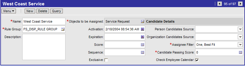

When administrators define a new rule, selecting the Check Employee Calendar box activates the assignment availability criteria.

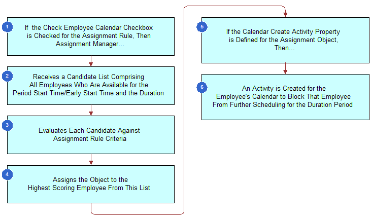

How Siebel Assignment Manager Creates Activities for Employees During Availability-Based Assignment
If an assignment rule has the Check Employee Calendar flag checked, then availability for each employee is evaluated before assignment. If the Calendar Create Activity property is also set for the assignment object, then make sure that an activity exists in the employee's calendar for that duration to block the schedule. The following figure shows a high-level flowchart of this process, which includes the following steps:
  1. If the calendar’s Check Employee check box is selected for the Assignment Rule, then Assignment Manager . . .
  2. Receives a candidate list comprising all employees who are available for the Period Start Time/Early Start Time and the Duration.
  3. Evaluates each candidate against the assignment rule criteria.
  4. Asssigns the object to the highest scoring employee from the list.
  5. If the calendar’s Create Activity property is defined for the assignment object, then . .
  6. An activity is created for the employee’s calendar to block that employee from further scheduling for the Duration Period.
High-Level Flowchart of Availability-Based Assignment: Described in the surrounding text..
Assignment Manager evaluates whether the Check Employee Calendar flag is checked (calendar rules) or not (noncalendar rules) and processes the rules differently based on this indication. If Assignment Manager is assigning activities, and if only one employee passes and that employee is from a calendar rule, then the original activity is reused and the employee is added to the owners list for that activity. This action blocks the employee's schedule. If more than one employee passes, then separate activities are created for each employee. In this case, the parent activity of all these additional activities is set to the original activity to make sure that all are related to each other.
If Assignment Manager is not assigning activities, then separate activities are created for each employee who passes and blocks their schedules.

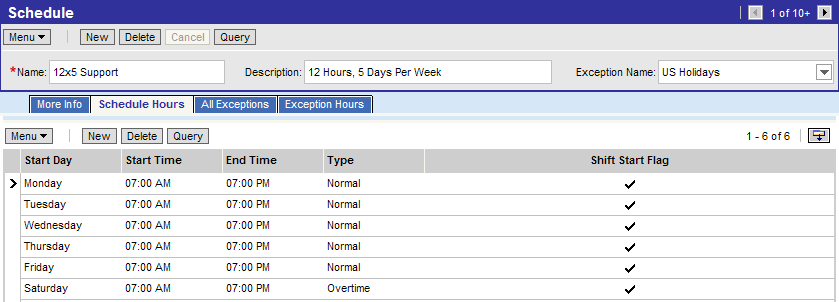

                1. Verify that a schedule exists with valid hours by navigating to the All Schedules view (Administration - Service screen, Schedules view).
                  For this example, select the 12x5 Support schedule in the Schedules List, and click the Schedule Hours view tab. Make sure that the hours listed are valid. The following figure shows this view (the Schedule Hours view tab).
                  The Schedule Hours view tab: In this image, the schedule for Monday to Friday is 7am to 7pm and Type is Normal. For Saturday, the schedule is 7am to 7pm and the Type is Overtime.

                  1. Create the assignment rule by navigating to the Administration - Assignment screen, and then the Assignment Rules List view.
                    1. In the Assignment Rules List, choose Edit, then New Record.
                    2. In the new record, enter the following settings:
                      • Name = West Coast Service
                      • Objects to Be Assigned = Service Request
                      • Assignee Filter = One, Best Fit
                    3. Click the Check Employee Calendar checkbox to enable the rule for availability-based assignment.

                    When a service request is created with attributes that match both West Coast service representatives, Siebel Assignment Manager, through the Appointment Booking System, assigns the employee who has available time in his or her calendar and work schedule. Optionally, the Appointment Booking System can create an activity in the assigned employee's calendar. For more information about the Appointment Booking System, see Siebel Field Service Guide.
                    The following figure shows an example of a field service assignment rule, where:
                    • Rule Group = FS_DISP_RULE GROUP
                    • Candidate Passing Score = 0
                    • The Check Employee Calendar checkbox is activated, thereby enabling the rule for availability-based assignment.
                    A Field Service Assignment Rule with the Check Employee Calendar Field Activated: This image is described in the surrounding text.
