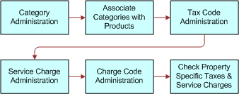

Process of Setting Up Charge Codes, Taxes, and Service Charges
The following list shows the procedures that administrators typically perform to set up charge codes, taxes and service charges using Siebel Hospitality. Your company might follow a different process according to its business requirements.
The following image illustrates the process flow for the tasks administrators typically perform to set up charge codes, taxes, and services charges.
        To set up charge codes, taxes, and services charges, perform the following tasks:
