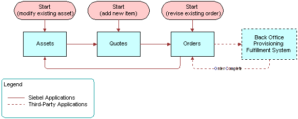

The following figure shows the cycle of events for asset-based ordering.
Asset-Based Order Management Cycle. In this image, there are three Start events: Start (modify existing asset), Start (add new item), and Start (revise existing order). Start (modify existing asset) is connected to Assets by an arrow. Start (add new item) is connected by an arrow to Quotes, Start (revise existing order) is connected by an arrow to Orders. Assets is connected to Quotes by an arrow, Quotes is connected to Orders by arrow. A dotted arrow indicating third party applications goes from Orders to Back Office Provisioning Fulfillment System. A dotted arrow also connects Back Office Provisioning Fulfillment System to Orders. Orders is also connected to Assets by an arrow.
